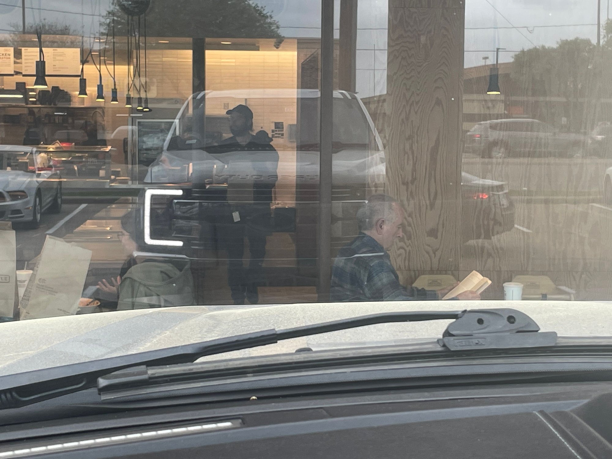

maybe the picture better describes the problem. This is in drive during the day.

That exactly describes the problem. Unless I missed it, it was never made clear that you have factory LED headlights. Hence my confusion and why some of us were thinking of a 4 bulb H13 set up.

That does help, I had no idea you had LED headlights. Also, that's not a 2020 in the photo. The DRL's run at full brightness when actually functioning as a daytime running light , and at a reduced brightness at all other times, like when the headlights are on. I assume they both work when you unlock the doors? For whatever reason that one side doesn't want to work at full bright. Figuring out the reason for that will take someone with a much better understanding of how they work and exactly what part would effect that.
