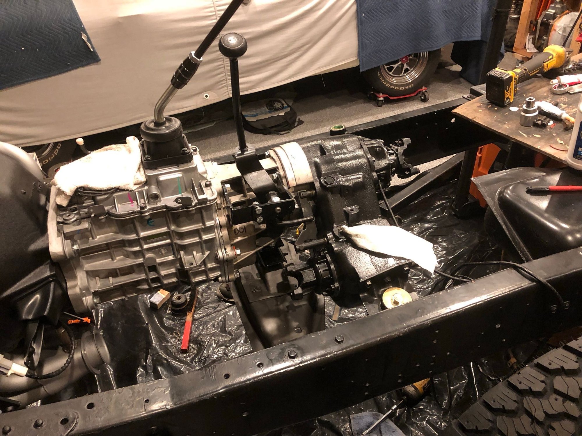

thank you for the insight, it originally had a NP435 4spd and I decided to upgrade to a 5spd so I did some looking around and I ended up buying a brand new Tremec TR4050 5spd and it bolts up to the bell housing and the NP205 transfer case with 2 adapters.

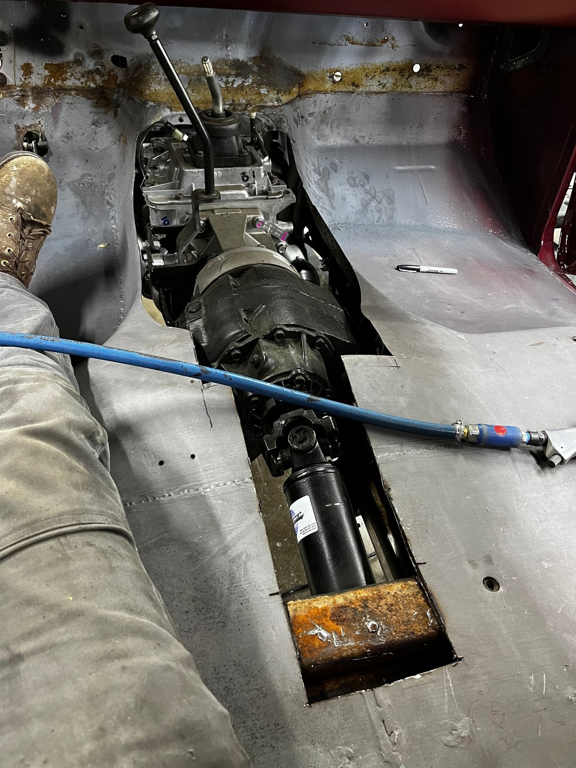

took so modifications of the cab and tranny brace but it fits
here’s some pics
Took this when we set the cab this august and I had to take out a bit more than expected
This is the best picture I could find of the new tranny&transfercase mated together

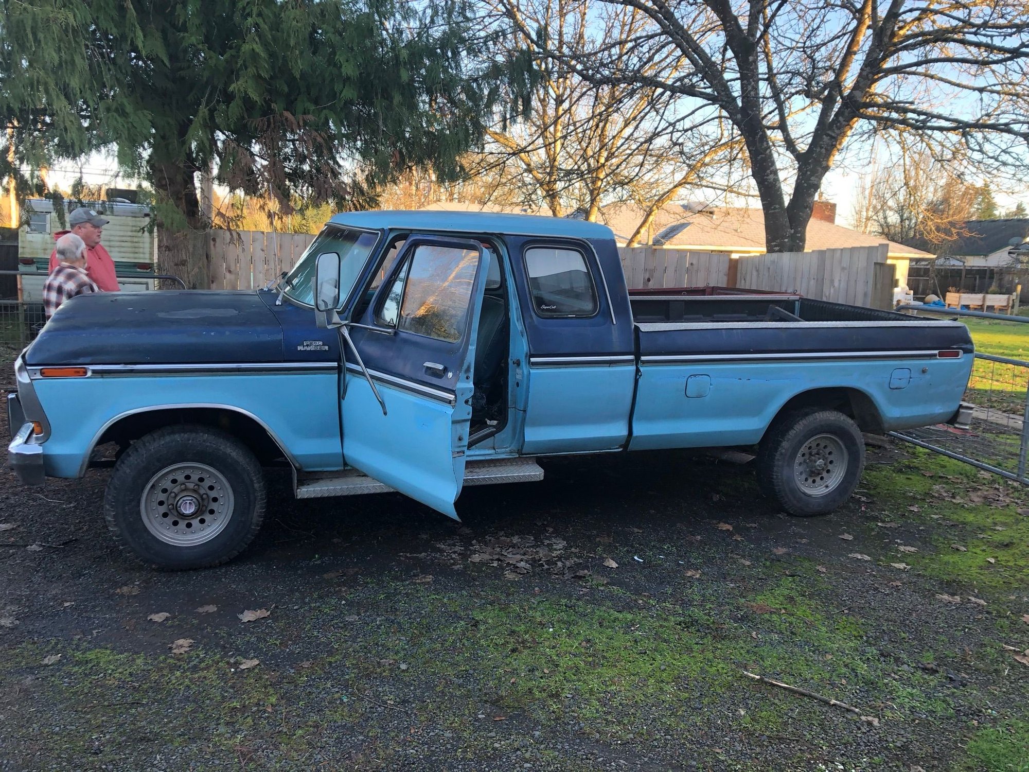

Took this when I bought it December 24th 2020

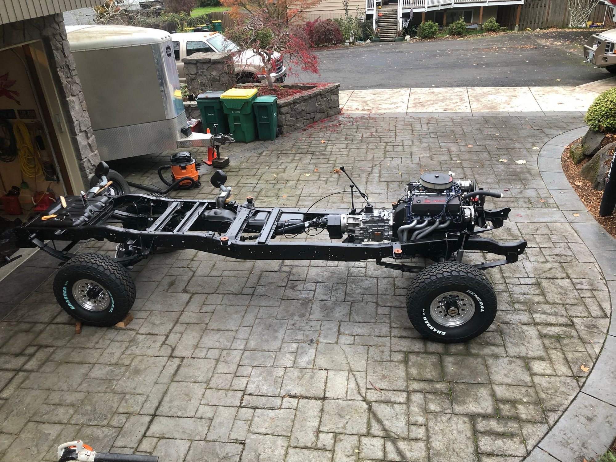

This was mid November 2021 after I finished the drivetrain
