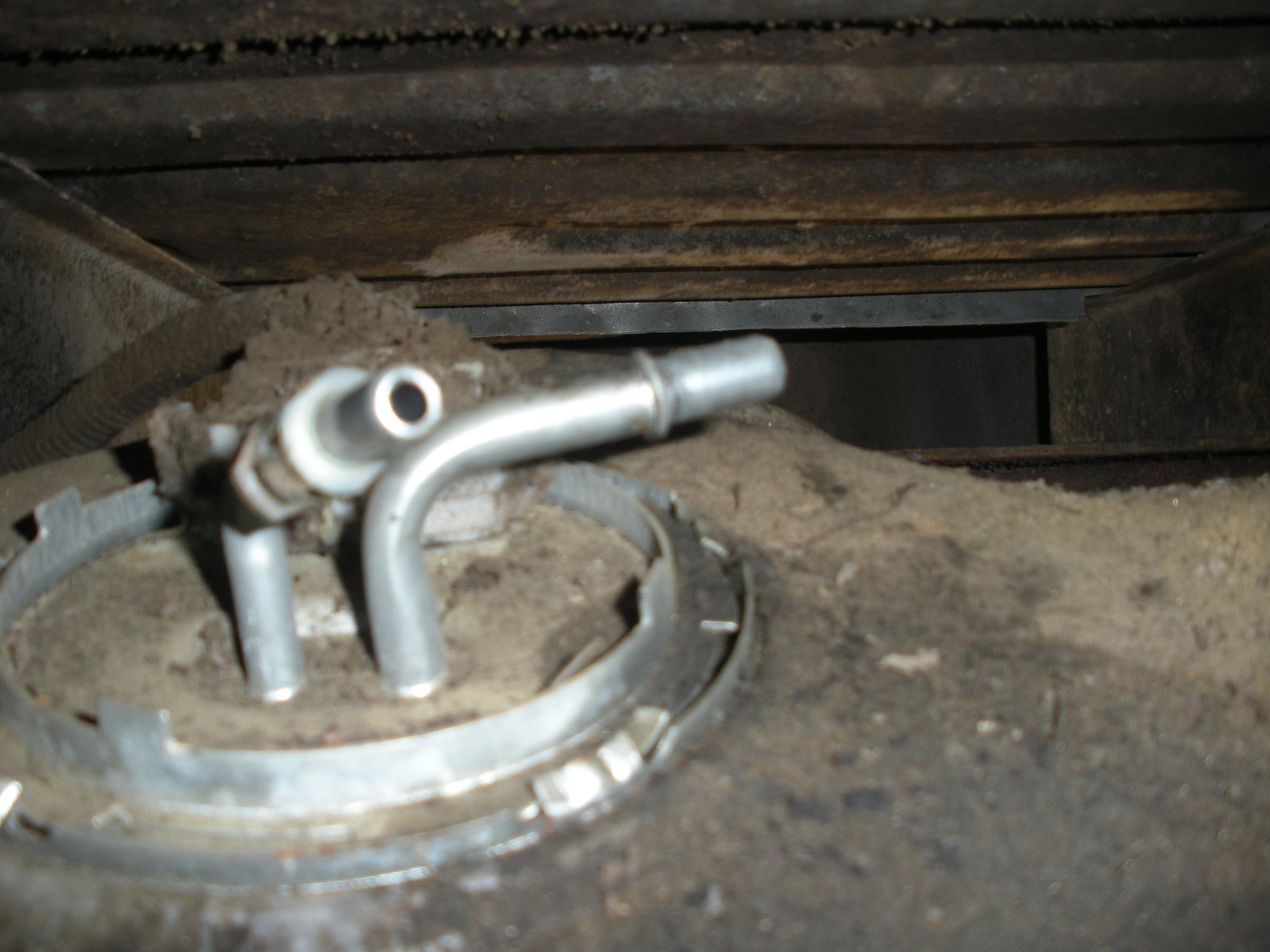

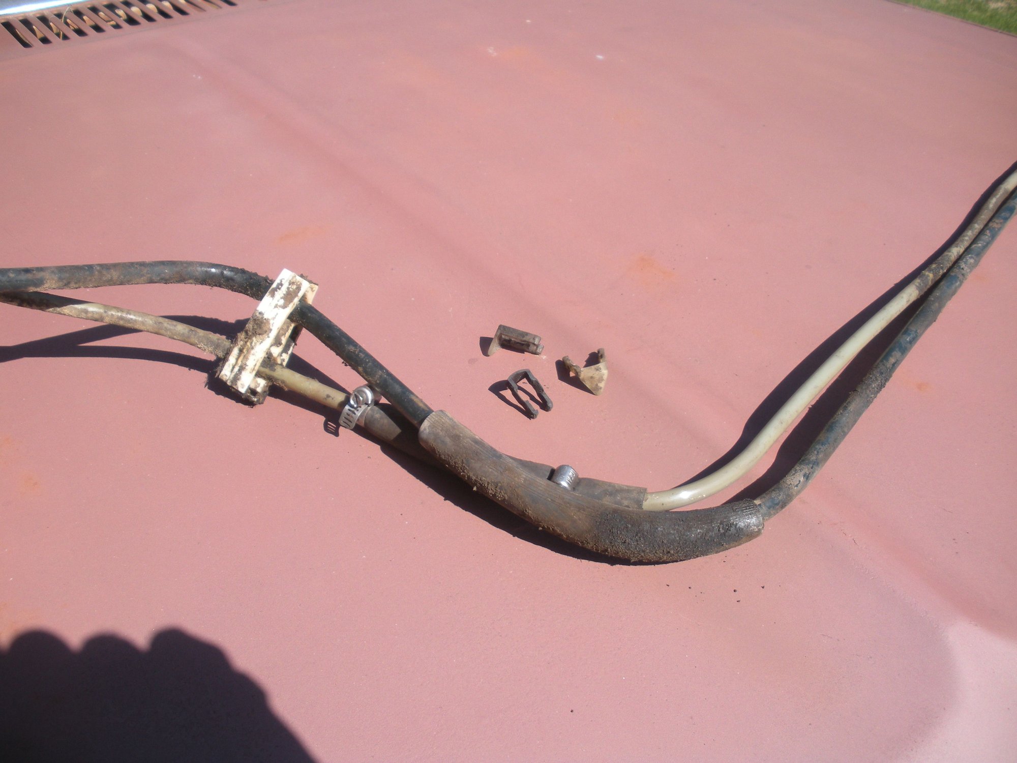

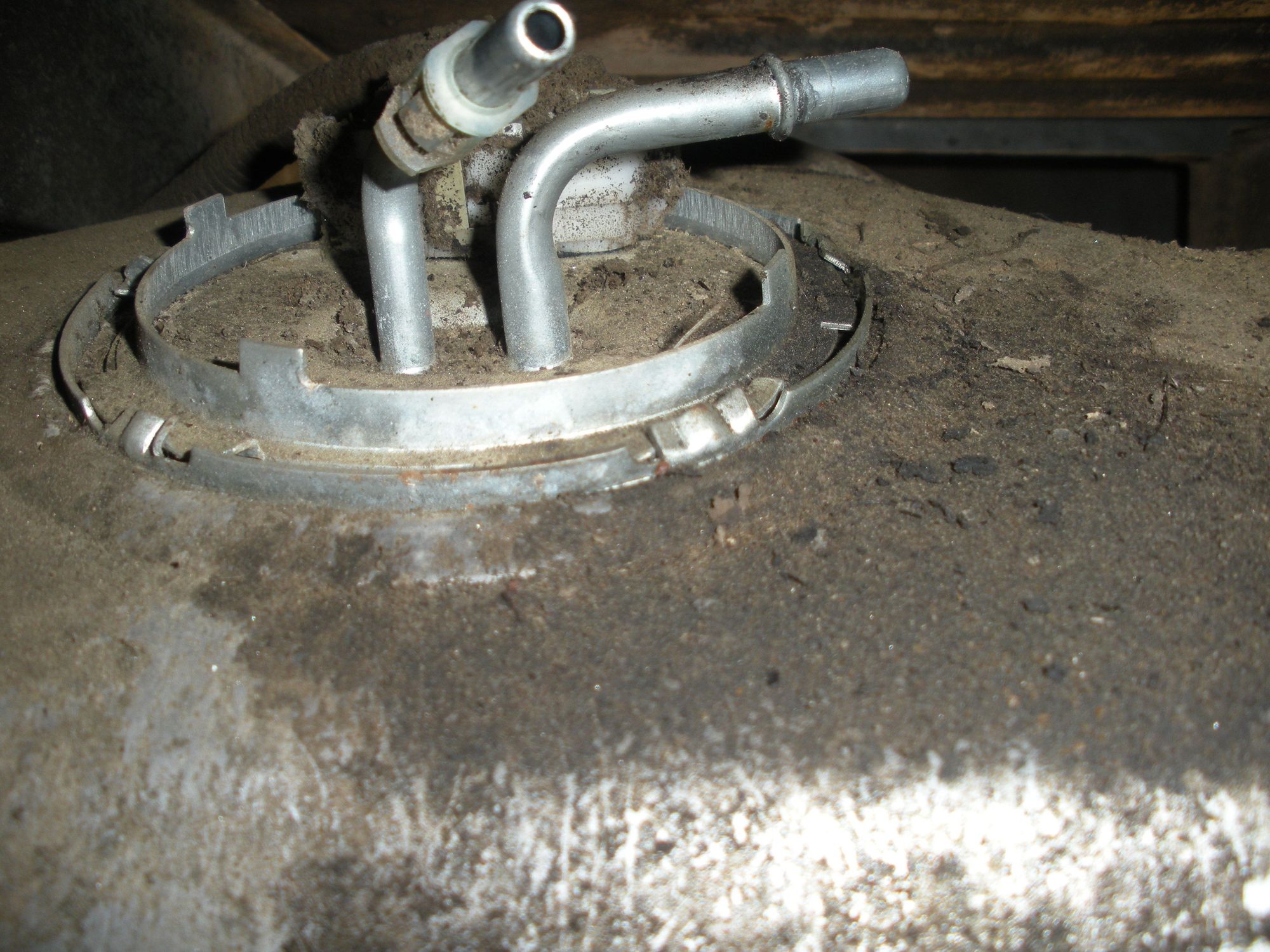

On the back side of that clip is a tab, use a screw driver to pry it up. see the clips here,
The return hose on my 86' has a squeeze clip at the tank... but the supply line was the other style U clip with tab.
