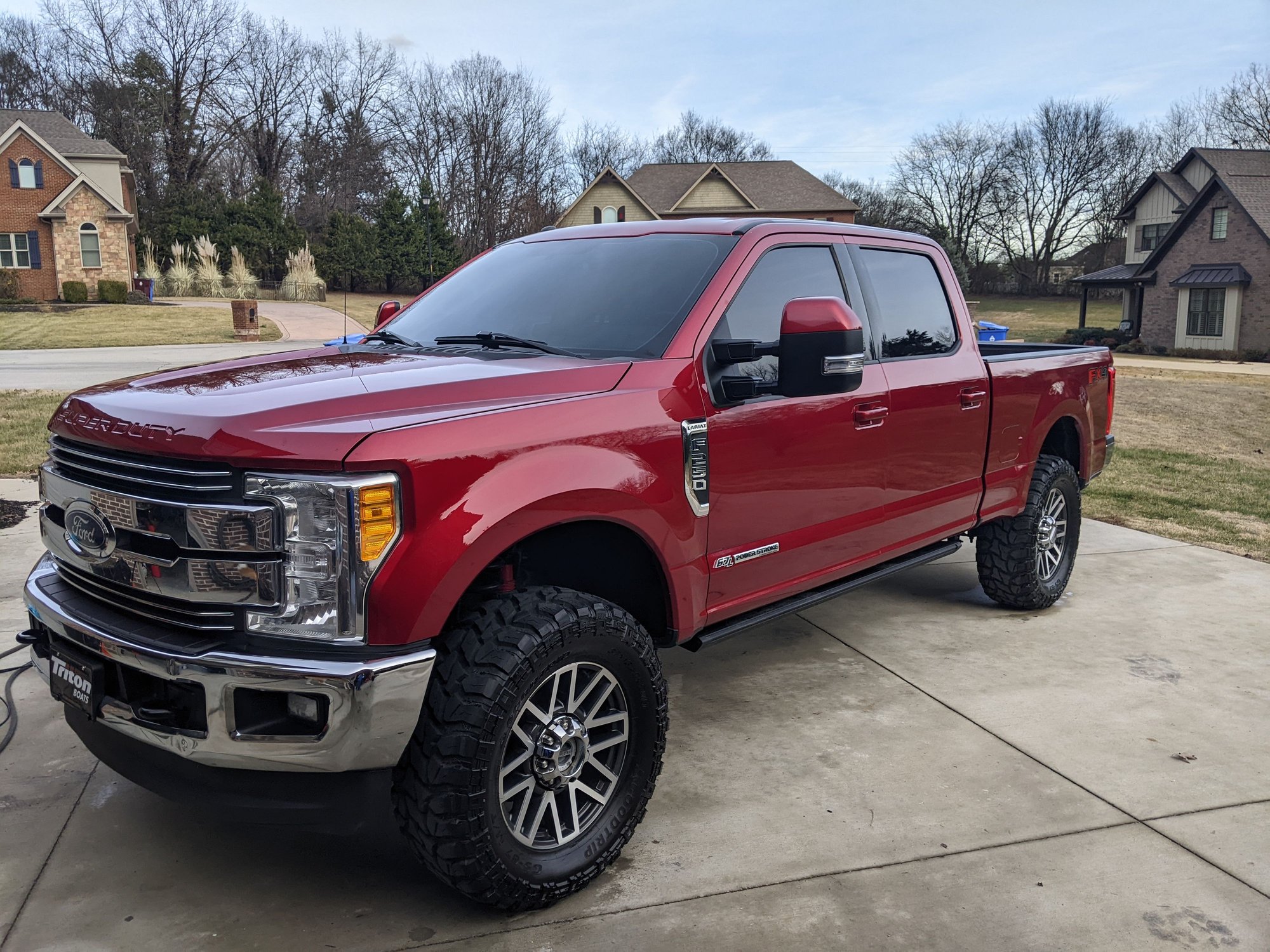

I bought my 2017 F250 leveled with 37x13.50R20's on it already. It only has a cheap spacer from Amazon under the springs.
The truck seems to drive and handle fine and the dealer I bought it from mentioned it was aligned.
I don't believe my axle is centered under the truck. Not sure how it could be without a new track bar or bracket right?
Do most go with a drop bracket for a new track bar? From what I understand the OEM bar works fine.
I'm eye balling the readylift drop bracket.
I do believe I would upgrade to the carli coils at some point.

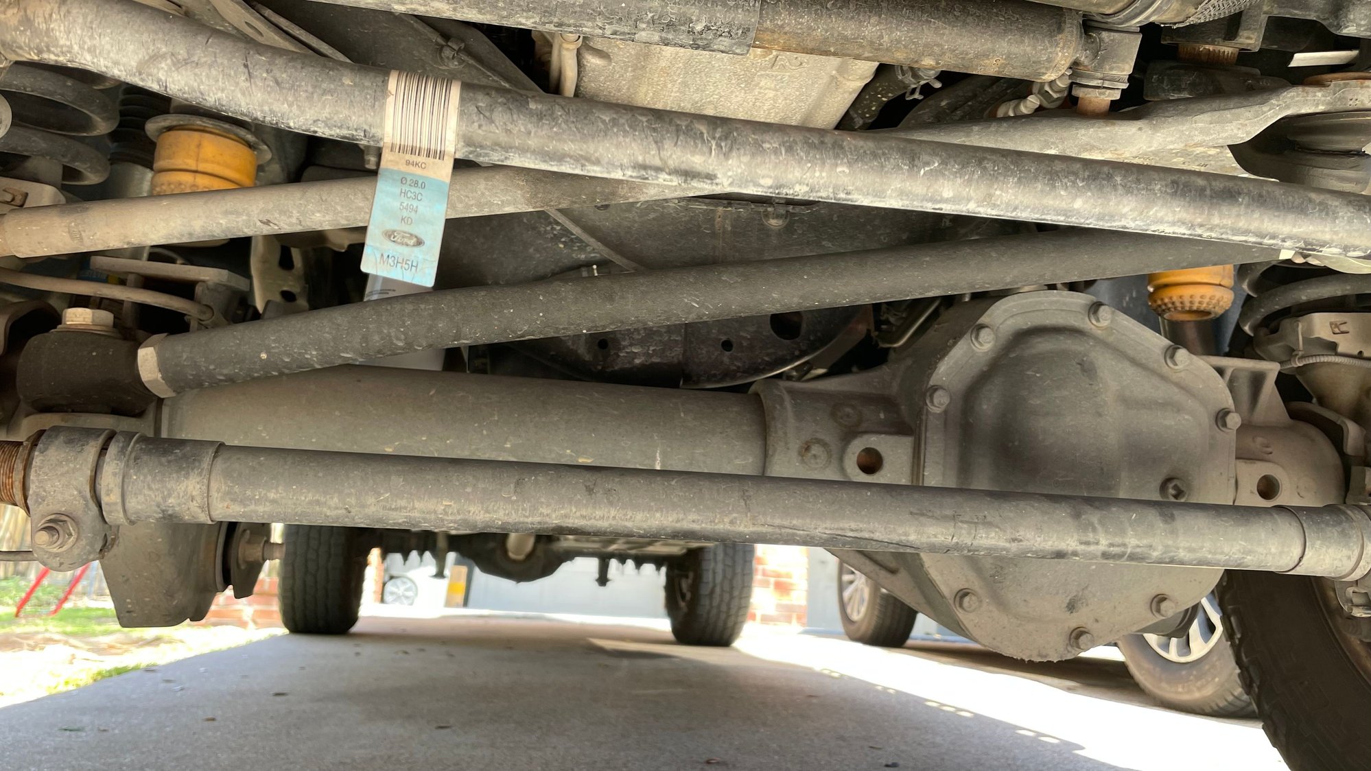

with the factory track bar bracket and the aftermarket track bar, does it keep the track bar and drag link parallel?
I know with my 4” bds kit and the pitman arm and bds track bar bracket they’re parellel (which is important to keep them following the same arc as the front suspension cycles).
I guess on a 2.5 level it might but I was just curious what those angles looked like.

I don’t remember there being any instructions in the box. I centered the axle after installing coils with the full weight of the truck on the suspension & installed it. Alignment shop confirmed that it’s centered when I had it aligned after installing the lift.

DON’T Skimp : go with an ADJUSTABLE Track Bar & use a plumb Bob from each frt fender to center the tires with weight on the axle then center your steering wheel by adjusting drag link. Drive & repeat if needed.
easy pz no alignment needed.
I’ve did dozens of them thru the years.
I went with the PMF adjustable radius arms too to restore the lost negative caster from lifting front end.
These trucks drive & handles better with 4.5 - 5.5* negative caster.
upper ball joint eccentric bushings are the cheesy way out setting caster plus they require a full blown alignment.

It really all depends on how OCD you are. An adjustable trac bar will allow you to perfectly center the axle. A drop bracket will get it close. With manufacturing tolerances being what they are, and depending on how high that level actually lifted it. from where it started..2", 2 1/4" 2 3/4"? the axle might still end up slightly off center. Will that bother you?
