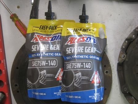

Service the differentials. Replace fluids with either Amsoil or Lucas products.
Run a few extra PSI's in the tires. Wyoming is cold and tires get low pressure.
Take the covers off of the lock out hubs on the front axle and lube everything with grease so they work effortlessly.
Make sure your brakes are releasing properly.
All low cost items.

Originally Posted by Fords and the Lord
Sounds good, thankyou. What do I need to do with the differentials?
________________________
1) Differentials are one of the most neglected item on the power train. Dirty, greasy and you can't "pull codes"... Old school mechanics.
2) On a "vintage" truck they are one of the most expensive components to replace, if you can find parts.
3) Once you get under there you will notice if the seal on the input shaft has been leaking. A good indication the fluid is low.
4) When you pull the cover off to drain the oil you can see if there are very many shavings in the bottom of the housing.
5) The outboard wheel bearing's (on many vehicles) get their lubrication from the oil in the differential. Wheel bearing failure is an indication of low oil level..
6) Having to roll around under the truck forces an inspection of everything else under there. A few examples - U Joints, hanger bearing, emergency brake cable, engine oil leaks, lose wiring, rust on frame, etc,
Call this a "Good Start" inspection.
