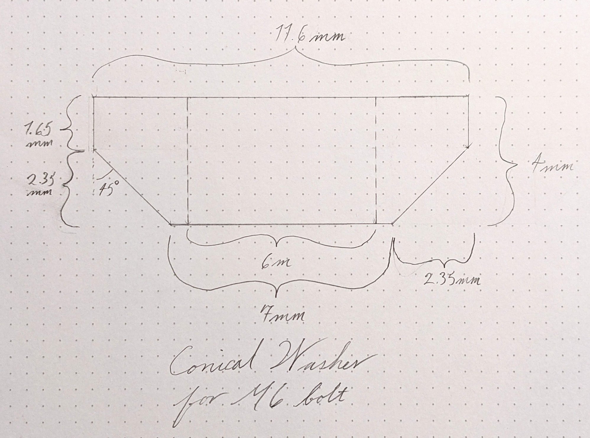

The right way to do this is to take some steel alloy rod, drill a 6.1mm hole in the center, 90 degree chamfer on the end, diameter to 12mm and thickness at 4mm. then you can use 12.9 12pt screws with a flange that will push down on the entirety of the washer, preventing deformation.
If only I had a lathe!
pm me a sketch of what you're thinking...I happen to know a guy with a cnc lathe. 😆

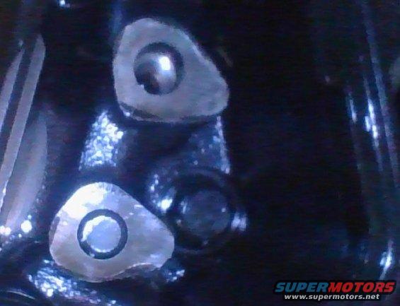

Cant seem to attach images to PMs so will just post it here
It's hard to tell profile on used bolts due to the metal deforming but looking at several closely, and where they fit in the injector collar, I'm 99% they are 90 degree conical.
I've looked through a ton of flanged bolts and the only ones I've found in the right size with the correct flange diameter are ARP. Other flanged bolts have either too small or too large a diameter of flange. The 11.6mm diameter of the washer is the same as the ARP bolt's flange so should be plenty strong.
Easiest way to cut these washers would be to take a long partially threaded 12.9 M12 bolt , part the threaded end and head off, drill hole in center, dimension the diameter, chamfer edge, part off. Then move in, chamfer edge, part off, etc etc.

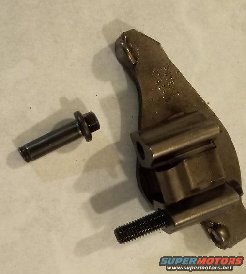

Every shoulder bolt I've examined after tearing apart several heads has been bent. Either over time, from the initial torque or subsequent tightenings. There's a lot of vibration put upon those bolts and it'd be nice to have a solution that won't stretch over time or require re-tightening down the road.

Do you have a material in mind? How many?
I'd probably recommend 4140 in a prehard condition....which makes it about 30 R/C.
That'd probably be fine. Like I said I was thinking that using the unthreaded portion of a M12 bolt would be the economical solution, but 4140 would work too. 16 bolts... I'd say 20 washers would be ideal.
