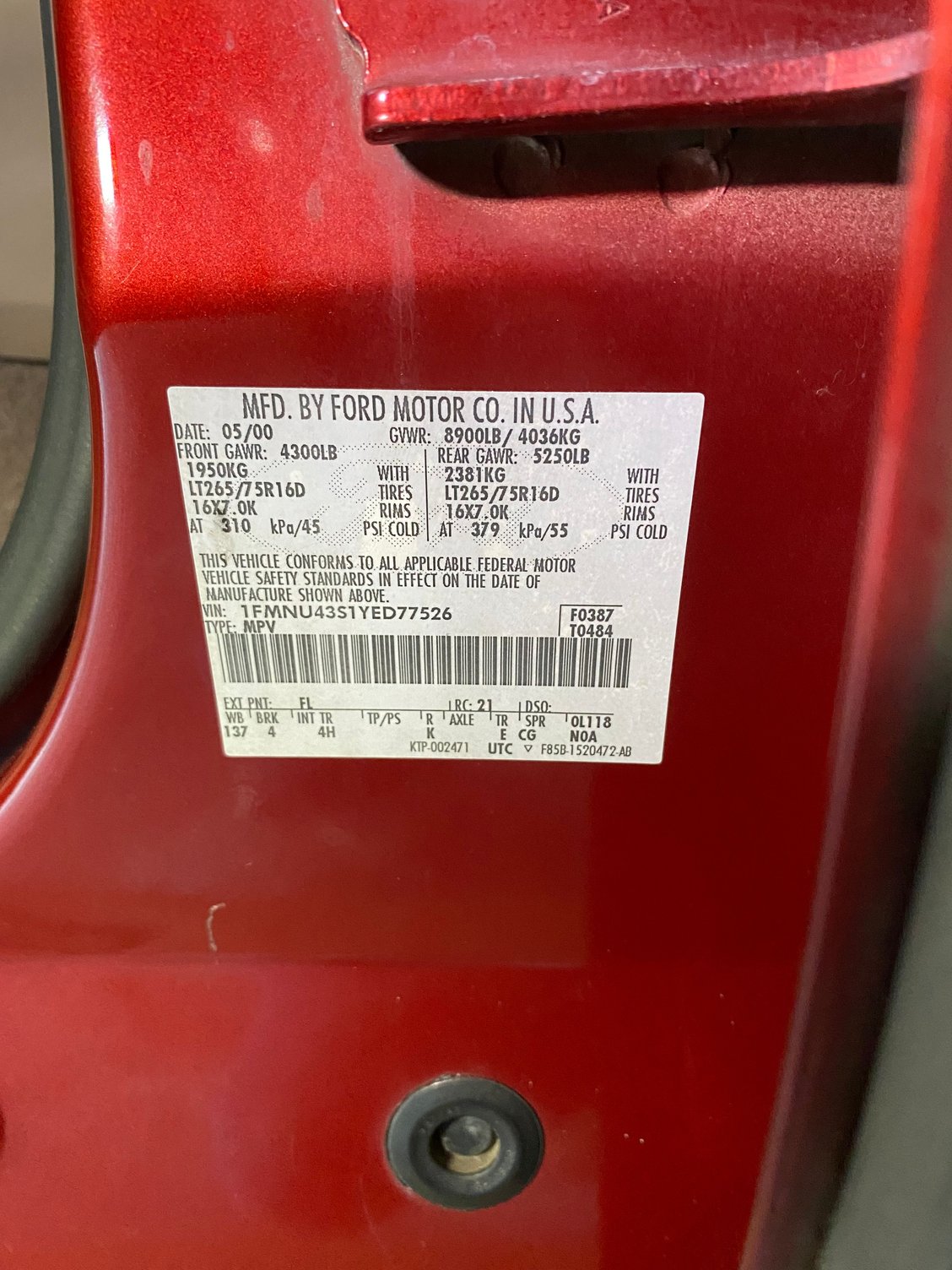

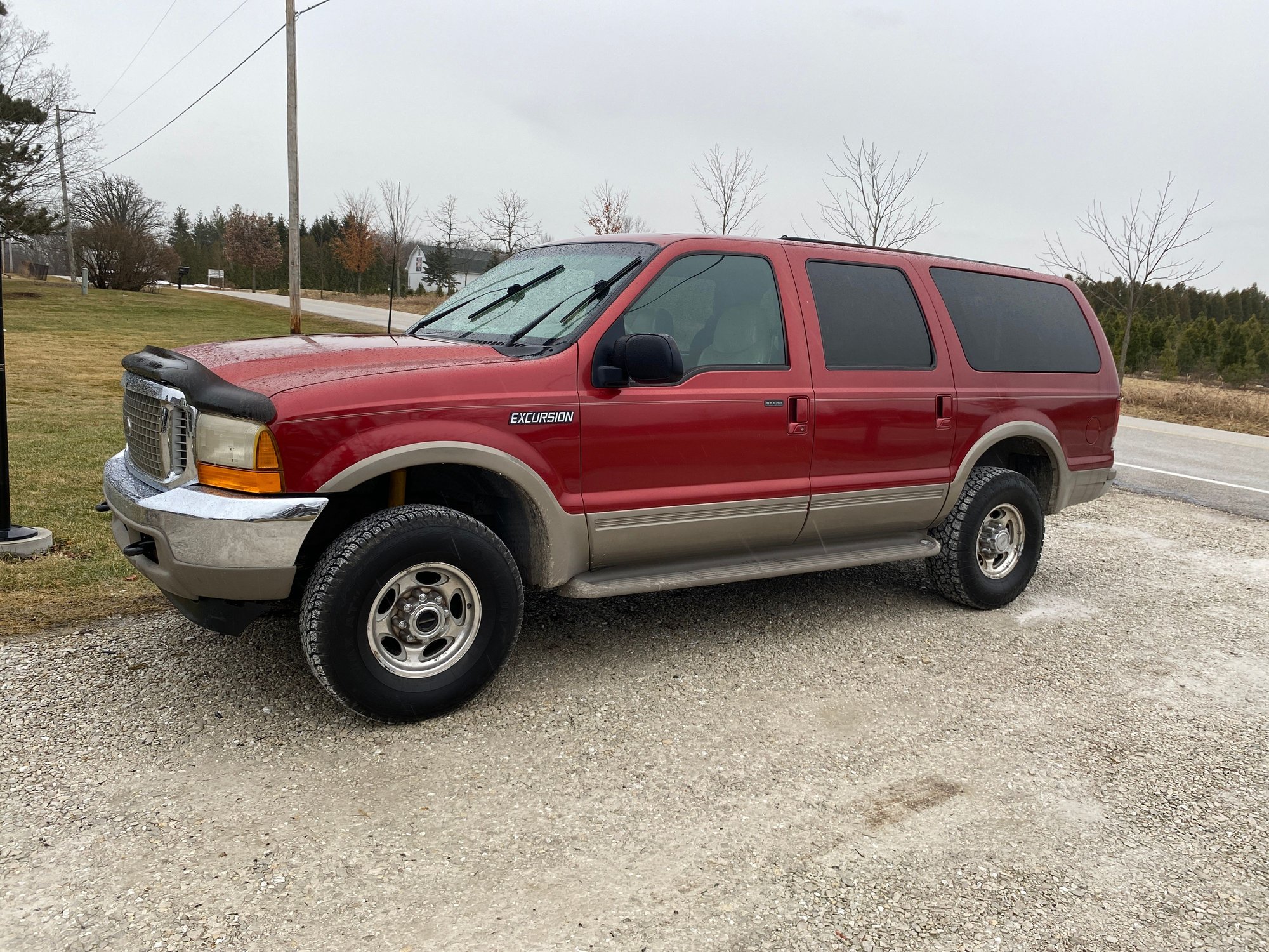

Hello,
My name is Dylan I just purchased my first Ex. It’s a 2000 limited with the V10 and is completely rust free as it is from down in Georgia. That’s a big deal here in Wisconsin because everything we’ve got it rotten as can be. Bought the ex for camping with my wife, 3 kids, and 2 dogs pulling our 33 ft Rockwood camper. First question I have is about what diff I’ve got? I’m assuming it’s the 3.73 but the code on the door tag is blank. Looked up the vin and that info wasn’t there either. I’ll post a pic of the door tag. Second question is general tips on what to look for and address before hitting the long road and then possible upgrades to make prior to camping season. Not looking to spend a fortune right away until she’s a proven runner but I just want to make sure the fam is safe and do what we can to limit breakdowns. Look forward to your feedback, thanks!!

Most, if not all ‘00s are missing the axle code on the door jamb sticker just like yours. From the factory the 6.8 had either the more common 3.73s or the optional 4.30 gears. A quick check of the tach at 60 MPH will tell if it’s a 3.73 if under 2000 RPMs and a 4.30 if over 2K, so long as you have the stock sized tires of course. There should also be a metal tag attached under on the rear diff cover bolts with the ration and some other data on it.
I would give it a good overall checkout to ensure the brakes, suspension bits, exhaust (check the exhaust manifold studs, they like to snap off…) and tires (I prefer load range E for towing) are all in good shape and don’t skimp on weight distribution hitch setup, in my opinion the higher quality hitches are worth the extra cost in comfort and control.
How heavy is your TT ready to travel? Heavier trailers will be more of a struggle with the 3.73s, but they will still get you to your destination, just a little more slowly with more revs and more fuel. I pulled our old 31’ TH that scaled at 9500lbs for the first 2 years we had the EX and TH, it would downshift out of OD if we ran over a shadow. But we traveled from home near Philly down to SC and up to ME with that combo, at that point I upgraded to 4.88 gears because my plans included new 35” tires and a lot more towing. With the 35”s and 4.88s it has an effective 4.39 ratio and it tows much better. We also upgraded trailers in ‘13 with the current 3 slide TT being 41’ long and 12 to 13K lbs depending on water and toys. In 2022 we towed the big TT about 13,600 miles and pushed our total EX camper towing miles over 75K miles, our V-10 EX has been a really great family tow rig for us over the years.
