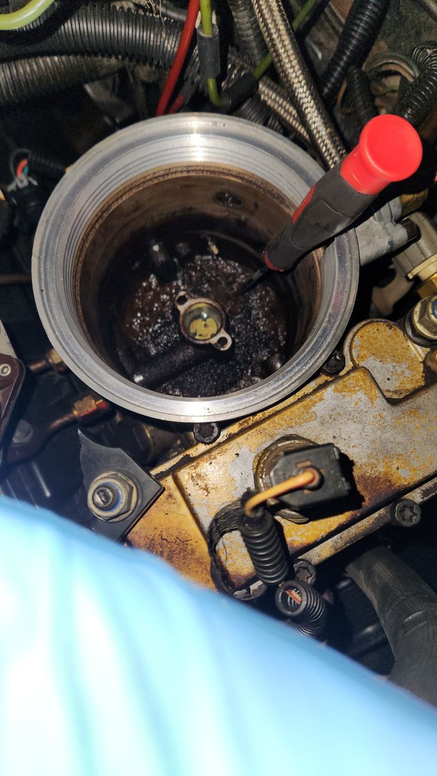

When I bought my truck almost a year and a half ago it was extremely sluggish. It ran ok as long as I stayed off of the skinny pedal. After a good amount a research I went and got a mechanical fuel pressure guage. Hooked it up and the results were not promising. Went and got the items for a hutch mod and droped the tank.
Funds were tight at the time so I did not replace lines going into the sending unit. Nor did I buy new orings for them. That was just me being careless. I did have a drastic improvement in fuel pressure. Still had an issue at wot but other then that stayed in the green. So I disconnected my gauge put it in my tool box and left it there. Fast foward a bit I've modded a few things put a hydra on it and all of a sudden it's fun to drive. Unfortunately I started noticing my power was very inconsistent. For Xmas I decided it was time for a set of guages. 1 to protect my investment and 2 didn't look to cool with my mechanical guage ran out the top of my hood hanging on my mirror from a zip tie. Installed my guages and see where the inconsistencies were coming from. Fuel pressure sitting at 50 psi key on engine off. Crank it get out of the driveway builds up to about 55 psi. Let's the truck warm up hit the skinny pedal fuel pressure drops to 45 range at half throttle. Immediately regret not replacing those lines. So 80$ and a trip to the parts house later I return with 8ft of fuel injection hose. Get it installed double clamped no leaks no bubbles same issue. Runs quiter so I was pulling a small amount of air, but half throttle and bam fuel pressure drops to the 40-45 range. Frustration kicks in start looking for solutions. Decided to check my fuel filter has less the 2k still nice and clean. Pull it so I can check the for. Thought process was maybe its not seating properly pressure bleeding by who knows. Climb up on the pumper to get a better look and Holy ****.
Clean up what looks to be 600k worth of trash. Seems to be mostly clay. Living in east texas this thing was cover in red clay when i bought it. Clean the fpr as well make sure its seating properly. Prime it fire it up and holy **** 60 psi staying steady at wot. Turn up the tune. Best the truck has ran since i bought it. Next day crank her up same **** different day. Pulled the ff cap still clean. Check the fpr again. Small improvement but not long lived. Thinking I'll replace the fpr this weekend really hoping it solves my issue. Figure if not I'm gonna throw a fuel pump at it. Literally lol. If anyone else has any other thoughts or suggestions let me know. Starting to run out of ideas

Dayum that fuel bowl was full of crap!

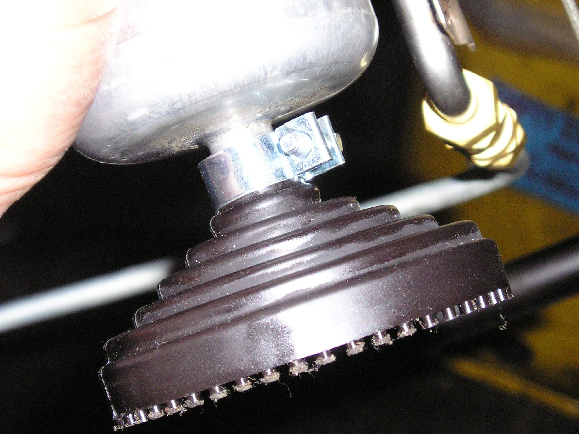

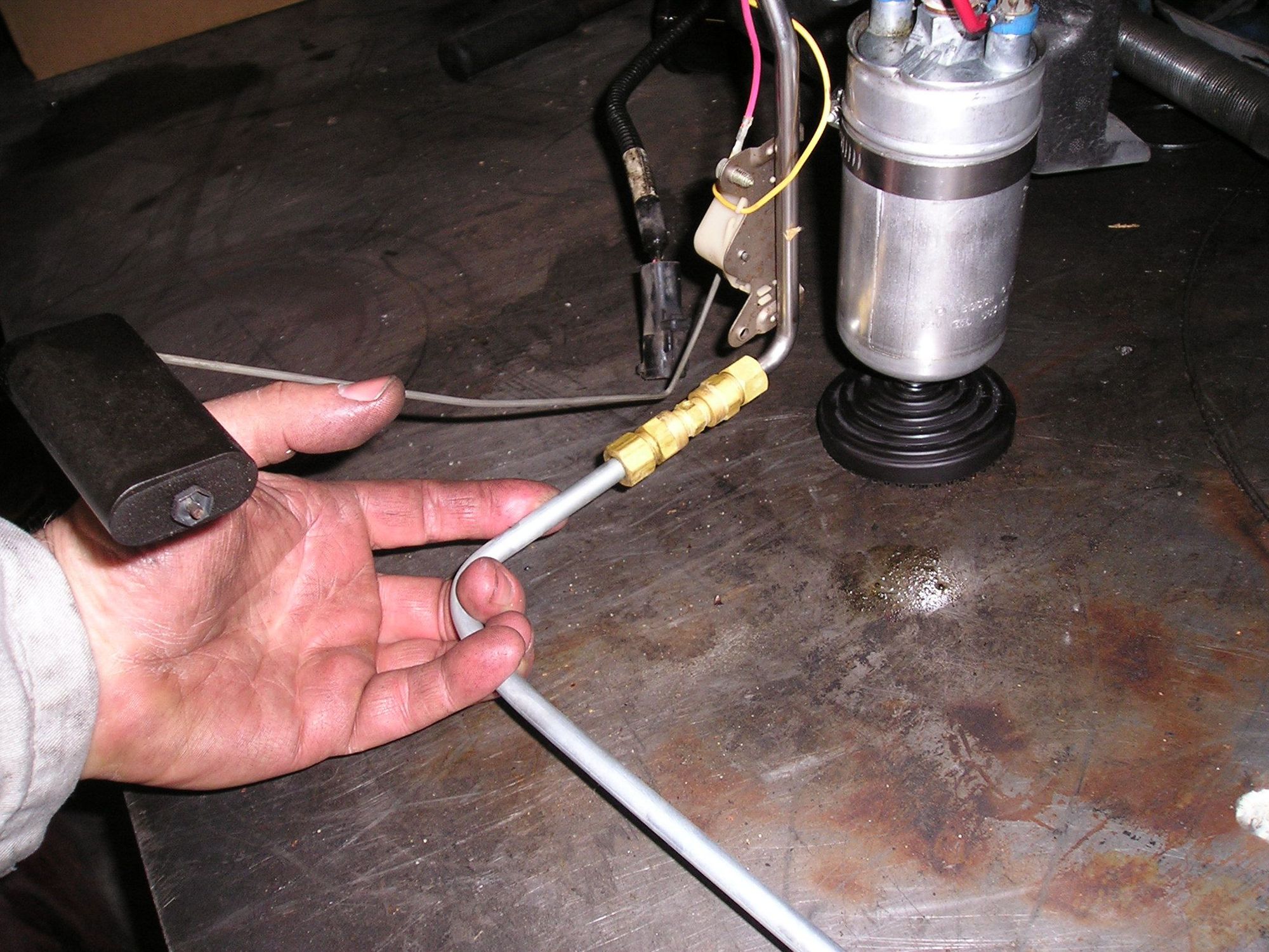

This was my solution to the erratic fuel pressure. Just about every gasoline powered vehicle has the pump mounted in the tank these days and that's for good reason. It's way better to push a fluid rather than pull it. My fuel pressure was dropping to 20 PSI without even pulling a trailer and the power would drop off a cliff whenever I needed to climb a hill. This completely eliminated that issue and the truck now pulls like a bull elephant. There are some updates to these pictures in the form of I had to drop it back down to make the electrical more secure for longevity that I didn't take pictures of, but this system has been in my fuel tank for around 15 years now and it's been as reliable as an old tractor.

Here is a volume test I performed between the two pumps.

A Bosch 69430 is what I used. Others have used the Bosch "044" pump. Both of them are larger in diameter than the factory Ford pump. Both provide a dramatic increase in fuel volume delivery over the factory Ford pump. Plus they don't have that idiot screen on the inside of the fuel pump inlet that gets clogged up and you cannot get at it to clean it out, either. Only choice at that point in time is to replace the fuel pump. I have the screen off of the fuel pickup installed on the intake of the fuel pump on my truck.

From: Rio Rico, AZ.
Also maintenance for me has been a non-issue. Pump has been installed they way it sits now for more than ten years and shows no signs of me having to drop the tank for any reason.

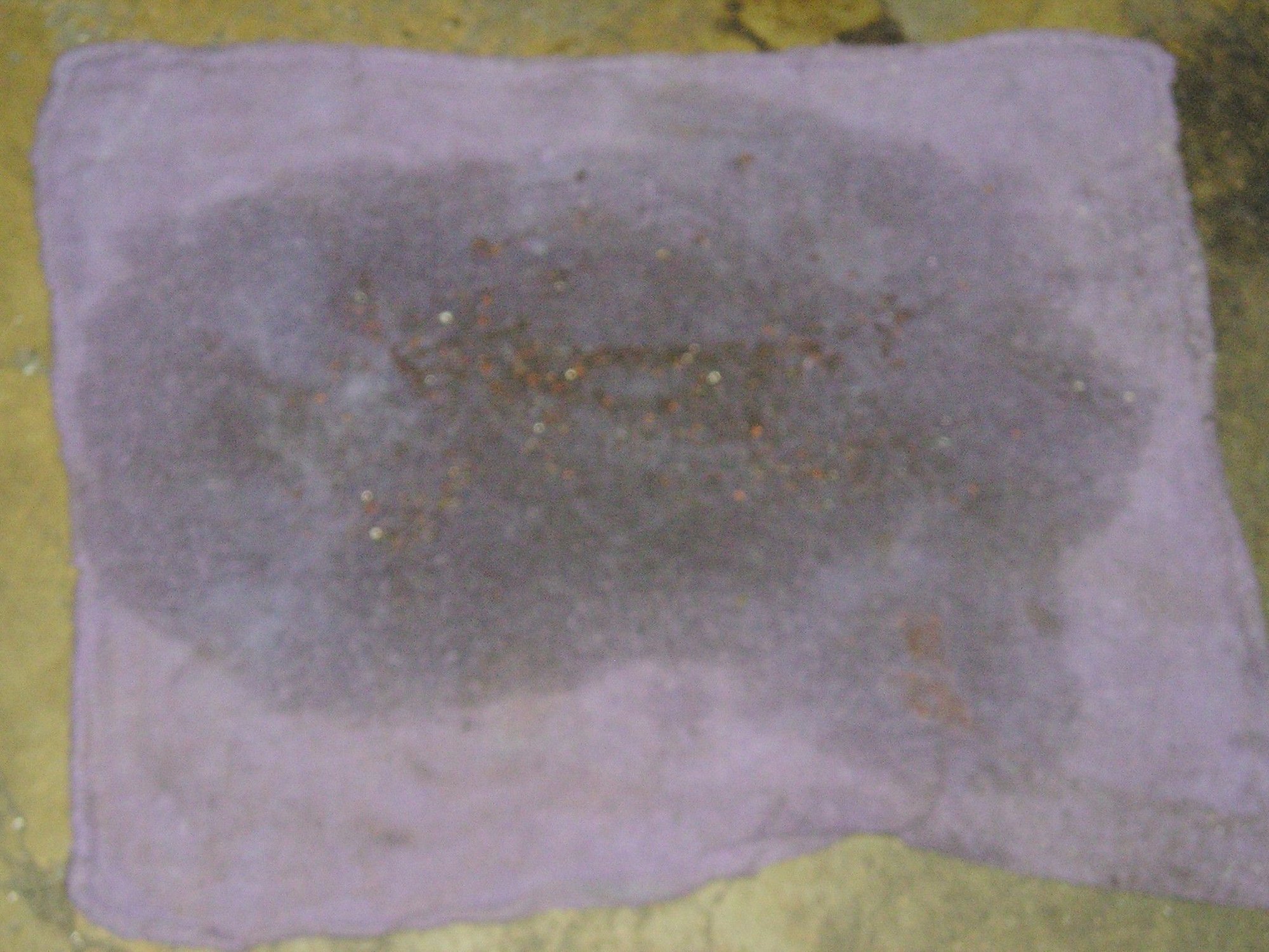

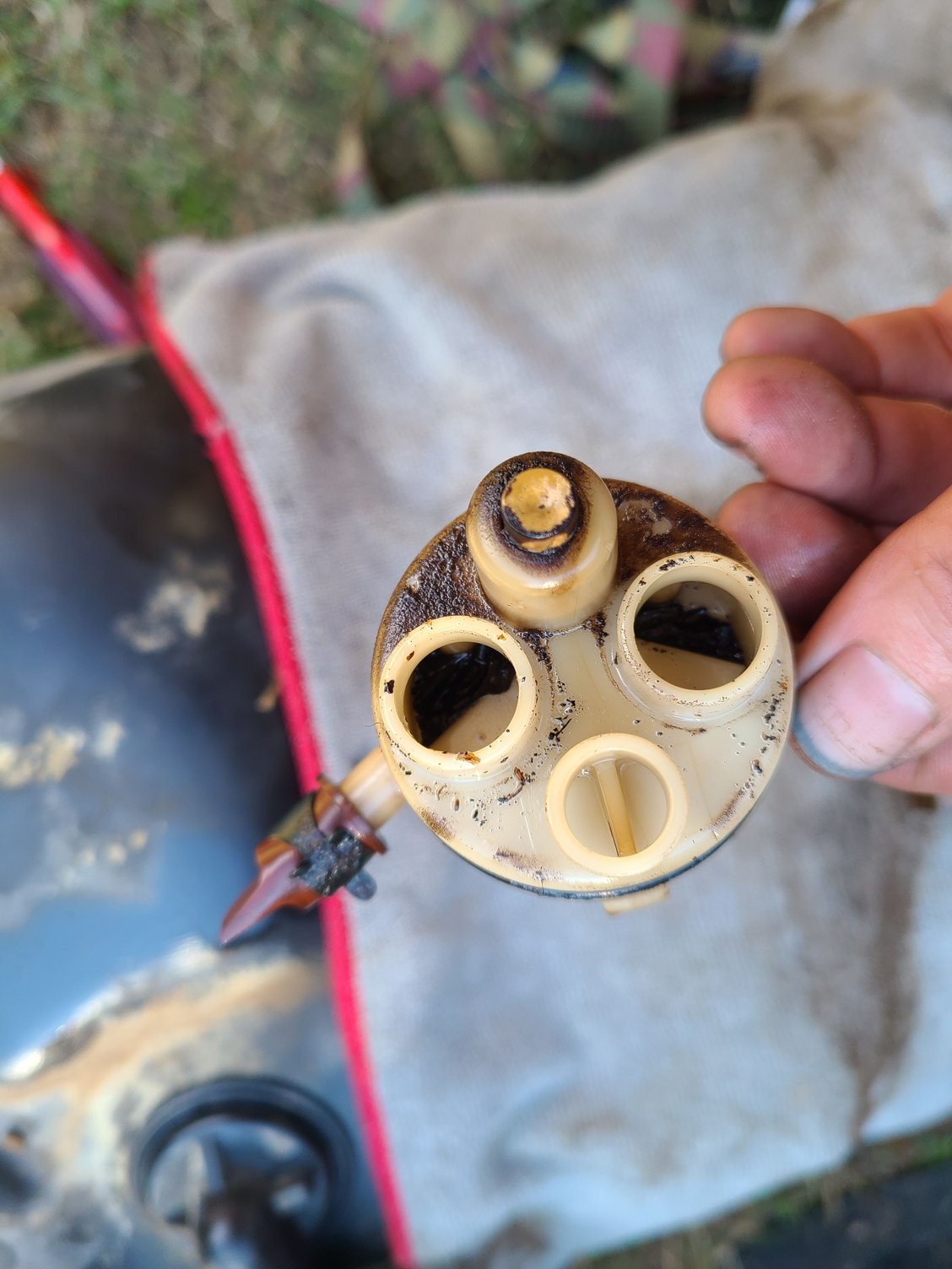

OEM Ford pump is manufactured by Bosch. Stamped right into the side. If I could have figured out a way to dig that screen out of the inside of the pump to remove the blockage that was in there I would never have moved my fuel pump to the tank.
Apologies for the poor focus, but this shop towel shows how much debris I shook out of my fuel pump before I cut it open for fun. The screen was blocked up badly. It would idle with good fuel pressure all day long because the fuel demand was low. Soon as I go and drive the truck, fuel volume demand went up and then the fuel pressure would drop like a rock. Let off the throttle and fuel pressure would come back within seconds. I knew there was a restriction somewhere and it took me a while to finally figure it out by physically removing the fuel pump from the truck and looking down the intake side. VOILA! There was a pile of crud trapped inside the intake port of the fuel pump and I knew what had to be done at that point in time. The rest is history.
