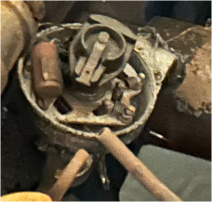

I'm going to guess I need a new distributor. Does someone have an extra or recommend one for 300 inline 6?

Going by that picture. Either you actually have a 240 I6 or someone put the wrong distributor in it. That is a Load-O-Matic distributor. 300 I6's came with dual advance distributors. You need to sort that out. Either distributor is available rebuilt from any parts house. In either case you are better off with a dual advance.

ok. How do I know the difference between a 240 and a 300?

Well, if it has a Load-O-Matic distributor 90% chance it's a 240. Might still have an ID tag on the coil mount. Check the stroke I can't remember what they are you can look them up they are in the shop manual. Pull a valve cover and get the casting number off of the head. The latter is iffy since the heads will interchange between a 240 and 300.

Thank you very much!!I was told when I bought the truck that they put in a 300. I'm wondering if they used the old parts for everything else. The vin shows a 240. I want to put a new valve cover gasket on it anyways. I wouldn't know the difference between the strokes. It's something I may have to learn though.

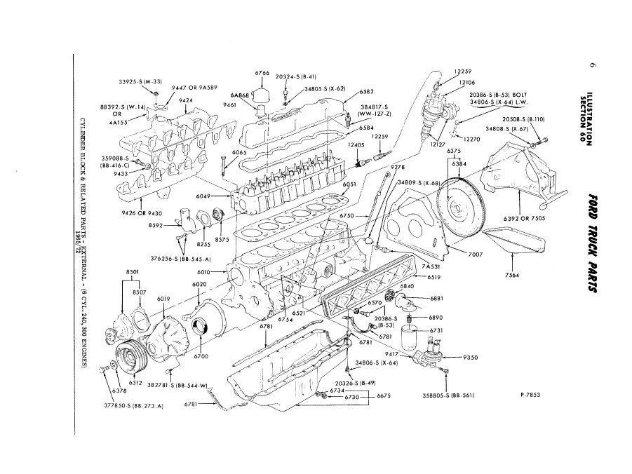

Here's a drawing from the MPC. The valve push rod cover gasket is number 6521. It's typically cork and was in the thick of the fire from what it would seem. That'd be one to also check on.
