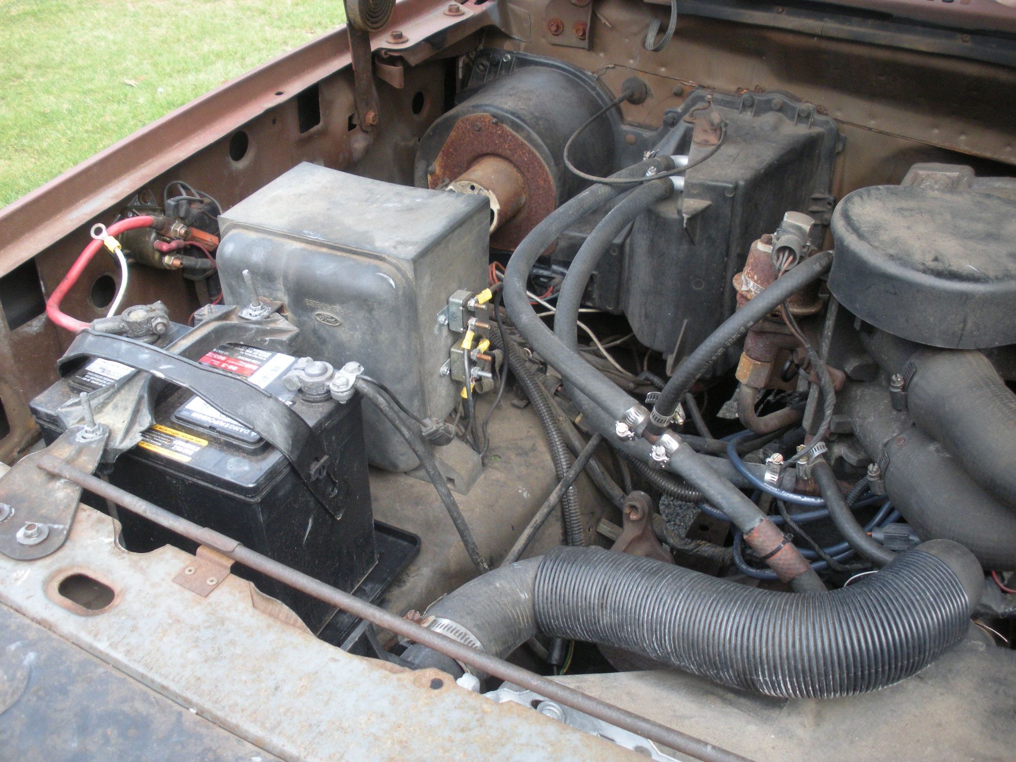

My heater core was easy to replace. I think it was a $25.00 item from NAPA.
I
l think your truck is the same color as mine. 9N Desert Tan, or something like that?
Or, maybe it just shows up that way on my phone

I think there may be a little of that color left on it, mostly its the brown primer. But it runs well.
