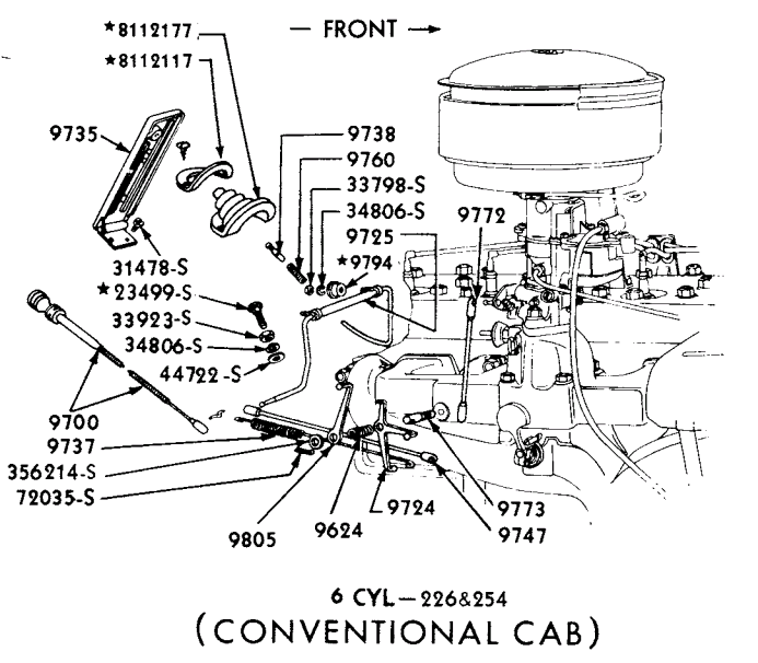

If you are talking about the connection between the accelerator pedal on the floor and the carburetor, it is NOT a cable, but an assembly of rods/levers. The hand throttle on the dash (if equipped) IS a cable very similar to the dash choke control and referenced in my prior post.

These trucks didn't have an accelerator cable from the pedal to the carb. It uses a mechanical linkage with rods and joints that goes through the floor, across the firewall and then forward to the carb. Sorry I don't have a picture handy.

You can see the linkage here on my F1. The only cable going to the carb is the choke.
Did someone retrofit a cable on there in the past?

where it comes into the cab under the pedal it has a spring with the **** on top that hooks to the pedal. it broke off right there. if you push on the part that is still there it still works the linkage for the carb. i have not gotten into it yet to see if that is separate from the linkage you talked about. in the diagram you sent it looks like it is part 9760

The "****", or Rod for the Pedal to Accelerator is part 7HC-9738 (9738 in the diagram above). The spring is 7HC-7960-B.

update I did find the spring i need at dennis carpenters without that diagram i never would have found it thanks to bmoran4 and also everyone else
