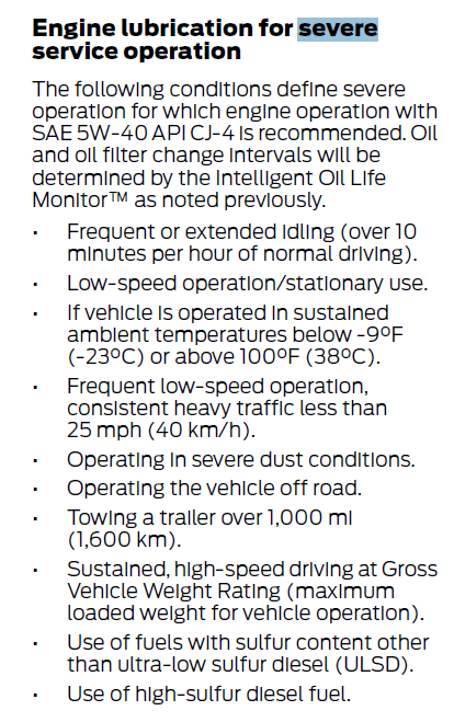

For my 2019 they define it as follows:
Old Feb 2, 2023 | 11:58 AM
That's it, thank you. So yeah, many owners would fall into that use type.

Given the fact you have a F250, I am assuming you are looking at 10k to 10.8k of GVW giving you something around 2300-2700 pounds of payload. Google informed me your slide in tips the scales at 2641 pounds all by itself. So before you fuel up the truck your already pretty close to GVW. To me that is severe use, trips the third to last bullet point from above. IMHO of course so that and 3 bucks can't even get you coffee.
