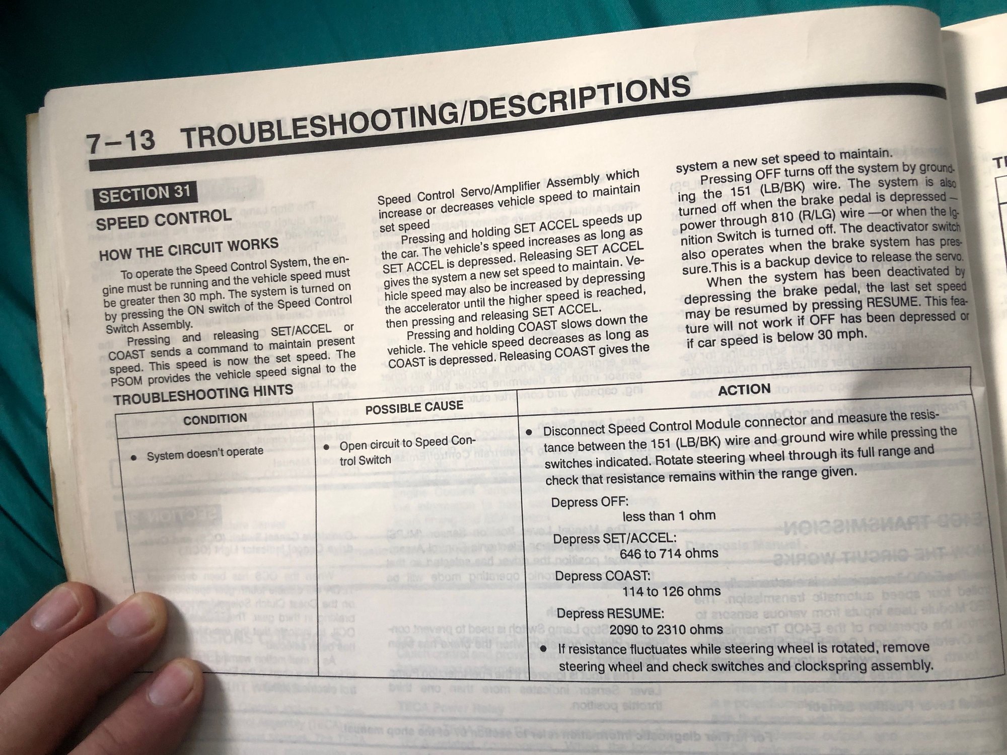

Old Feb 1, 2023 | 01:47 PM
wwwheaty's Avatar
wwwheaty
Joined: Aug 2008
Posts: 151
Likes: 16
Here are the pages for a 1992….
