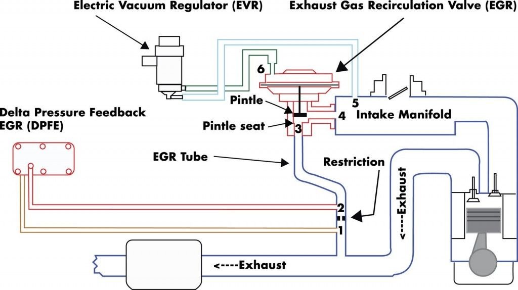

Out of curiosity (I’m not super familiar with the vacuum systems) how is the differential pressure related to the EGR? Do you know where I can find a full vacuum diagram?

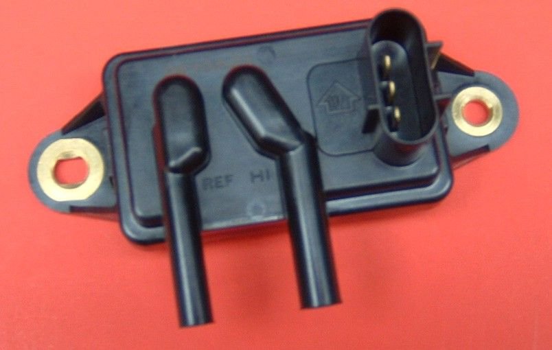

When obd2 was adopted, the manufactures wanted to know /how much/ exhaust gas was flowing into the intake manifold, as oppose to the original method of only watching the position of the valve.
This is done with the "Differential pressure feedback electronic sensor" (DPFE). By monitoring the difference In Pressure across a restriction, the computer can determine if exhaust gas is actually flowing into the intake manifold, or if you have a clogged tube or valve. Your computer is telling you that the sensor is reporting a pressure differential when it's not suppose to. Possibly a bad sensor, or a bad wire.
