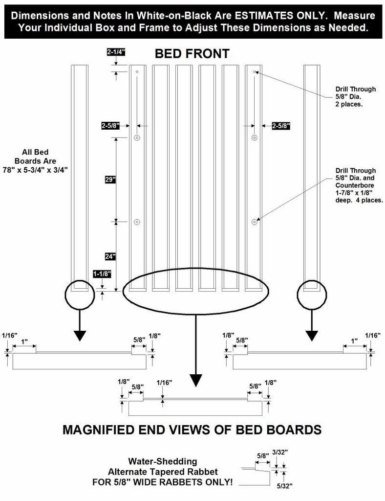

Can anyone tell me the thickness of the bed wood for 53/55 bed and also the width. Thank You.

¾" × 5½
There is a diagram floating around here somewhere that shows in detail the dimensions of the board cuts and routing.

3/4” x 5 3/4” type in 55 f100 bed wood dimensions and all the info is there.

https://www.mar-k.com/PDFs/Instructi...Dimensions.pdf

Here's another...

3/4” x 5 3/4” is what I have in my 54 f100
