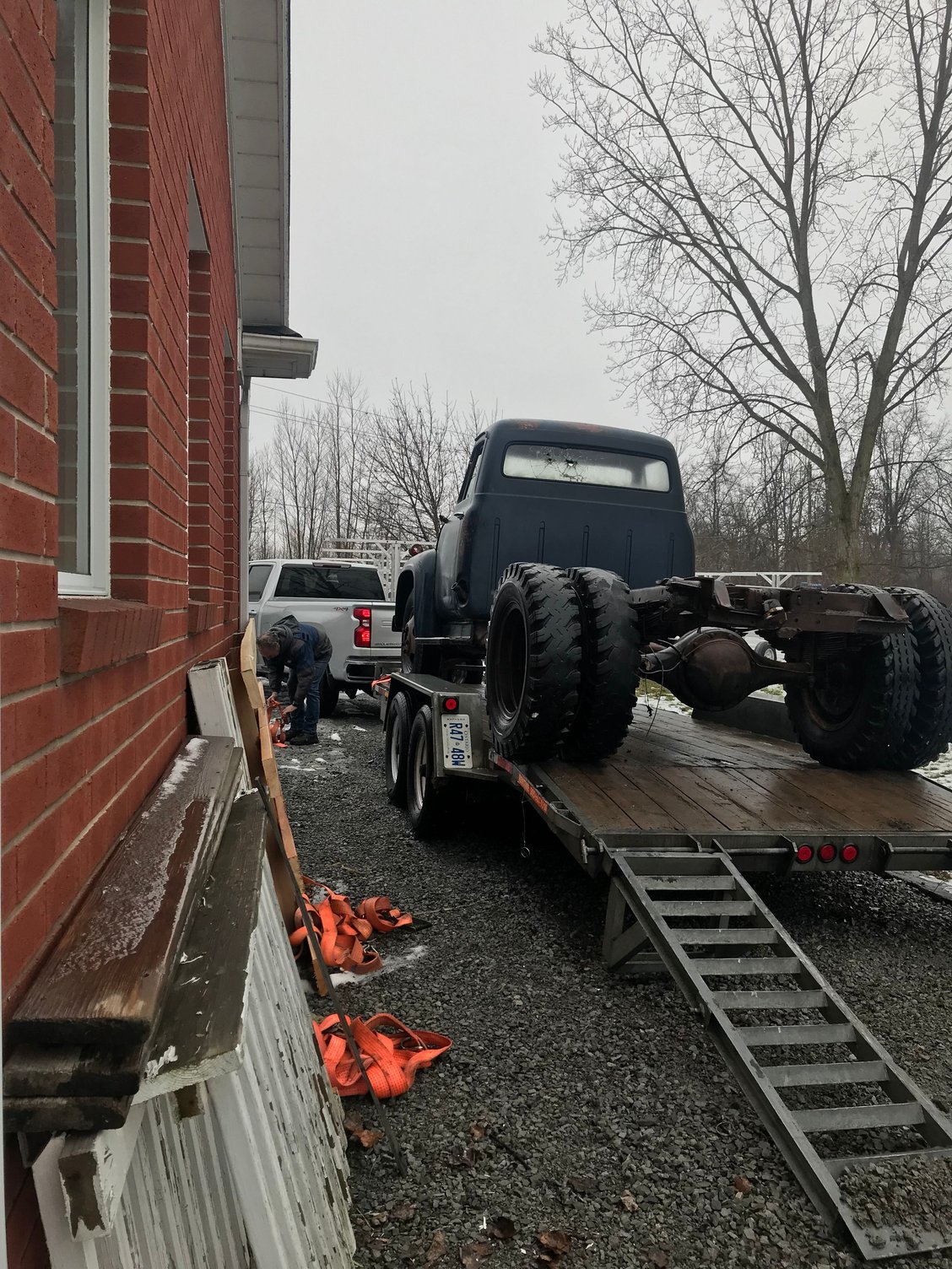

Hi all, I finally got my project truck home. First off I tried to turn the engine over from the front end but it’s a no go. Wasn’t sure how long of a persuader to put on it. Didn’t want to break the bolt off. I’ll look for a spot to try from the flywheel if I can get more leverage there without breaking anything. I’ve loosened all the spark plugs, thankfully without breaking any. I know there are lots of home remedies for what to pour in the cylinders to try and free them up. I’d like to hear some ideas.
What have you all tried pouring in there that worked?
Also, can anyone ID this engine size with certainty? I have no VIN number in the glove box or on the right frame rail as others have suggested here. Not even sure what I have exactly.

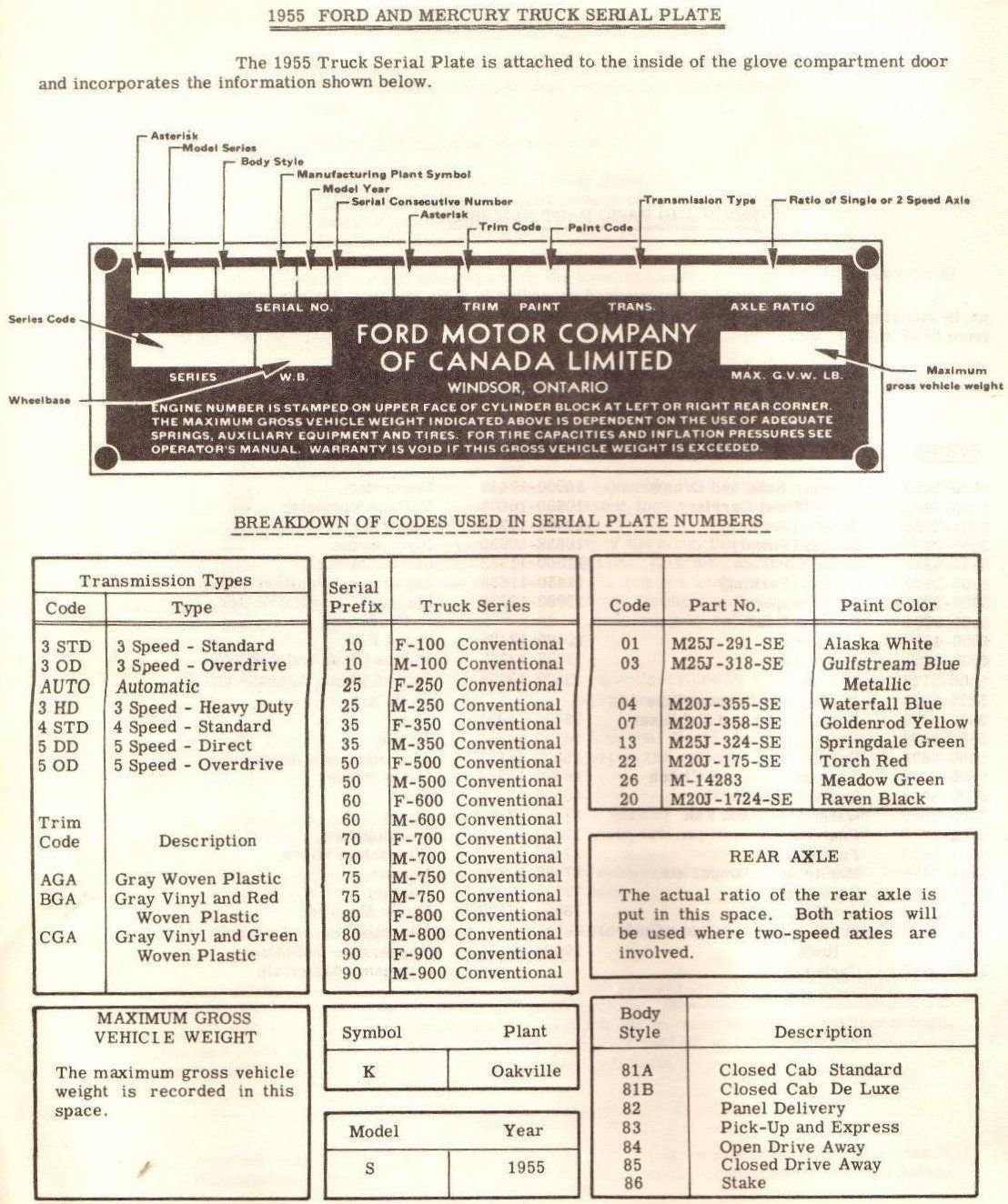

Welcome to the forum! Seeing that you're in Canada, and assuming you have a Canadian built truck, the rules can be different on some things from US production. For your frame serial number, you might check the left frame rail, near the steering box. That's where they put it on the earlier trucks. I have no idea if it may be different by '55. It's worth a shot. Keep in mind your serial number will be a totally different format from US production, too.

Wow. Thanks for the fast replies. I’ve never rebuilt a truck before but looking forward to it. Thanks for the information. I think it might make sense to pull all the belts off the front also so I’m not trying to turn a seized water pump or generator too.

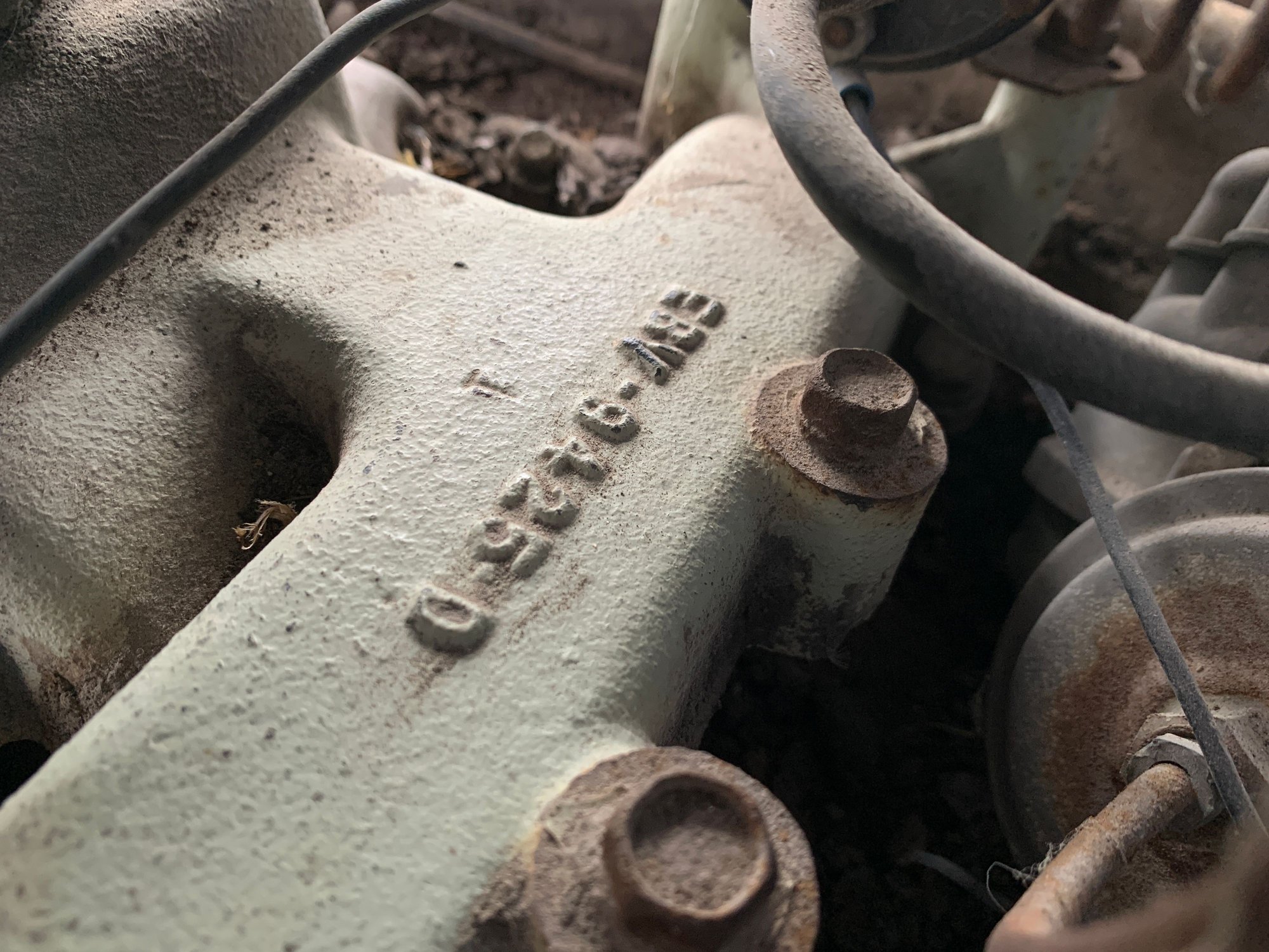

Check the letters on the intake or the heads. EBV is a 55 239, EBU is a 54 239
Here is an identification chart. Y

Thanks everyone for the tips. Seems like a great group here. Still working on turning the motor. After cleaning the engine up with a shop vac and compressed air I found this at the back of the intake manifold. That settles it’s a 239 EBV. Transmission looks like the stock 4-speed. I have the cab stripped out and started pulling fenders off. I wanna get it down to the frame and powertrain. I can do all the body in the garage in pieces but there’s no room for the frame.
