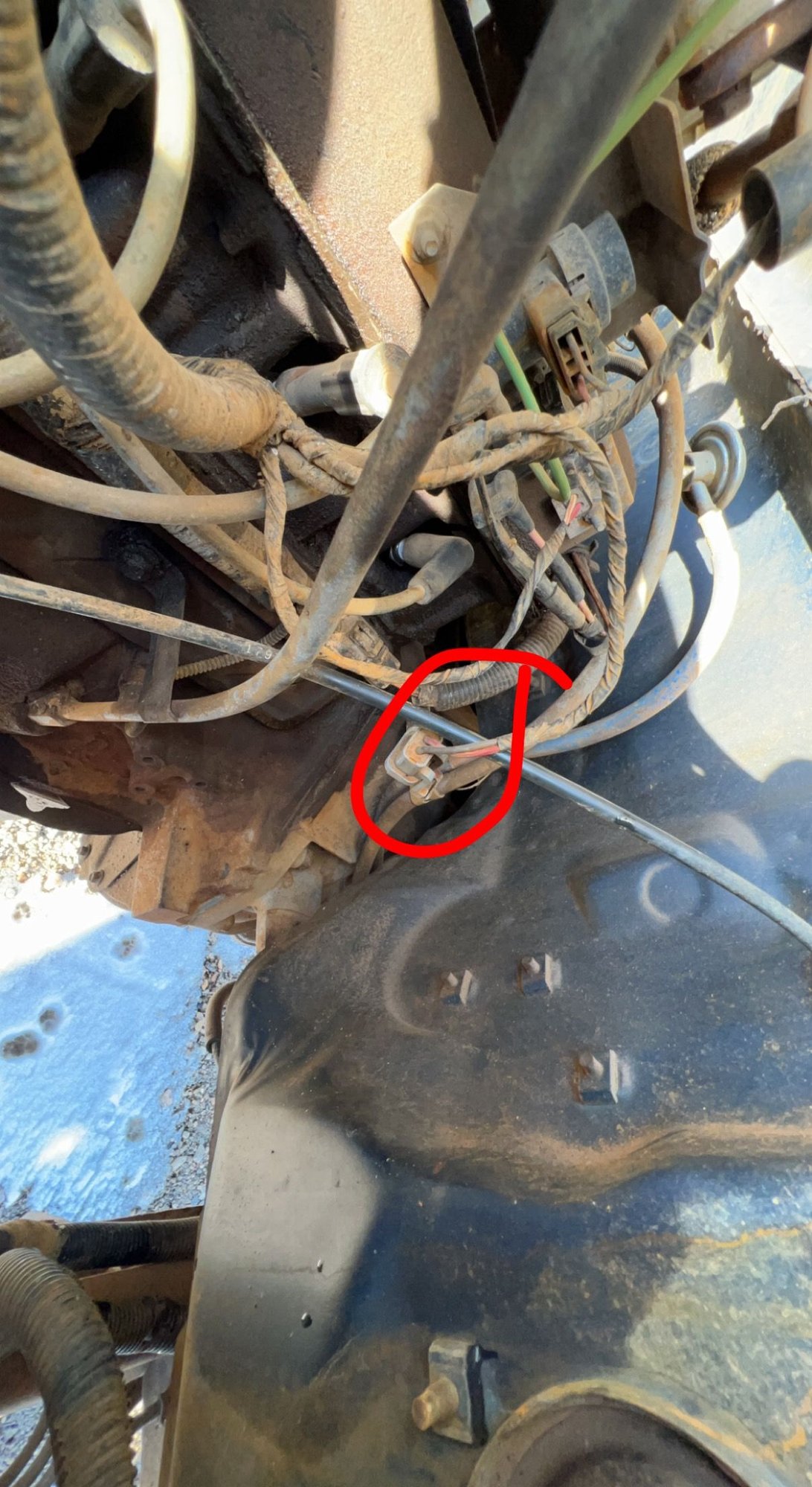

Random wires are not connected around the pickup, it’s also misfireing badly. need help figuring this out

Some are for options not installed on your truck so they are left open.
It might help if we knew the number of wires in the plug, wire colors, and location as it is hard to see where they are.
Did this issue just start or happen over time?
Did you pull codes to see what the computer has to say?
It also looks like the cooling system needs service, rust all over the engine bay for a blown hose?
Could the coolant gotten into the dist. cap, plug wires or other sensors be the cause if your issue?

Second to last for A/C comp. Let me go outside and can ID others from my 92.
Old Jan 22, 2023 | 11:15 AM
Hit Man X's Avatar
Hit Man X
Joined: Sep 2002
Posts: 9,566
Likes: 2,036
From: North Texas
First is charcoal canister vent valve.
Second for missing smog solenoid.
Last should be high pressure cutout for your non installed AC.
