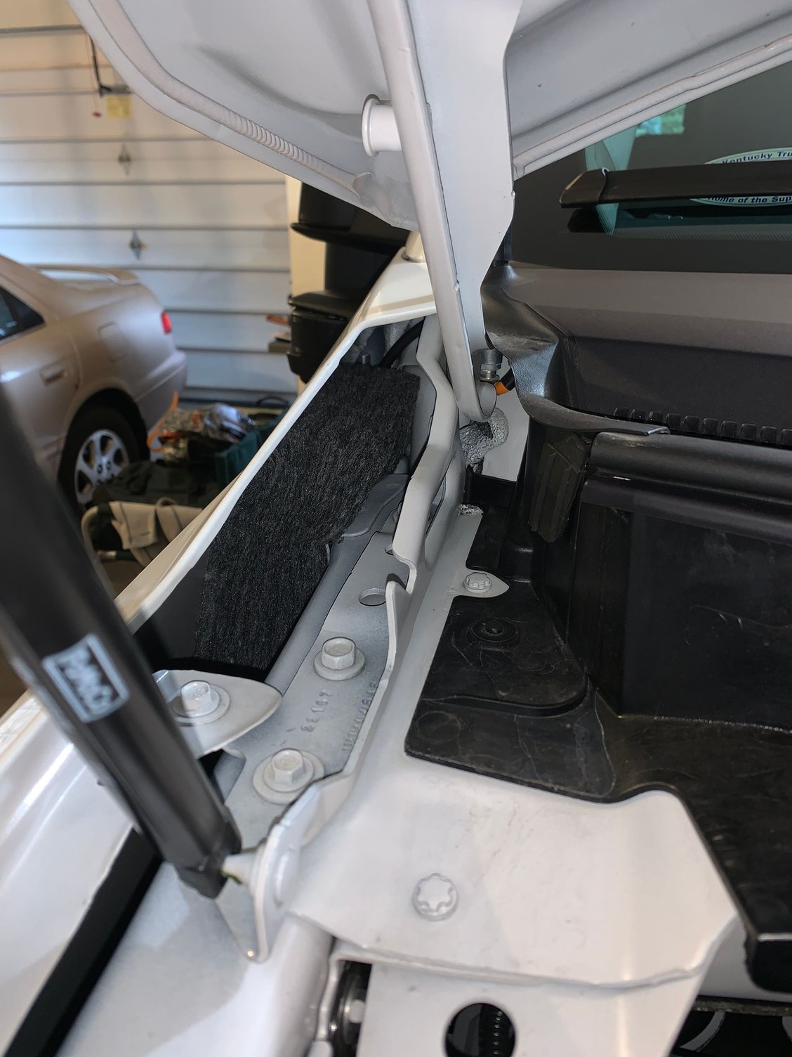

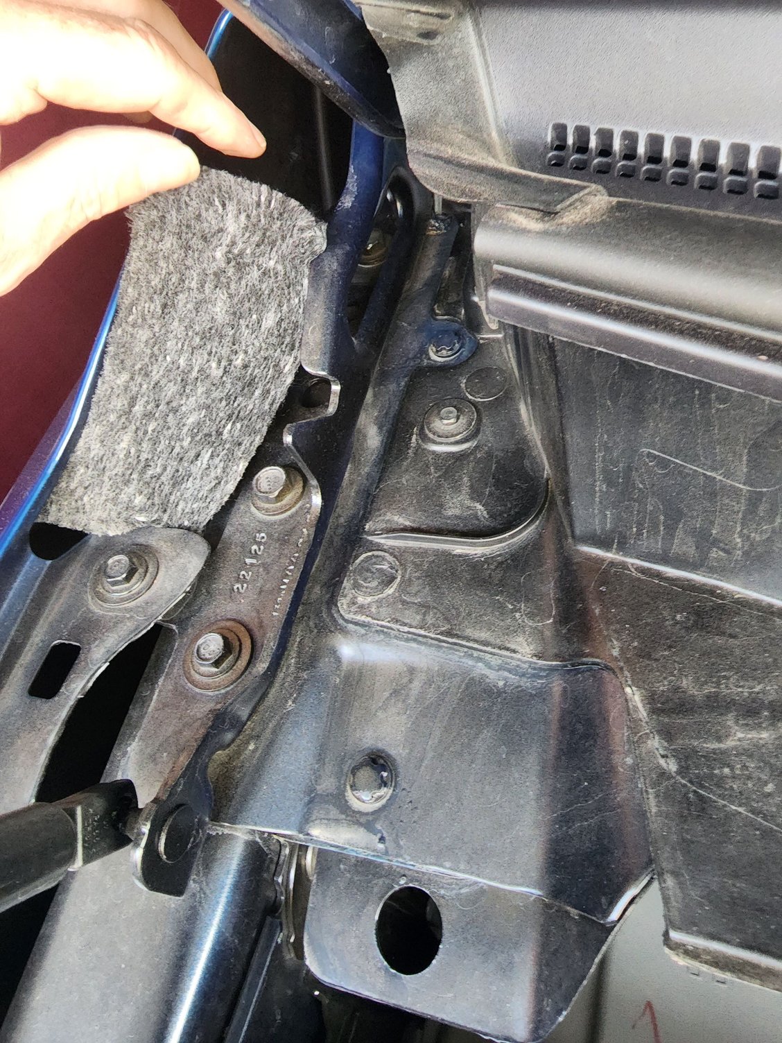

I haven't been under my hood much but today I went looking for upfitter wires. I had seen these blocks before but this time I became more curious. They don't really seem to be attached, just kind of stuffed in the corners. So, noise reduction? Vibration? Fire protection? Or maybe forgotten about during PDI?

My guess is that it absorbs some sound from the fender vibrating. I can't think of it doing anything much more than that.

I have them as well. Not sure what they are for though.

I'de have to guess its a cosmetic plug so you can't see all the way through to the ground, because without it others will ask... "am I missing a part here?"

I could be wrong, and it's raining outside right now, but I don't recall seeing those on my 22 6.7. I'll be sure to look next time I pop the hood...

I don't believe mine has them either, but it also doesn't have the hood lining.

Mine has them too. Figure it's future rodent nesting material.

They look like debris filters (to keep leaves and such from falling down into the fender area). I don't recall those being on mine, but I do notice that leaves and debris collect in that area of the hood, since dead leaves are abundant this time of year.
If left long enough down in the bottom of the fender area, they'll rot and contribute to rust.

aww crap, beat me to it.
Those that have it, Lariat and up? Those who don't XL/XLT? If so, then sound deadening for the upper trims. If not, than whodahellknows.

Last minute NVH fix by Ford. Seen it alot. Easy to install, no special tooling needed, CHEAP. Someone test drove / evaluated the truck close to Job 1 and bitched about noise or something. Happens all the time. Similar to last minute bolted on mass dampers to eliminate some noise / resonant frequency an evaluator wrote up at a certain drive cycle. Every MD I've seen is bolted on, an indication that tooling / weld fixture was not planned earlier in development and needed a quick remedy near SOP. They'll VA/VE out probably on the 2023 release.

My Lariat Value Package has them, exactly like the one's in the OP's pictures. It's funny how somebody can point something out, and you wonder how you never saw it before. I have no clue what they are but noise reduction and/or debris catchers seem like good possibilities.
