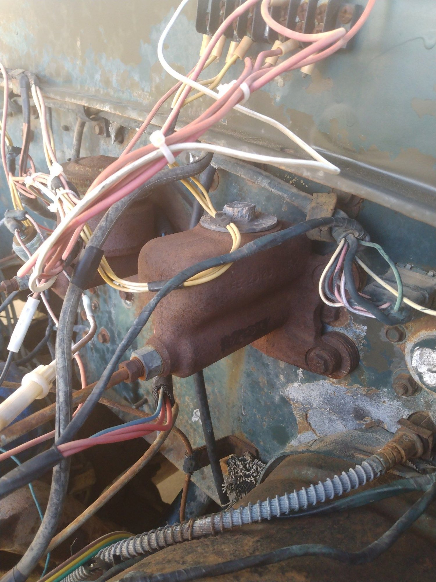

It has a 292 Y-block V8 and T-98 4spd in it. When did FoMoCo start using the Z-bar clutch setup instead of the hydraulic clutch linkage again? Because this truck also has the hydraulic clutch linkage, too.

As per Numberdummy posts, '57-'60 had hydraulic clutches, '61-'66 and beyond did not.
https://www.ford-trucks.com/forums/1...l#post19521584
This shows clutch parts '61 and up:
https://www.ford-trucks.com/forums/1...l#post18862496
Since the bodys are completely different, I doubt we have a door swap problem where someone brought over a door with the other trucks warranty plate.
Looks like maybe someone did a bang-up job of swapping in the 292 and T98. '64 was it for the 292 so it was probably pretty easy to swap it in.

^^clutch master cylinder and firewall 1
^^clutch master cylinder numbers
^^clutch slave cylinder 1
^^clutch slave cylinder numbers
We will look for the VIN on the truck frame tomorrow. Thanks to all for your interest and suggestions. The original paint under the repaint of the exterior appears to be military olive drab. The plot thickens!

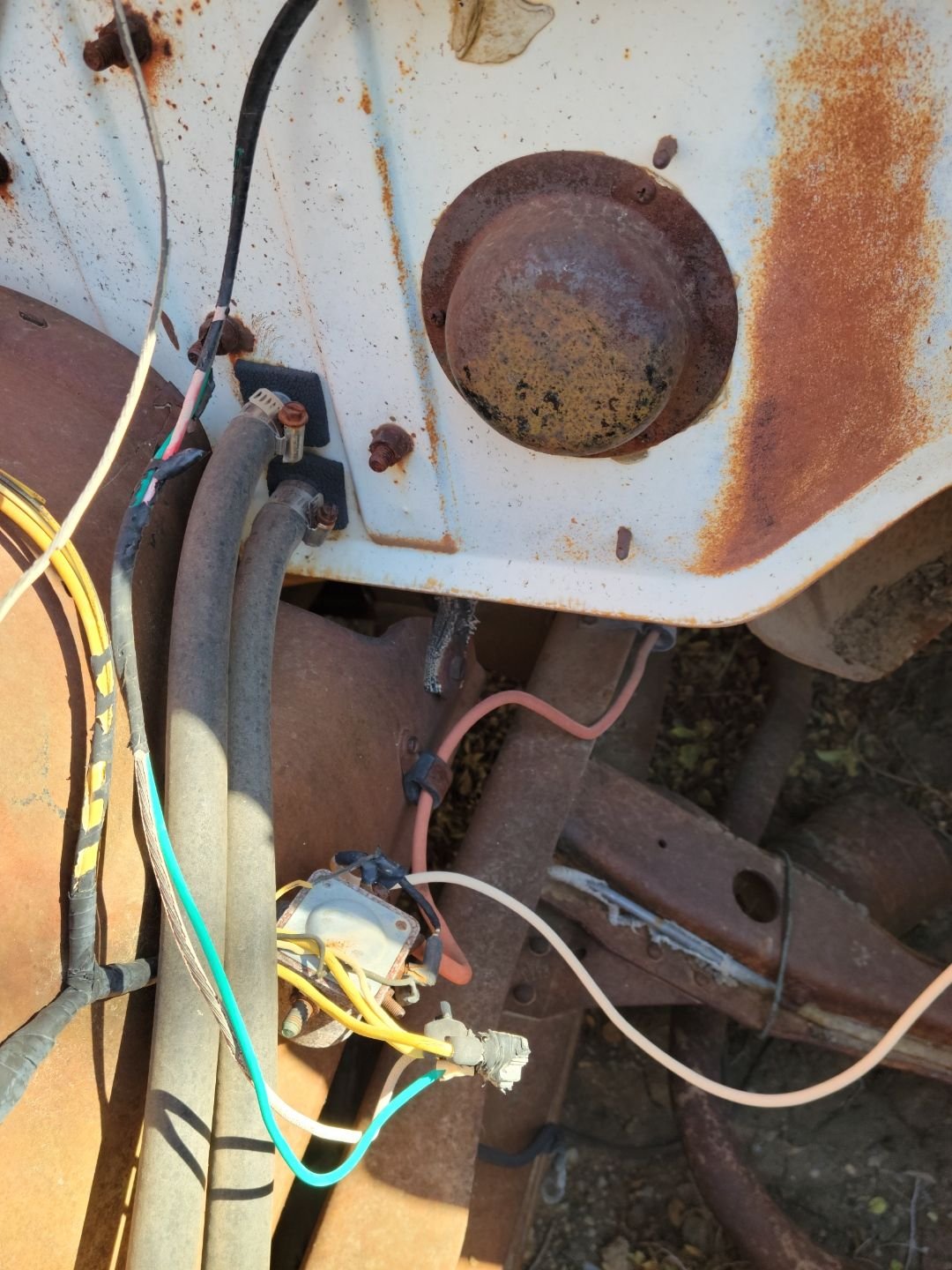

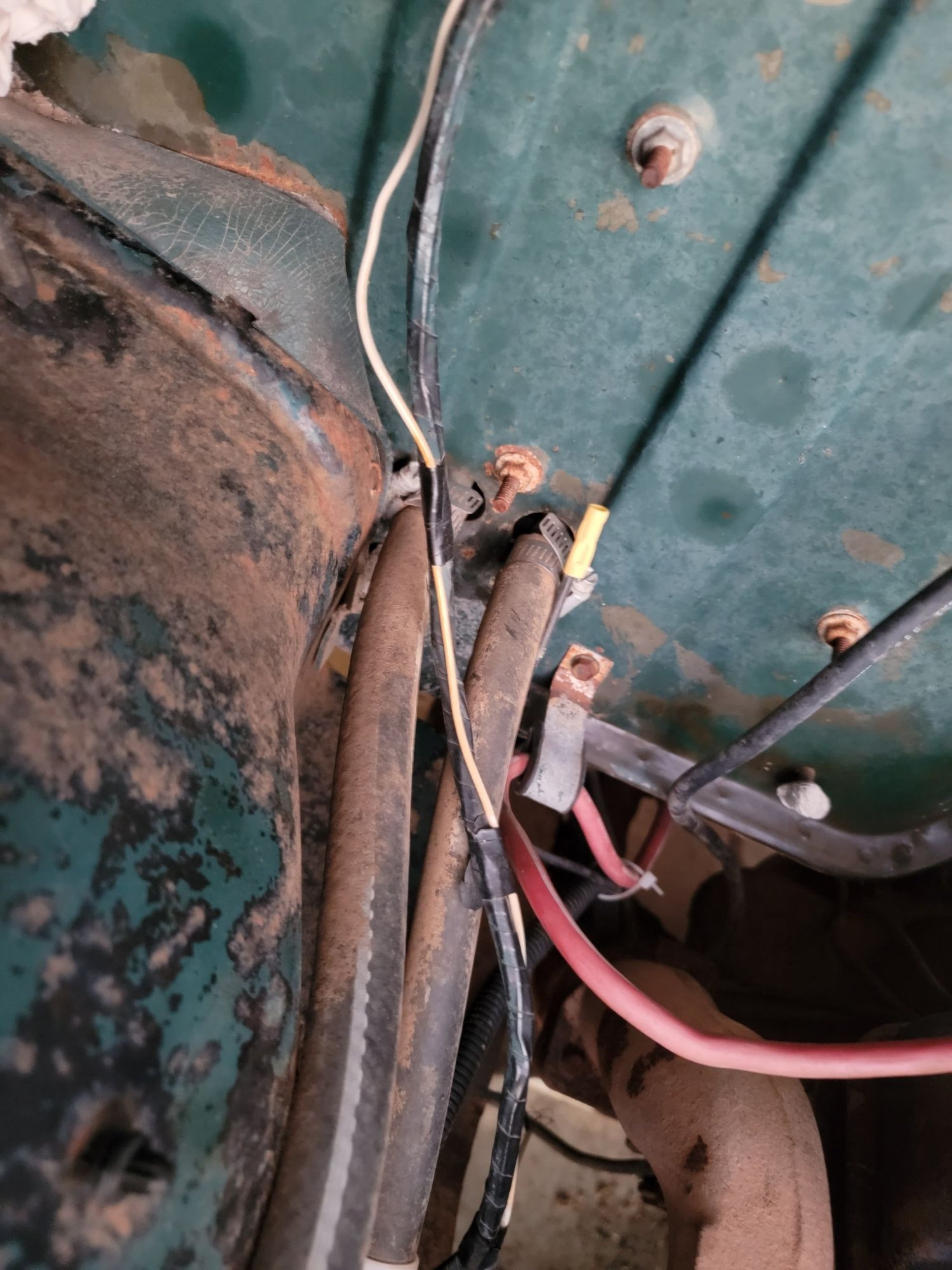

Where the heater hoses run through the cowl, are they stacked vertically or are they side by side. That would indicate 64 or 65.....

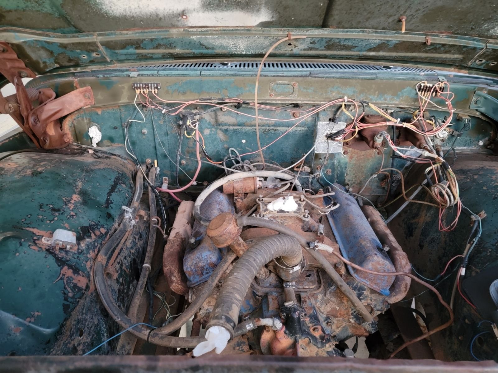

Old greener's heater hoses are horizontal
They are horizontal, indicating a '65:
^^'65 truck heater hose arrangement is side by side
^^ firewall of '65 showing heater hoses penetrating horizontally
^^ a '64 has the heater hoses stacked vertically

Interesting truck...... Didn't most truck-installed 292 V8s have an exhaust pipe running across the front / above the engine? Maybe the exhaust manifolds are off of a car?
How about that hose coming off of the oil fill cap?
With a 4.56 rear gear, that baby would have been suited for tree stump pulling duty!

The oil fill cap has the attachment for the hose and that was used on the "closed system" similar to the 1964 at the link below. There are pictures of the engine, and you can see the hose runs to the top of the air cleaner. Similar systems for 1965/66 except the oil fill cap moved to the top of the driver's valve cover on the V8. It was part of the emissions control system.
Help with this trucks VIN - Ford Truck Enthusiasts Forums (ford-trucks.com)

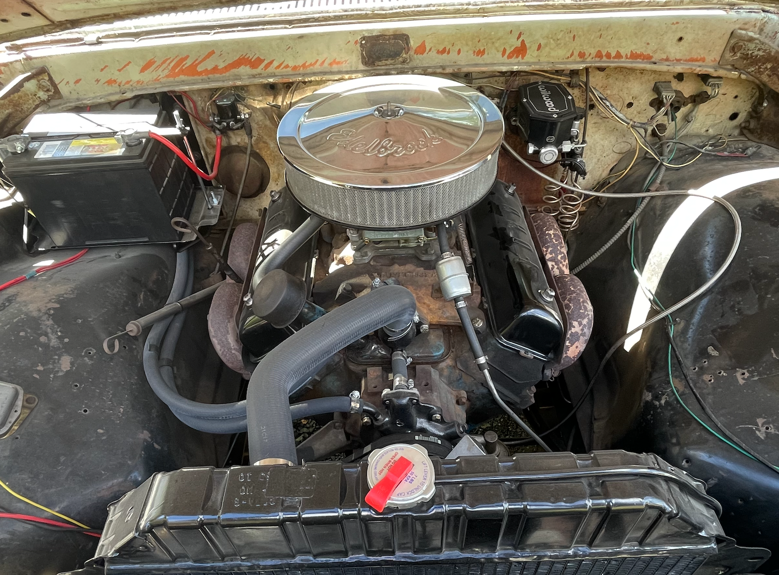

With this link you can figure out what year the Y Block is from. Possibly see if it came from a car or truck.... TECHNICAL My 64 has that style oil cap to the bottom of the air cleaner... My 62 had the California emission PCV setup.

But what about that missing exhaust pipe across the front - Didn't most truck-installed 292 V8s have an exhaust pipe running across the front / above the engine?
Are the exhaust manifolds from something else - off of a car maybe?

These are the original Ford Rams Horns that came on some HD 292's in the larger series trucks. This engine in mine was installed in 1973 and has a 312 crank and a 4V manifold which the F100/F250's never came with from the factory. They do remanufacture the rams horns these days but these are Ford. They actually had the it collecting into a single exhaust like the factory had but I changed it to a dual exhaust. Still runs great.

I would submit that the Y-block and 4 speed trans, complete with it's hydraulic clutch setup came from a donor 57-60 truck.
