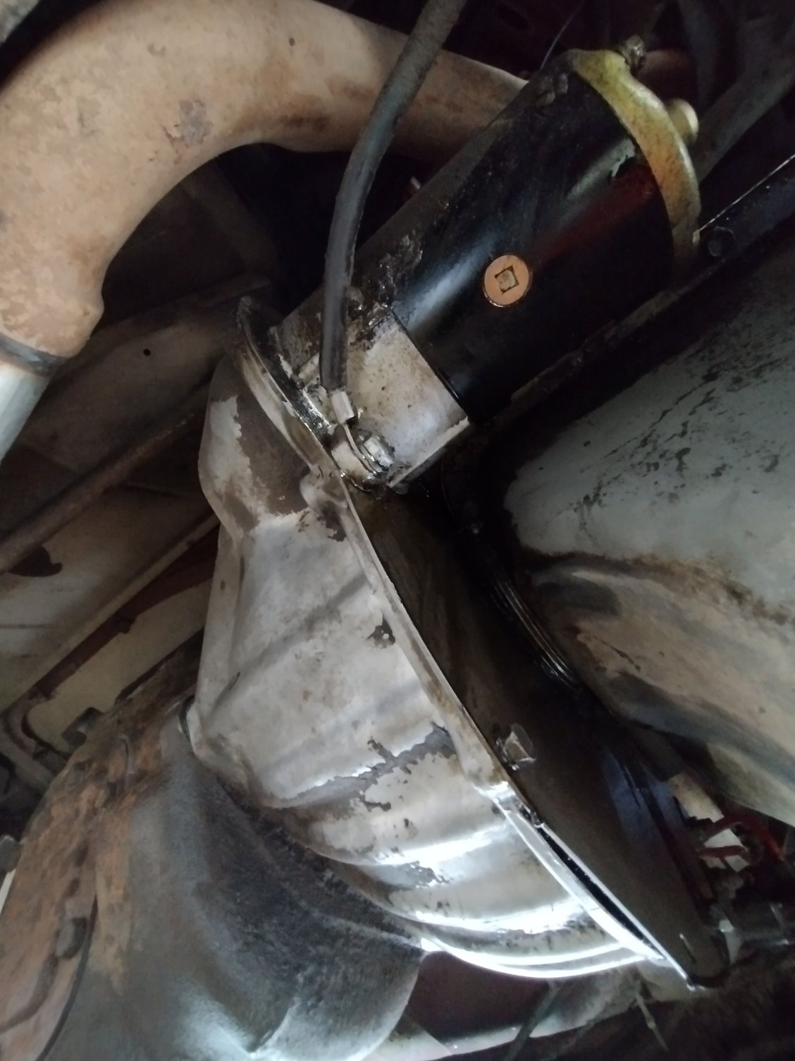

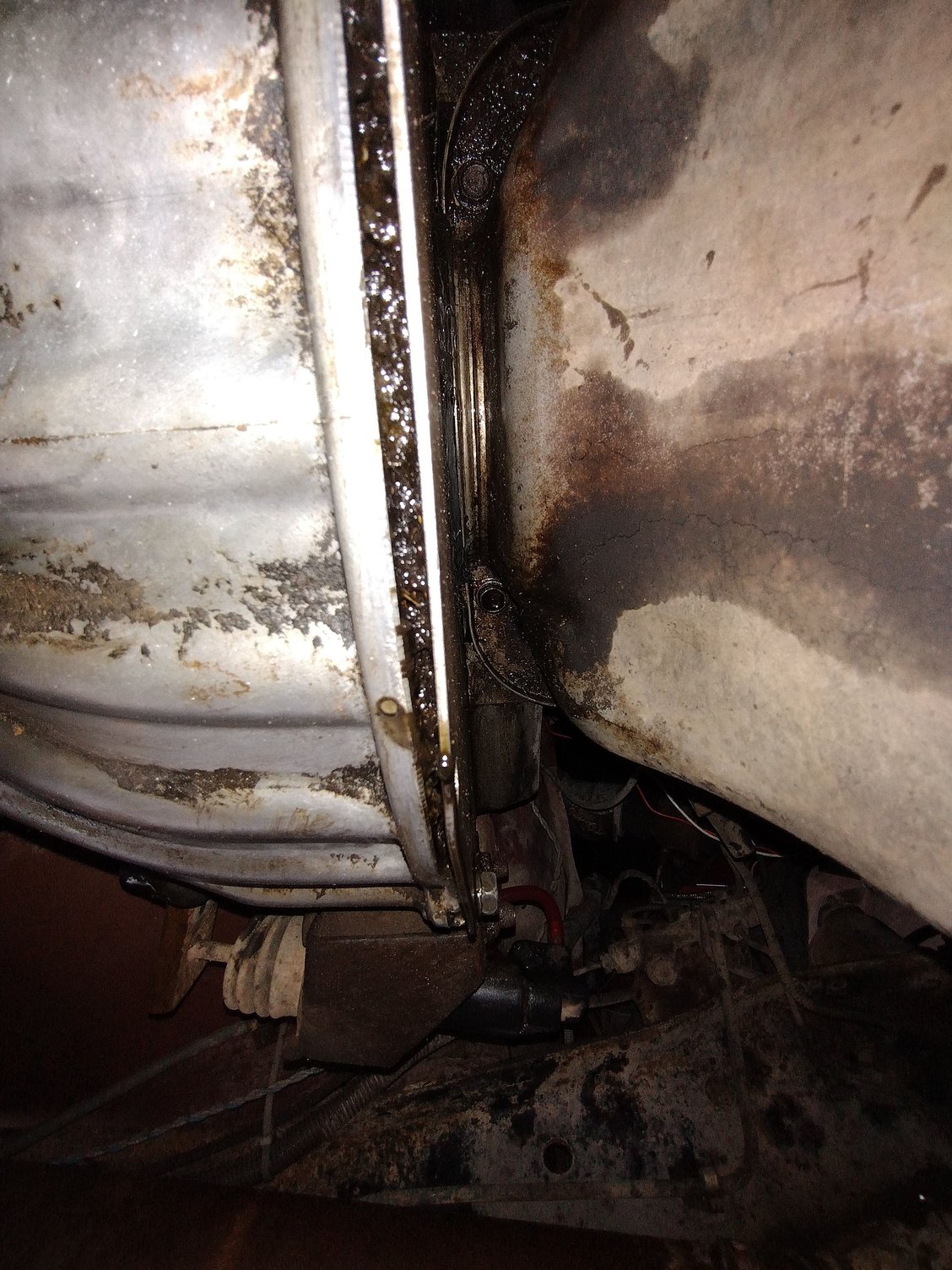

Here we go. 84 f150 4.9l has an oil leak it's not the valve cover I've checked from underneath and the oil is not coming from the top. I'm pretty sure it's not the oil pan, I just did that gasket and the oil seems to be coming from in front of the pan. I think it's the rear main seal. I have oil coming out of both sides of the bell housing. Up by the starter and everything. Now if it is the rear seal when I was looking there was one that said "rubber" is there two? And is it easier to pull the engine to do the clutch then it is to drop the tranny? It sure looks like it would be easier.

First is to find where the oil is coming from.
Nothing like ding the rear seal only to have it still leak
Get some de-greaser and carb or brake clean.
Use the de-greaser first to get most of the oil & dirt off the motor & transmission.
Also see the 2 bolts at the bottom of the bell housing, remove them and pry the plate away from the bell housing a little and try and clean that area the best you can.
Now any oil / grease that is left use the carb / brake clean to get it clean.
Again pry that plate away and clean it better with the spray cleaner.
I would keep that plate pried away and start the truck and let it idle.
Try not to bring the RPM up as that may blow the oil all over and not be able to tell where it is coming from.
Check to see if you can now pin point where the leak is coming from.
Check and re-check the valve cover at the rear to make sure it is not leaking and running down the bell housing and making it look like the rear seal. Use a mirror and light to check back there.
If it is running at idle and not leaking after say 5 min. bring the RPM up a little and check everything again.
I cant see the rear main seal leaking oil up on to the starter and why rechecking the valve cover.
Also with the plate away from the bell housing if the rear seal was leaking it should now drip out as the plate is not holding it back.

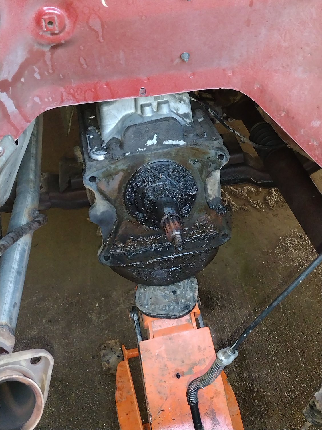

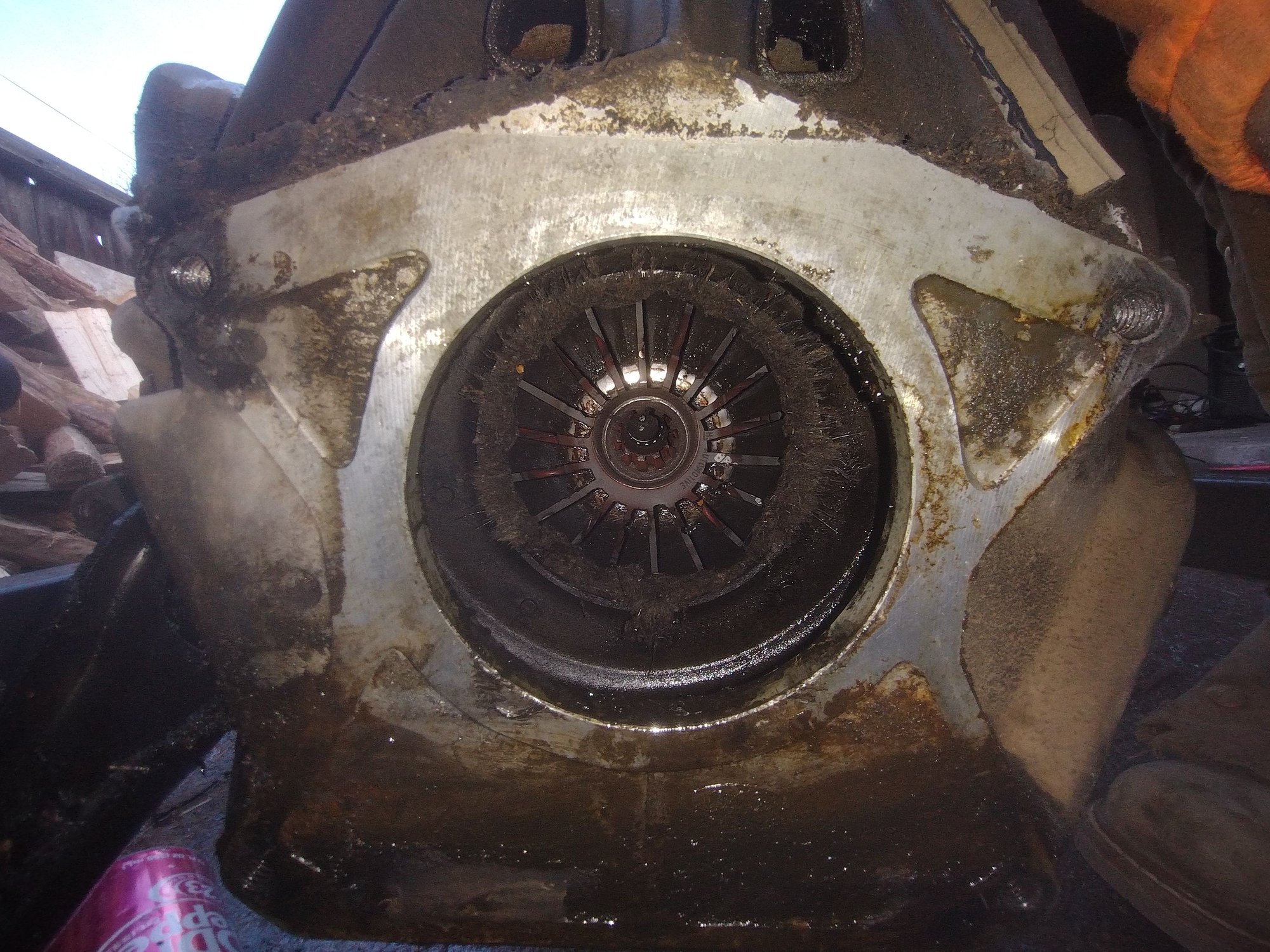

Pulled the motor oil all over the clutch and lots of hair I wanna say. The valve cover seems fine I'm putting the motor on a stand and cleaning it all up today and I'm doing new oil pan and valve cover gaskets. Looks like the front crank seal is leaking also so that's getting fixed also. Is there a seal on the transmission there that could be leaking?

I would do the trans front seal as well while you're in there.

IS it the same type of seal as the crank seals? Do I just remove the bolts and take that cover off swap the seal and bolt the cover back on or do I need to tear the tranny apart?

That little paper gasket was shredded I believe it was the cause of the leak as well since the splines we're dry and even a little rusty, the rubber seal seals the shaft and the paper gasket seals the housing. I'm glad you said something about the gasket I had just made one I was going to use. I'll buy the Ford replacement. I think that was my whole leak judging from the condition of the gasket, the color of the oil, the way the oil flung around it was mostly the transmission side. I'm going to put a drill on the oil pump and spin it to schedule for leaks but the rear main appears to be in really good condition and not leaking. I'll change it anyway but it looks like you either have to open the block or lunch a couple holes in the gasket to work it out. Is that the way or am I missing something.
