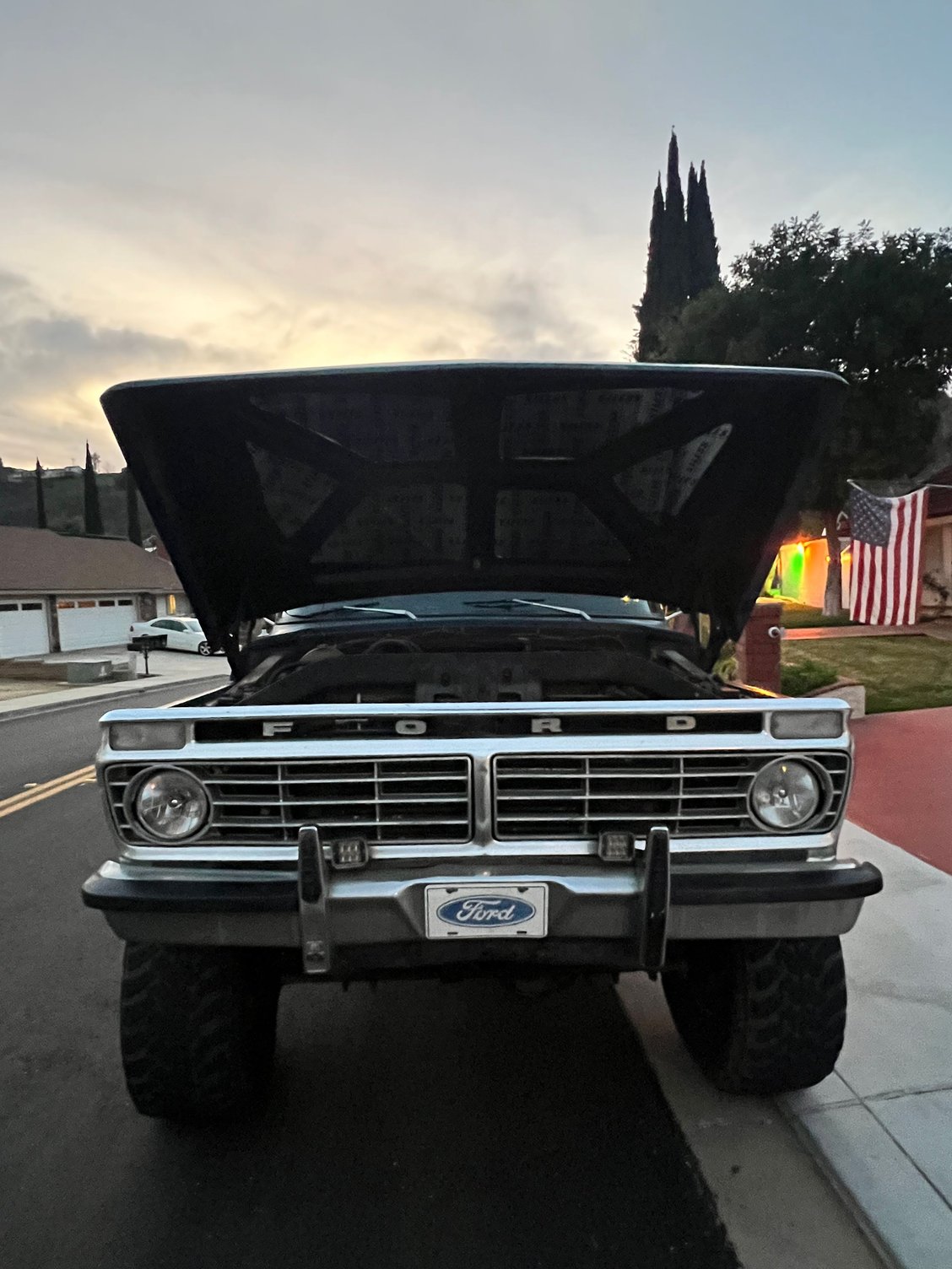

Anyone used this? My 5.9 cummins will rattle your brains out on longer drives. I have a 1/2 liner on the firewall in the engine bay and that did make a difference but i feel like the hood is a giant echo chamber.

My 99 Dodge 24valve has a liner on the underside of the hood. So I would say adding one to your Ford hood might help a little, I do not think it will make it worse. You can do a double lining. 1st layer idea below, followed by the other 2 pics. Other wise turn up the radio.

My 99 Dodge 24valve has a liner on the underside of the hood. So I would say adding one to your Ford hood might help a little, I do not think it will make it worse. You can do a double lining. 1st layer idea below. Other wise turn up the radio.
Before I add an acoustic liner I added some of this for the vibration and actually is a noticeable difference.

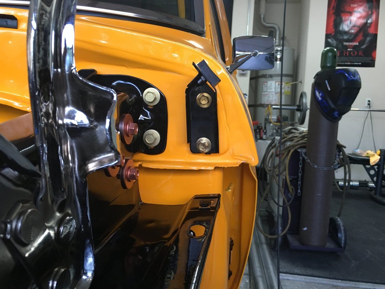

Here is the best thing for hood vibration. 67-79 F600 hood stabilizers.

I was gonna say I didn't think under hood insulation would make a huge difference in the cab, but i guess it does.
12v's gonna rattle. My 95 dodge just had a 4" straight pipe and BHAF, even with all kinds of factory sound deadening it was still loud AF going down the highway. I don't think I ever had the radio below half volume. I've seen guys use that acoustic pad on the oil pan, tappet cover and valve covers to kill some drone. One guy laid a thick piece of fiberglass bat over the whole engine. Do you still have the original tappet insulation? Mine was soaked in oil and falling apart, so i took it off and it was noticeably louder. Have you done the inside of the cab with that padding yet?

same deal here with the tappet cover. Oil soaked so I tossed it. Def got louder. Haven’t finished padding the cab yet. Considering putting a strip of that dense sound absorber on the oil pan.

I'd be tempted to inject expanding foam in a can into the big void that runs from where the hinges bolt to the hood all the way to the front. Really, why not do it to the entire void between the inner hood structure & outer hood. It would be messy, use the low expanding foam & lots of duct tape to seal seams & holes. Then do the underhood insulation.
If the back side of the inner fenders & fenders are clean, I'd stick a layer or two of Dynamat or a similar product to them as well. Or use one of the spray sound deadeners like Lizard skin.
