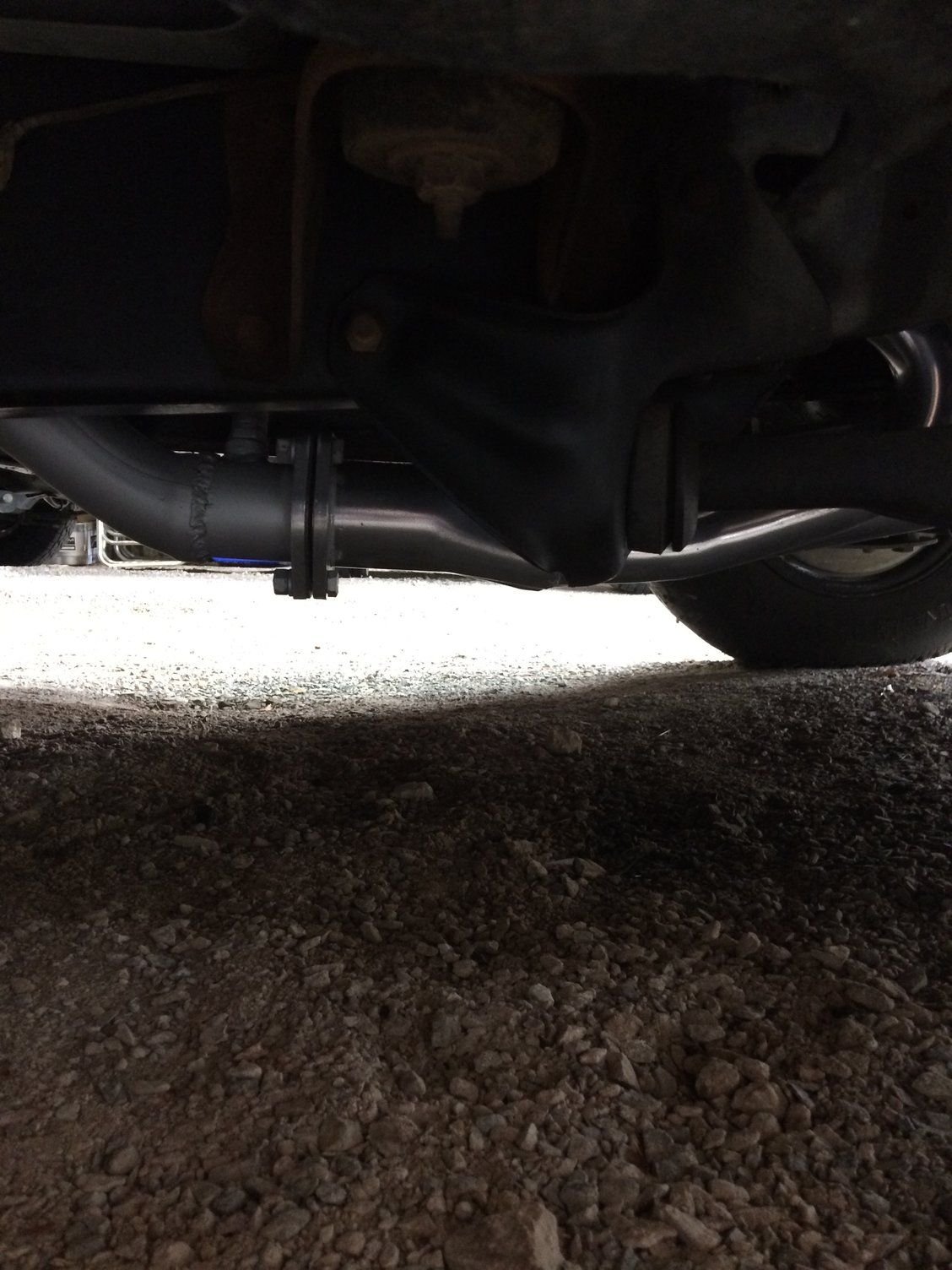

I have a 86 f150 5.0 with long tubes. They were the regular flat black painted Flowtech ones but I took them to get coated before installing. I live about an hour from M&R Coatings so I took them there. Here’s their website:
https://www.header-coatings.com/
They guaranteed them not to turn colors and I’ve had them for 4or 5 years now and they look like the day I installed them. As mentioned already they do take a way some clearance.
Bent down looking from passenger side
To install them I raised the truck high as possible and brought them up from underneath and have some help. My oldest son was under the truck sending them up and me and my younger son were over top lining them up and bolting them on. Use several rags or old towels to pad the surroundings to keep from scratching them.
