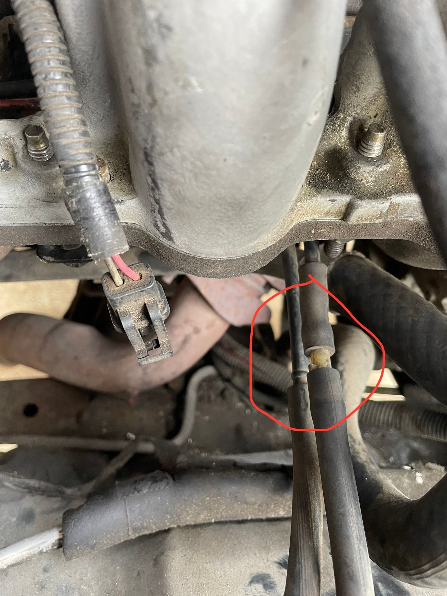

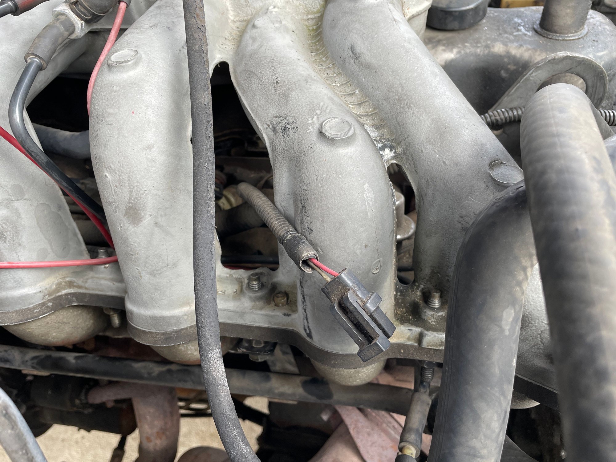

My basket case of an F150 is starting to come along nicely. It looks that I’ve figured out my vacuum line routing, though some will have to be replaced.
my issue now is I have a connector on the manifold side of the engine on my 94 4.9L. Any help with what it connect to would be appreciated.

That is the connector for the Vapor canister purge that has a vacuum line attached to it going to the vapor canister and the PCV. on my 7.5. Yours may connect somewhere other than the PCV on the 4.9.

Where is the sensor located? I ask because I traced the vacuum from the PCV valve to the intake manifold and don’t see a sensor. I’m wondering if it is yet another item that is missing from this truck.

Yup, almost positive it is missing. Tracing the line from the charcoal canister it goes straight to the throttle body.

If the connector is just hanging there like in your pic then it is missing, If you have the vacuum hose there then you can cut it and install the solenoid. At least that is how mine is on the 7.5 motor

It looks like I won’t even have to cut the vacuum line. From what it looks like to me someone just removed it and put a piece of plastic tubing in its place.

Sure looks that way. I put a pic of the Purge canister solenoid in my last post.
