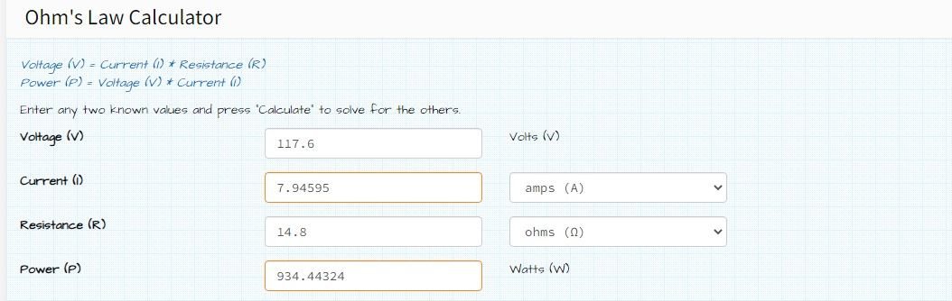

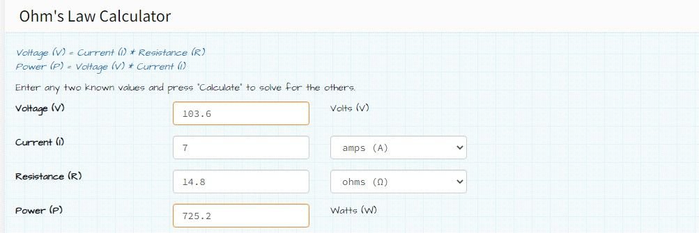

Checked mine, I measured just under 8 amps and 117.6 volts at the load, resistance was 14.8 cold. Which means it is producing 934 watts of heat. The OP states his amps are only 7 which, if his resistance is the same as mine, is only producing 725 watts. See pics. My suggestion, check voltage at the load and verify that the 7 amps is accurate, even a half amp can make a sizeable difference. Also check the resistance of your element. If voltage is low at the load (while energized) look at things like undersized extension cord or outlet being a long ways from the service, or something else on the same circuit taking power. If the circuit/cord is long you are adding resistance and paying for electricity that is being wasted in heat produced along the circuit and cord instead of in the element. It is important to measure at the load, if you measure at the beginning of the circuit you will be measuring the total draw of the circuit + the load with no way to tell how much is making it to the load.
Mine
OP's

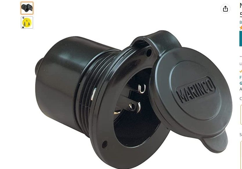

I got rid of my cord and installed a Marinco power inlet in the bumper. As far as the windshield, when I used to park outside I just put a cover over it at night, even an old floor mat or some carpet will work. Although not a lot of frost in the part of Arizona I'm in.
