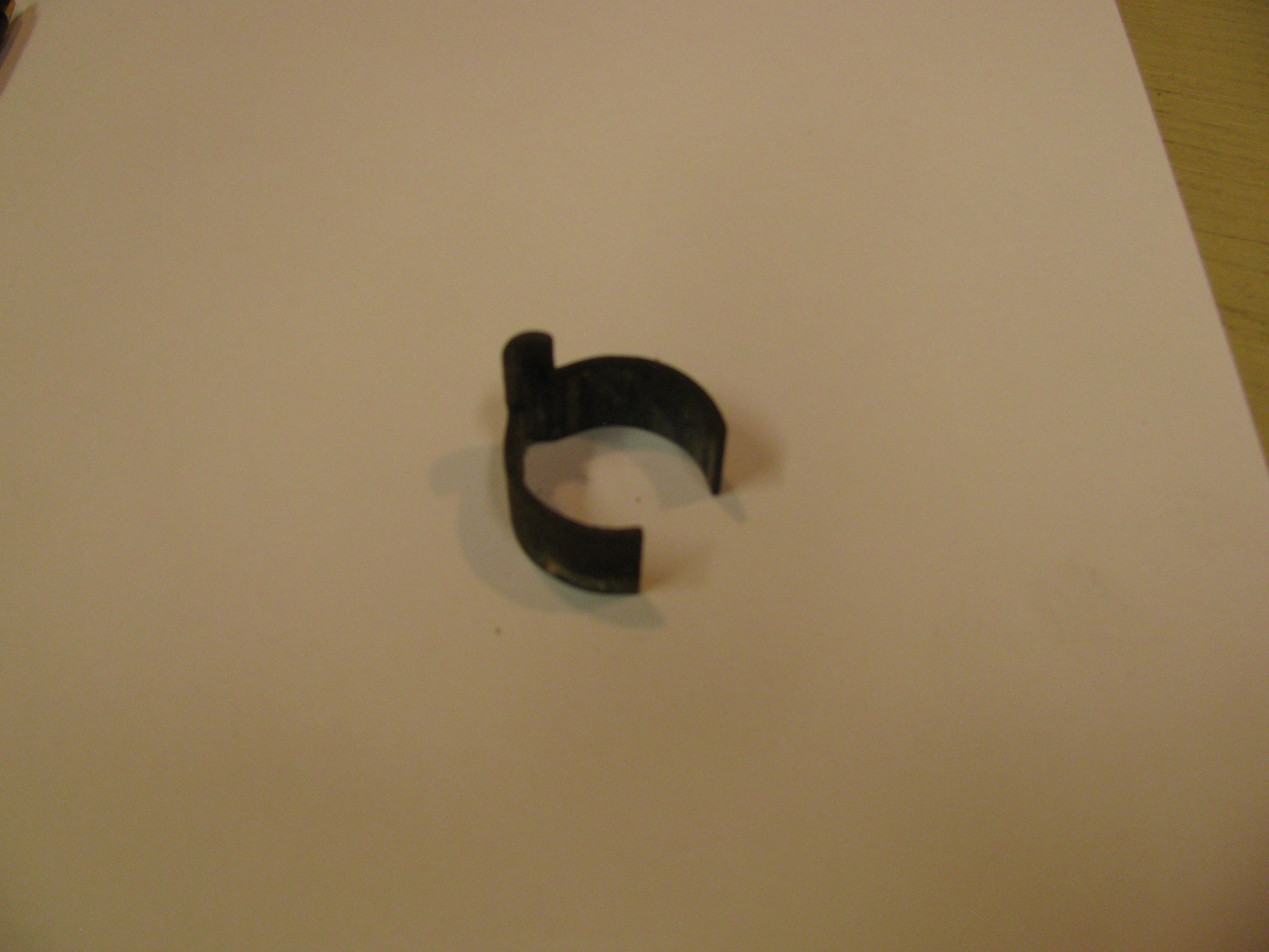

Mikey, after replacing two Chinese turn signal switches back to back, I was looking through an old work phone book and came across a place I used to use called "She-Mar". My phone book entry simply said, She-Mar, turn signals. I called them, they were still in business with the same quality product. I ordered one for my 65, paid around twice as much as the Chinese ones, but I suppose it's been in the truck for at least two years. Daily driver, and I use my signals.
however, I was looking at an original steering wheel I have a while ago and noticed the roll pin, or I guess maybe the clip you guys were discussing, and I remembered seeing a roll pin in the install kit for the same brand of aftermarket steering wheel I have. So I pulled the wheel, found holes for said roll pin, and installed the cancel pin. In Finally for the first time I had self cancelling, working turn signals in my truck. Unfortunately I had been manually cancelling the signals for long enough for it to become second nature and I cancelled at the wrong time, twice, and broke off both cancel levers within a week 🙄.
Have not fixed that again.

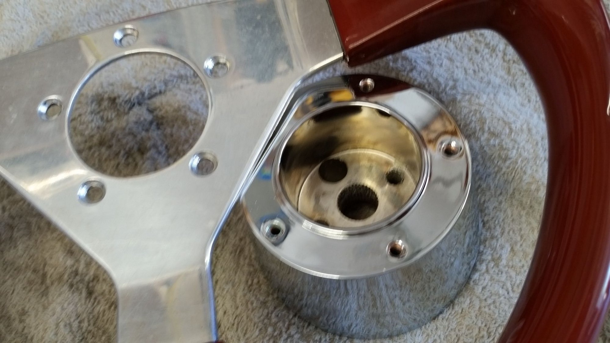

I kept the steering wheel that was installed when I bought the truck - it's a 13.75" Grant, close to their part #737 F/X. I was looking to go to the original 4-spoke style for the 4x4, but learned they were unobtainium, as are the TSS for 4x4. I wasn't inspired by any other wheel I saw, so just kept with the Grant. Works great with the power steering - otherwise would be unobsteeringum. I purchased one of the IDIDIT spacers to work with the Grant and get the distance I needed. Also purchased a Ford branded horn button. Looking at photos, I remember I had to chamfer the backside of the steering wheel just a hair to fit the diameter of the spacer.
Original column
IDIDIT Column
Spacer and wheel after a bit of bench work to chamfer the wheel ID
