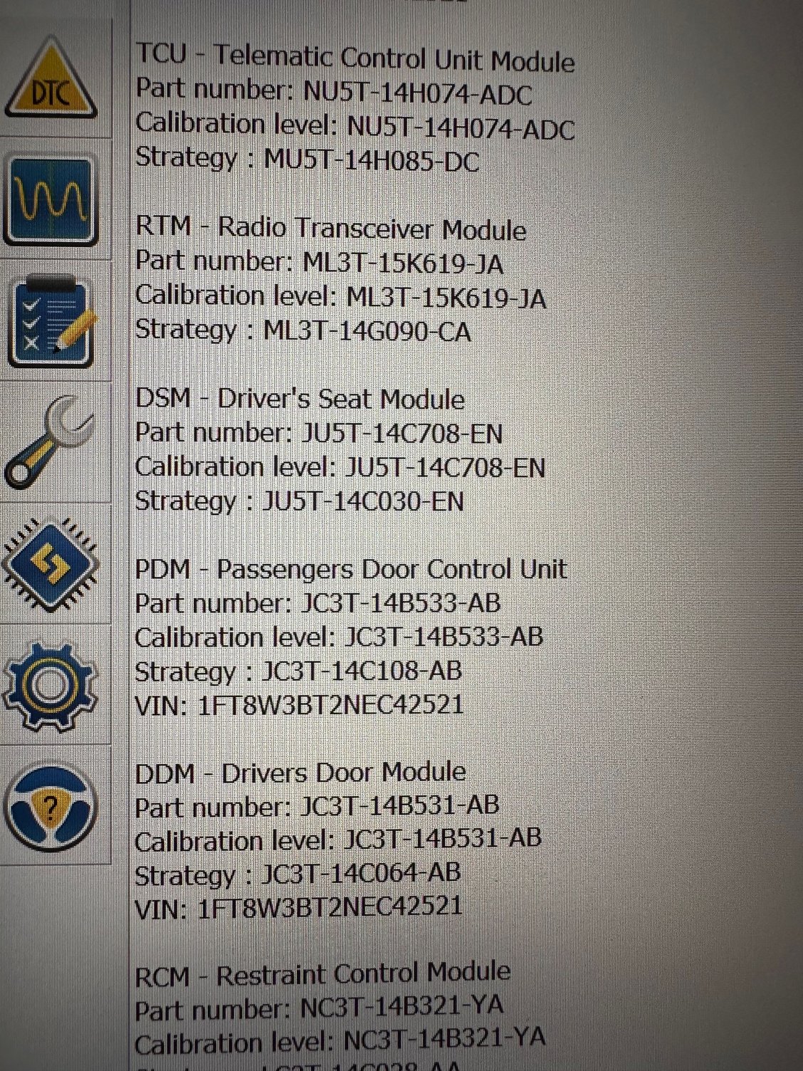

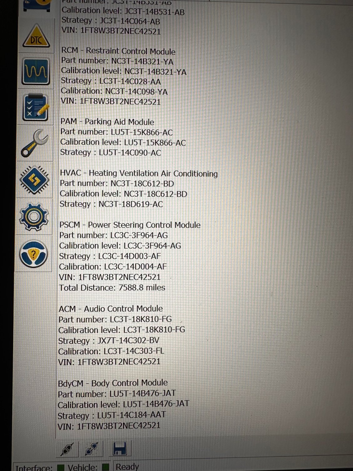

@ZooDad here’s my current calibrations. I’d like to see the calibrations from people who are having issues
@JHForman812 thanks for the screenshots. I am grabbing the info from the VINs we have been provided and putting them into a spreadsheet

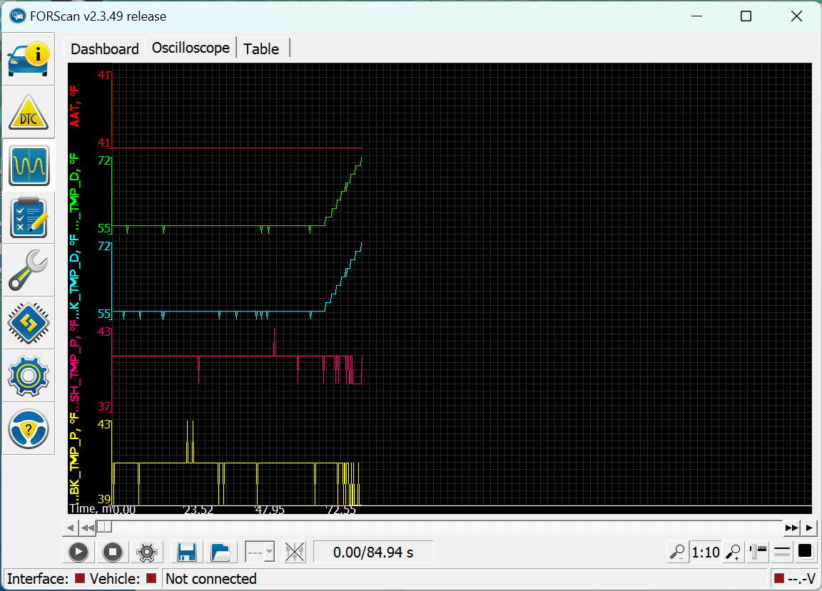

ZooDad and I did some test this morning, whereby we changed some settings in the HVAC and APIM module, but unfortunately same result, no seat heat until the PTS is pressed. Ambient air temp was 41*F which is above what the Ford Work Shop manual lists as the trigger threshold (< 32*F) for seat heat. We are going to try again Sunday where ambient air temp is projected to be below <30*F, to rule that threshold out. In any event, screen shot of the test we ran this morning showing driver's and passenger seat heat constant until I hit the PTS, whereby the driver's seat heat then increased.

I have compared (3) trucks @Squanto (working) Yours (Working) and @Svenster SCME (776) modules. All are the values are identical except Yours @JHForman812 is one version back (EL vs EM)
We are trying to confirm actual operation with temp thresholds being met.
I have narrowed down the change to trucks built in early September. That is why we are asking for build dates also now. More data, closer we get. We have reached out to a couple members hopefully they can assist.
