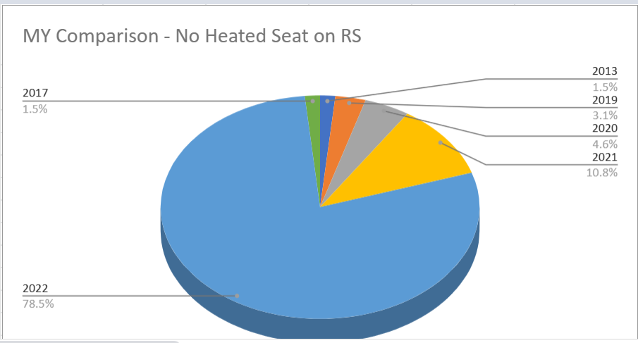

Interesting data points in the attached graph, but of the 66 members that have provided data to me, 78% of the MY22s have reported no seat heat on RS until PTS/key-on. Unfortunately, we need more MY22 VINs that can confirm seat heat on RS prior to PTS/key-on so @ZooDad can compare module firmware and module configurations.
