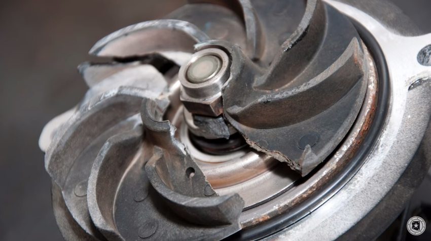

If it is the 6.0 engine the water pump blades are plastic and failure is known issue.

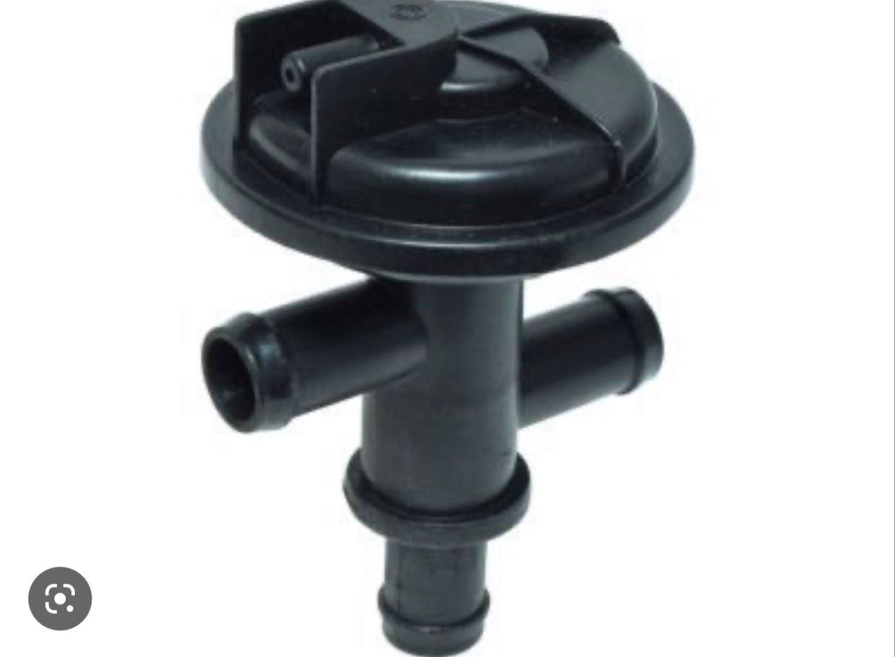

also you mentioned the vacuum valve, just to be clear. The inline shut off valve on the passenger side hose inlet that cuts off hot water supply to the heater core.
