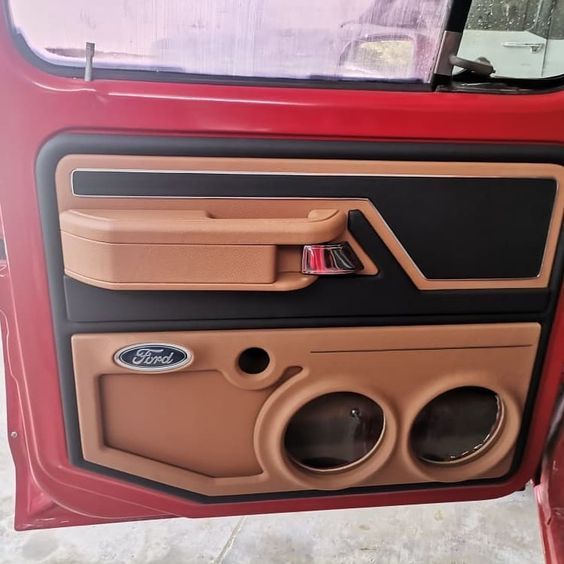

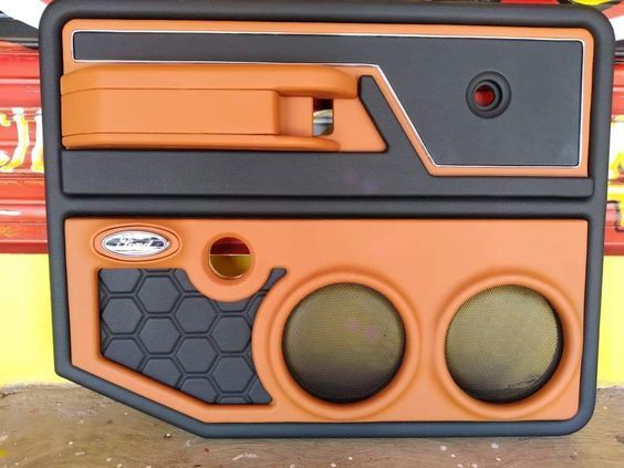

Sorry I do not have a speaker suggestion, I have never seen a speaker hole cut in the door panel that looks nice. Even with a round exterior speaker cover cut to match the contours of the panel in that area. And I have seen it tried with a 6x9 speaker cover, they all look hacked up. Even seen these aftermarket door panel that have a more defined area for the speaker? https://raybuck.com/product/1973-79-...r-panels-pair/
Free cool ideas...
Raptor door panel inspired.

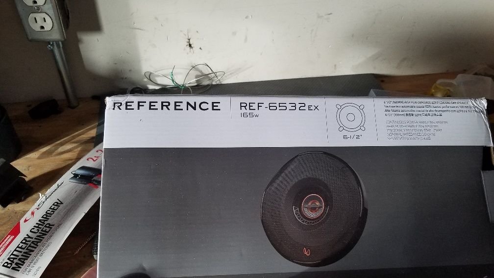

I ordered a set of Infinity Reference 6532EX,, they appear to be a lower profile.

After buying and returning a few speakers i finally installed a set of 6.5 Infinity REF-6532 in the factory door hole. They fit in the opening without interfering with the door panel.
Amazon Amazon
I tried 6x9s below the door panel but they would not sit flush without interfering with the panel.
I also have 6.5s mounted behind the jump seats in the supercab.
Chris
