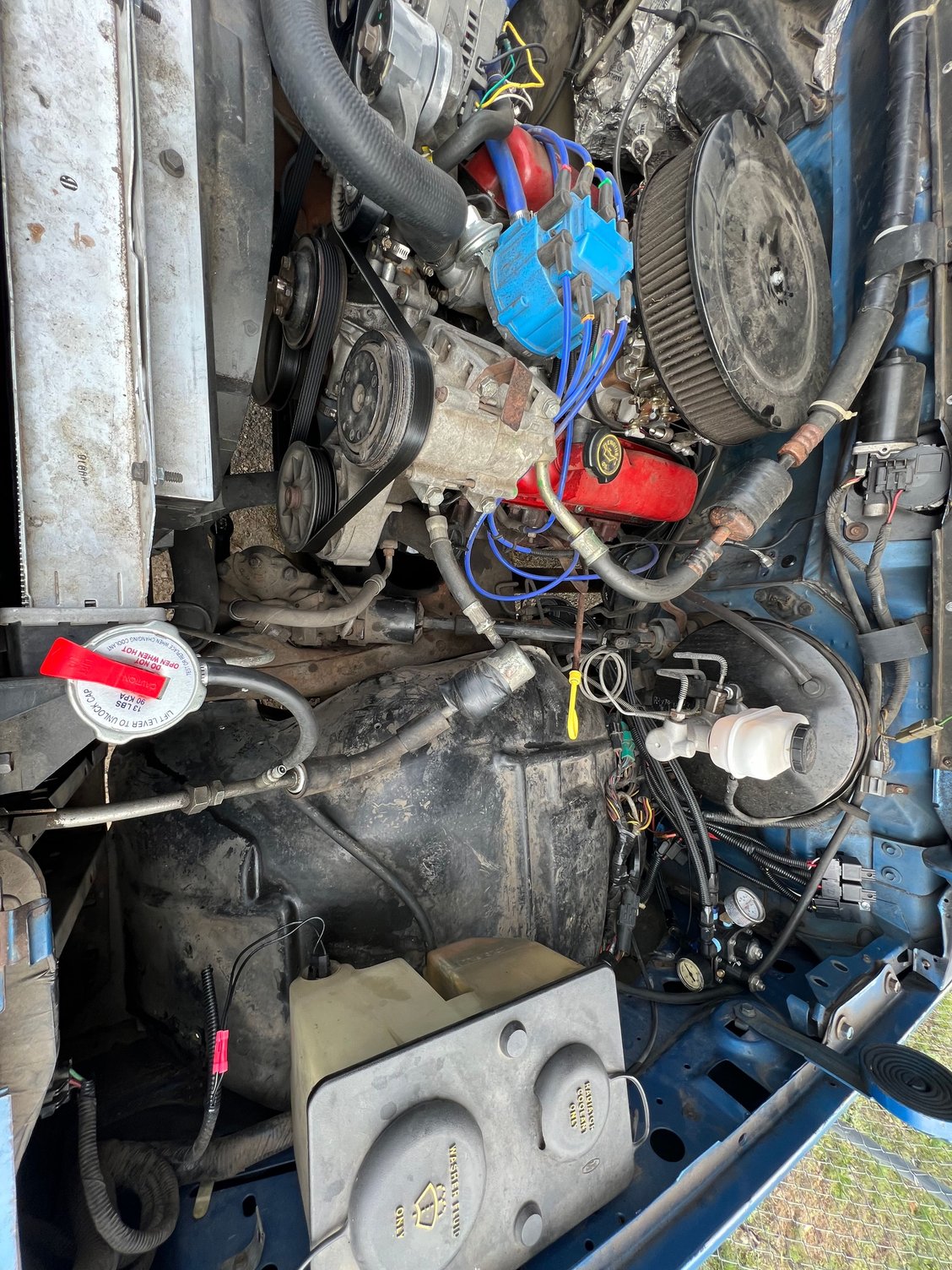

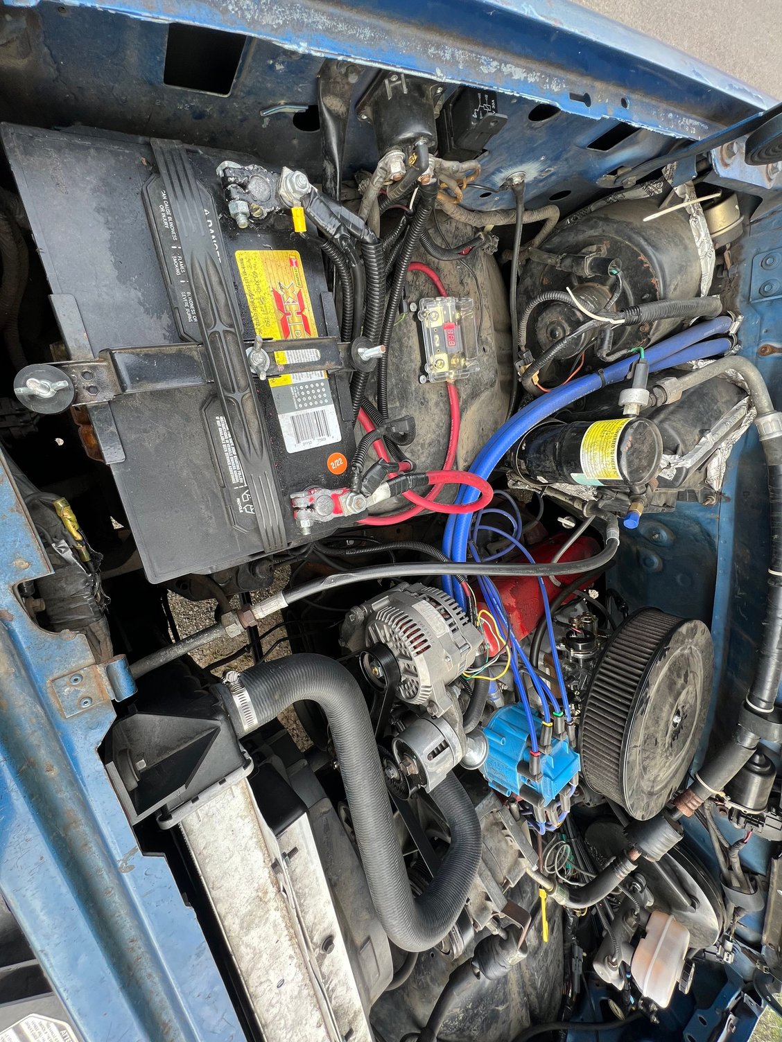

This is the only spot of wires that is concerning to me, some are from the leftover stuff he pulled out of it
I don’t think it’s an improper swap, it ran totally fine for so long, just did an oil change, other then that the only thing’s I’ve done to it have nothing to do with the engine, redid the entire front end (tie rods, rotors, break pads, sway bar link etc) and my ignition switch went out so I put a new ignition switch in it and new tires and I think that’s about it

your carb is brand new, huh? What is the carburetor rated for and what was the original application. because im calling "sus" on that.
Your wording before implied that your truck had a computer controlled system, that was a SIGNIFICANT detail to leave out
Also, your truck is using what is obviously a GM HEI distributor. While I dont care if you do or dont, other people may bully you for it (in my opinion, gm hei better than duraspark ii and simpler)
But that means your distributor is sourced from: (who?) and it was likely made with a very very basic advance curve and it probably has the incorrect gear for being driven on your truck(is the cam a roller cam?)
Who makes the cap and rotor? Did you use thermal paste on the module? Pull the rotor and cap off, show a pic of hte top of your components. whats the vacuum advance doing, hows the vacuum line? which port on the carburetor?
Whats your timing set to? What kind of spark plug did you put in? Whats your altitude? can you get an air filter housing that has a snorkel to run to the core support, you have a hot air intake. Do you have any kind of hot-air-induction system to improve warm up and start up driveability?
Whats the ciondition of the rotor and cap spark contacts?

Yeah, there is a lot going on here...
Your truck was not originally carburetor. There has been a lot of modification to your engine bay mechanical and wiring.
Your idle problem as described still sounds like a problem with the carburetor. The choke or general tune. Do you know what carburetor is installed?
By your HVAC blower (passenger side of the engine bay on the firewall) you have a broken white vacuum line that you should fix.
There are a few companies that make the HEI distributors for Ford small block applications. I used one from Proform with good results.
You would be wise to get a Ford work shop manual for your year model and use it as a guide to sort out all of the electrical modifications and record it all for future reference. You would also be wise to redo a lot of it. It looks pretty sloppy to me.

Also, your driver side valve cover, oil filler port has a port on it that is capped. There should be a breather there. The other valve cover should have a PCV valve in it.
You want a PCV system... without it crankcase pressure will find other ways out.
