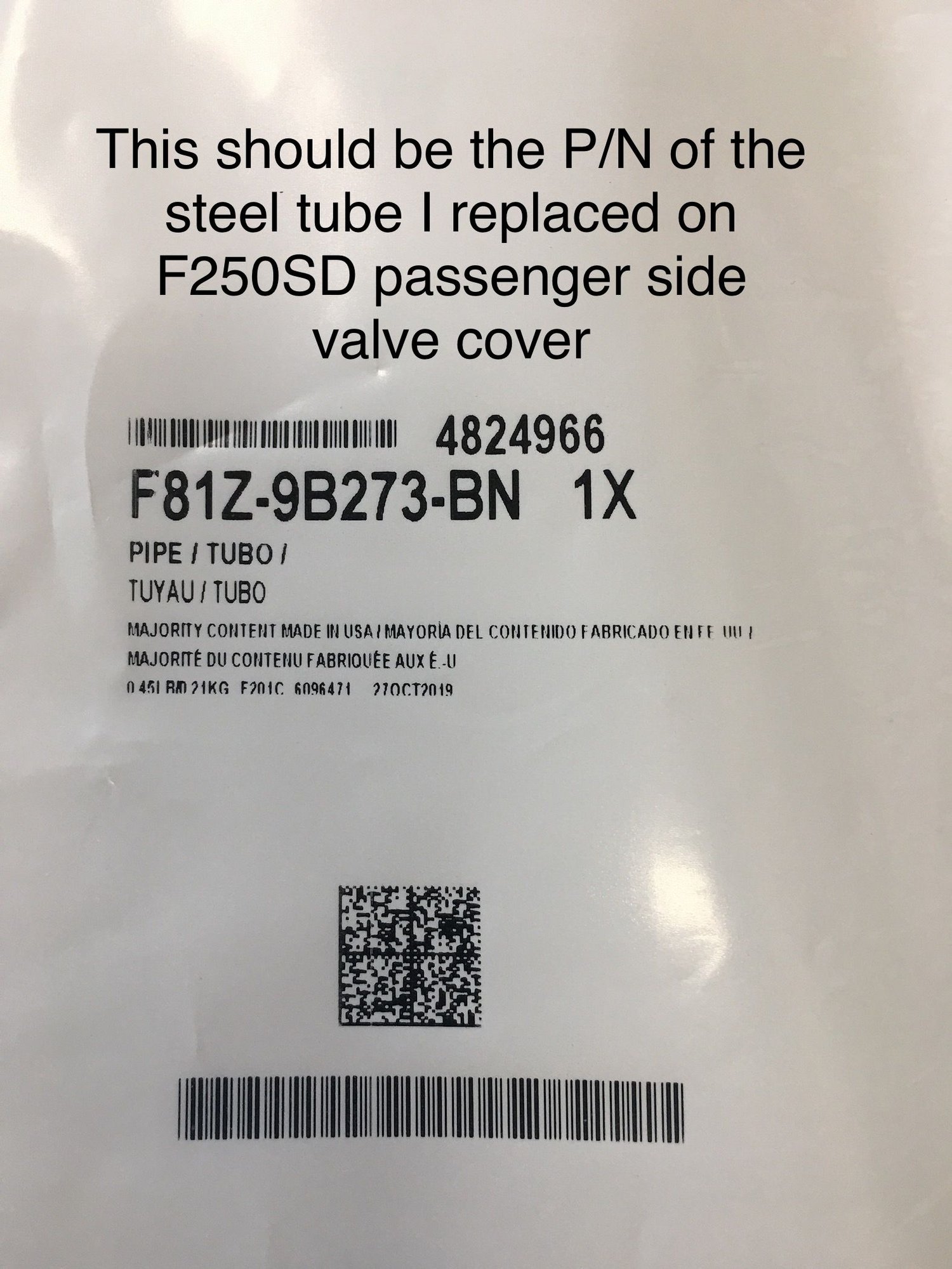

I had exact same Fuel leak at clamp, passenger side. 2000 F250SD 4x4, 7.3PS. R&Red tube from fuel filter to rear of engine block. I left clamp off. Local Ford Dealer had part in stock. Seems like a common problem on Diesels.
Replacement fuel tube from fuel filter to passenger side rear of motor. 2000 F250SD 4x4, 7.3PS. My 1st post, ALL SHARED HOW-TO INFO IS APPRECIATED. I have learned so much here!
