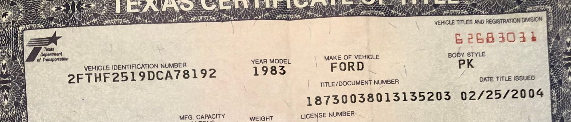

After the F25 is a number one not a letter I. at least in looks line a 1 here's a picture.
Old Nov 15, 2022 | 06:46 PM
daniel3r's Avatar
daniel3r
7th Gear
Joined: Feb 2018
Posts: 7
There's no letter after the F25 only numbers?

The previous poster made a typo. The number 1 is a diesel engine. Check these links out.

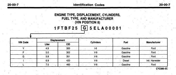

Engine code 1 is the 6.9 diesel.
There is no "I" engine code.
The 351 for that model year would be code "G".
Old Nov 15, 2022 | 07:33 PM
Rembrant's Avatar
Rembrant
Joined: Jul 2003
Posts: 1,844
Likes: 129
From: Atlantic Canada
I was going by my 1984 Factory Service Manual. It shows the 6.9 as the letter "I".
I checked my 1985 Factory Service Manual, and it is shown as an I also. I usually reference these before anything else, and I'm not a diesel guy, so if it's supposed to be the number 1, my bad.
