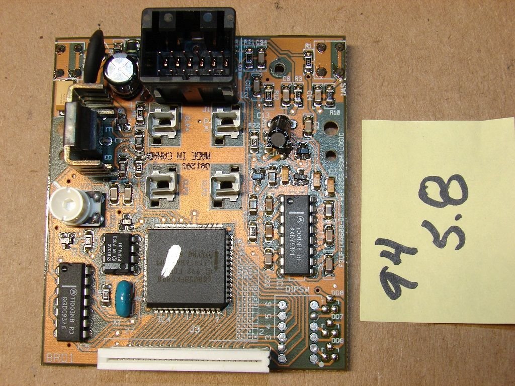

You can remove the PSOM on the back of the original speedometer & plug the whole thing into a replacement cluster if they are compatible & the mileage goes with it.
The odometer count is resident on a chip & sometimes given the right skill, can be moved to another PSOM board if the original is not repairable.
You'll see 2 big can style capacitors on the board that sometimes leak just as bad as ECU caps, but can be replaced with a modicum of success.

The critical component of the PSOM board is the 8 pin chip to the left of the processor in the above pic.
When all else fails, it can be carefully removed and installed onto a new PSOM board, which will then bring your mileage along with it.
But it sounds like you have bigger problems if other gauges are also misbehaving- the PSOM only does the speedo and odometer.
