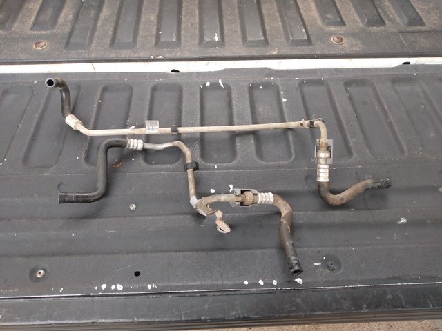

There has been a lot of discussion on other forums and YouTube about this. Some others and I didn't go back with factory replacements because it is just asking for the same problems down the road.
Instead, I cut the hose crimp and pealed it off the rubber hose ends where the main lines come toward and ends below the passenger side of the engine. Pulled those hoses off along with that entire set up to the radiator. Replaced both sides with 1/2" high pressure hose and hose clamps that runs directly to the radiator on the driver's side and the front cooler on the other. That gets rid of six hose crimps, two quick clips and one expensive nightmare.

I purchased the 1/2" transmission cooler lines from Napa.
At $7.00/foot it's not cheap but it is the best high-pressure lines they have. I ordered 6 feet of hose just to be on the safe side and maybe used 5 to 5 and a half foot of it. The clamp are just regular 3/4" hose clamps (four of them, two doubled up on each of the ends of the steel tubes coming from the transmission). I reused the factory hose clamps from the small cooler and the radiator. In the end, I added back a more than a cup and a half of Mercon LV (that drained from taking off the factory lines) to the transmission with the engine running and transmission hot using that crappy plastic trans dip stick next to the cat as a gauge.
Nbh H1946 | NAPA Auto Parts (napaonline.com)

Just take it slow and easy cutting through these metal compression fittings, then peel off the metal fitting from the rubber hose beneath, slide the hose off the end of the hard line. One side I used a dremel, the other side I used a small handheld electric drill with a cutting wheel. Honestly, it didn't matter which one I used both got the job done.

Shove the new lines as far as they can go trying to get their ends up on to the collars around the hard lines.
That plastic sleeve came off one of the factory lines and I zip tied it surrounding that hose to two points below the radiator.

Thanks. All I can take credit for is doing the job on my truck and passing on the experience. Most importantly, I had some excellent internet conversations from others Gen. 12 F-150 owners bouncing ideas around and taking this old school approach to the transmission lines. The reality is back in the 60's, 70's, 80', 90's, 2000's all of our transmission lines were plumbed with rubber transmission cooler lines up front and most, if not all, connected to steel lines that ran back to the transmission.
The OEM Crown Victoria transmission cooler lines for the 2006 - 2011 is exactly that way.
So why does the #1 truck built in America have this mess to contend with? Engineering for speed in production using the quick clips. Plus, I doubt Ford subcontracted the building of these factory lines out to the highest bidder using quality materials. Ford just replaced its Quality Executive over the number of complaints, class actions, and vehicle recalls.
Attachment 277759
As for the upper right-hand line running from the cooler to the radiator, I haven't replaced it yet. It's just a short piece that looked fine and has hose clamps on each end. But it is a great idea to replace that hose since you're in there anyway and would be so simple to do. 2 minute job while drinking coffee
