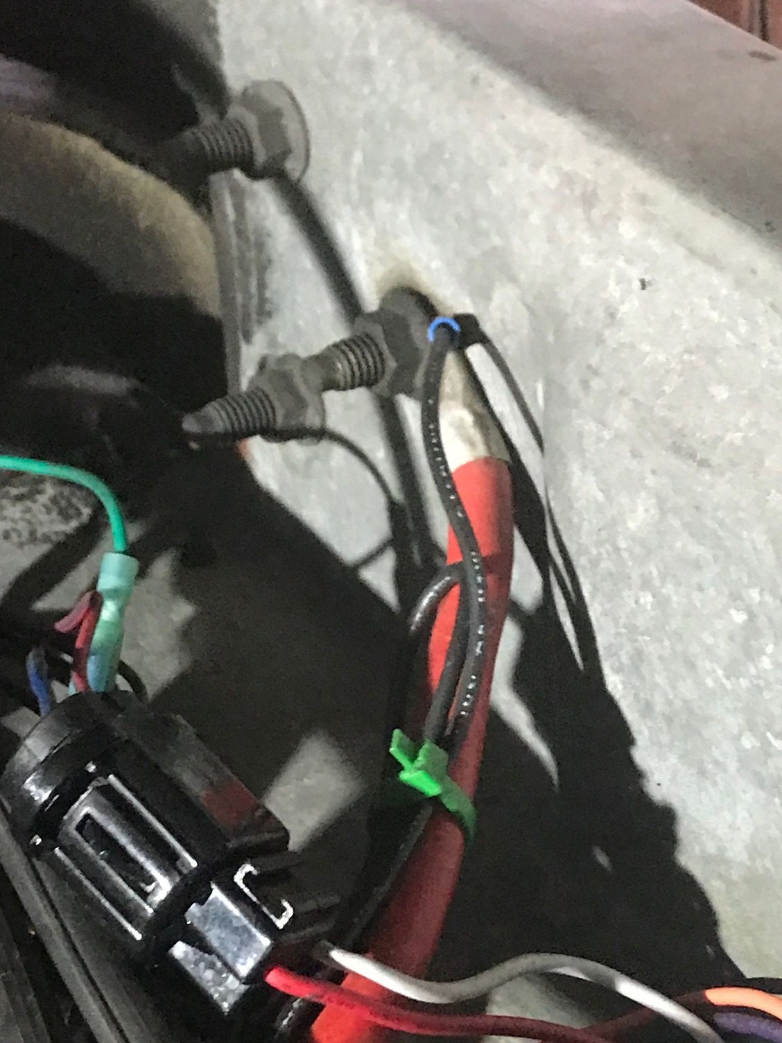

Oh, and where does the other end of the negative battery cable attach?
Engine? Body? Frame?
Thanks

The the negative battery cable is attached to the galvanized fender support structure (the same structure you can see in a previous pic, where one side of the battery hold down is attached). Here's a pic; guess I should have used a black lead, but I had a spare pos battery cable. It's easily traced/visible from the negative post of the battery to the mounting point. I guess I could put a couple of turns of black electrical tape on the red cable, a la the way electricians designate the common white lead as hot for some installations.
