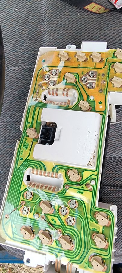

Pulled the cluster out to this... Looks like previous owner let the inside get rained on or spilt their drink. The whole side where the coolant gauge is located is completely rusted and corroded. Does the coolant temp sensor piggy back off the cluster? Is that why the ecm is throwing a coolant temp sensor code with a new motorcraft sensor? I know the vss piggy backs off the speedo for readings. Wonder if this is the same situation.

Nope. The ECU uses a completely different 2-wire temp sensor on the engine. The instrument cluster uses a 1-wire temp sensor.

Posts: 12
Okay, I'll check readings on the sensor itself and come back with some information on that. My cluster being corroded is probably why my vss is acting up though.

From: Mojave, Ca
Could be. You can try disconnecting your abs module behind the glove box to see if that helps your vss signal.
