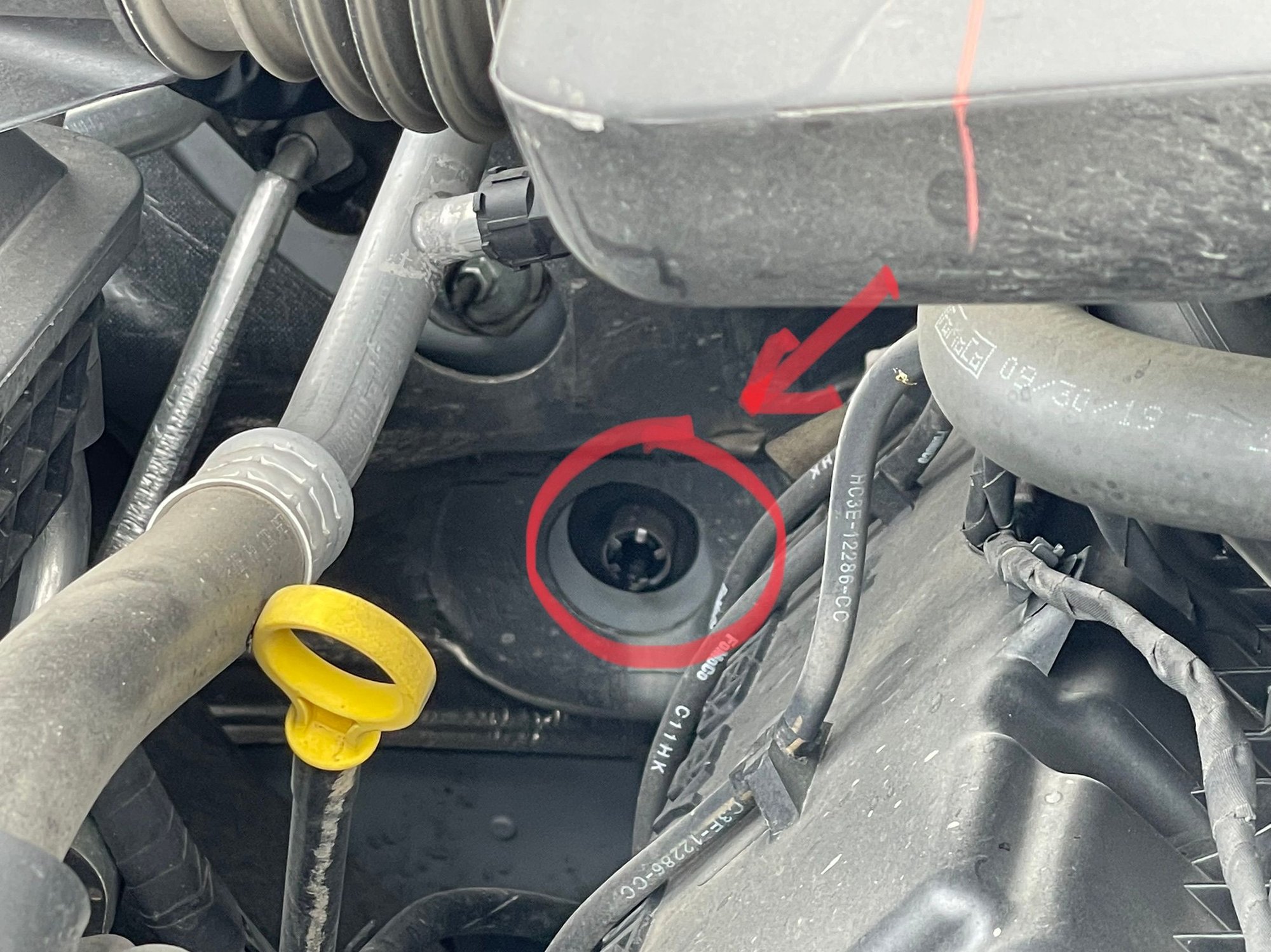

I found that after I stop there’s often some liquid dripping from a black “valve” on the passenger side of the firewall, see photo. It seems to be water, but I’m not sure.
Any idea of what it can be and what causes it?

AC condensation

Yes, the drain for the condensation from the hvac box.

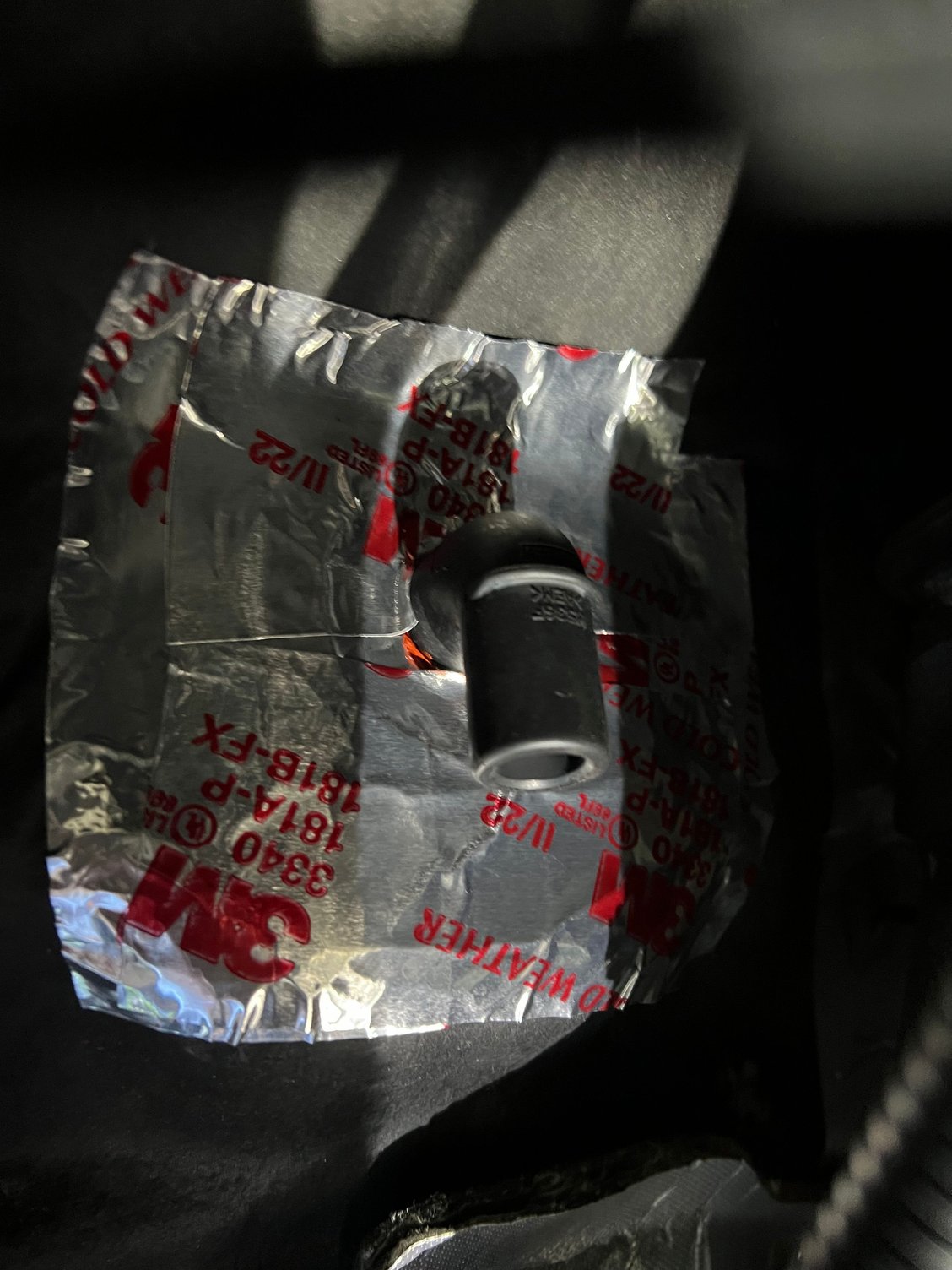

Yep. There is actually a TSB (192345B) out for that for certain trucks. It can be completed with an elbow and some aluminum tape.

So the OP doesn't get confused, the TSB is to fix a specific issue of condensation running back into the cab. What you are seeing, condensation coming out of that tube, is perfectly normal.

Thanks all. I was suspecting that, but in about two years of ownership I never seen any dripping so I was kind of surprised. Maybe it has to do with the fact that I live in Reno (very dry) and last week I was in Olema, on the coast (very humid) which of course made a big difference…

Yep if you find that your passenger floor gets wet, you need the elbow. I bought one to install just because but haven't got around to installing it.

I never had the problem of wet carpets but I had a piece of rubber hose that for over the stub perfectly. Brings it out a bit further from the firewall so I definitely shouldn’t have any issues.
