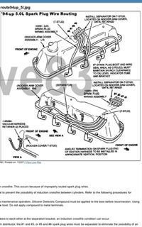

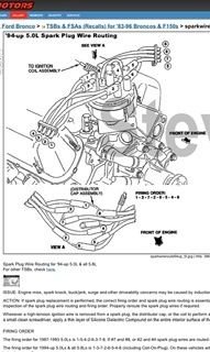

There was a service bulletin about ignition wire crossfire but whatever way you have them now is fine since you said it is no longer misfiring
You could be losing some low end performance because 4” exhaust is is way too big for a stock engine. I am currently replacing the 302 in the pickup mostly because it used a quart every 600-700 miles. I drove it for several years that way.
