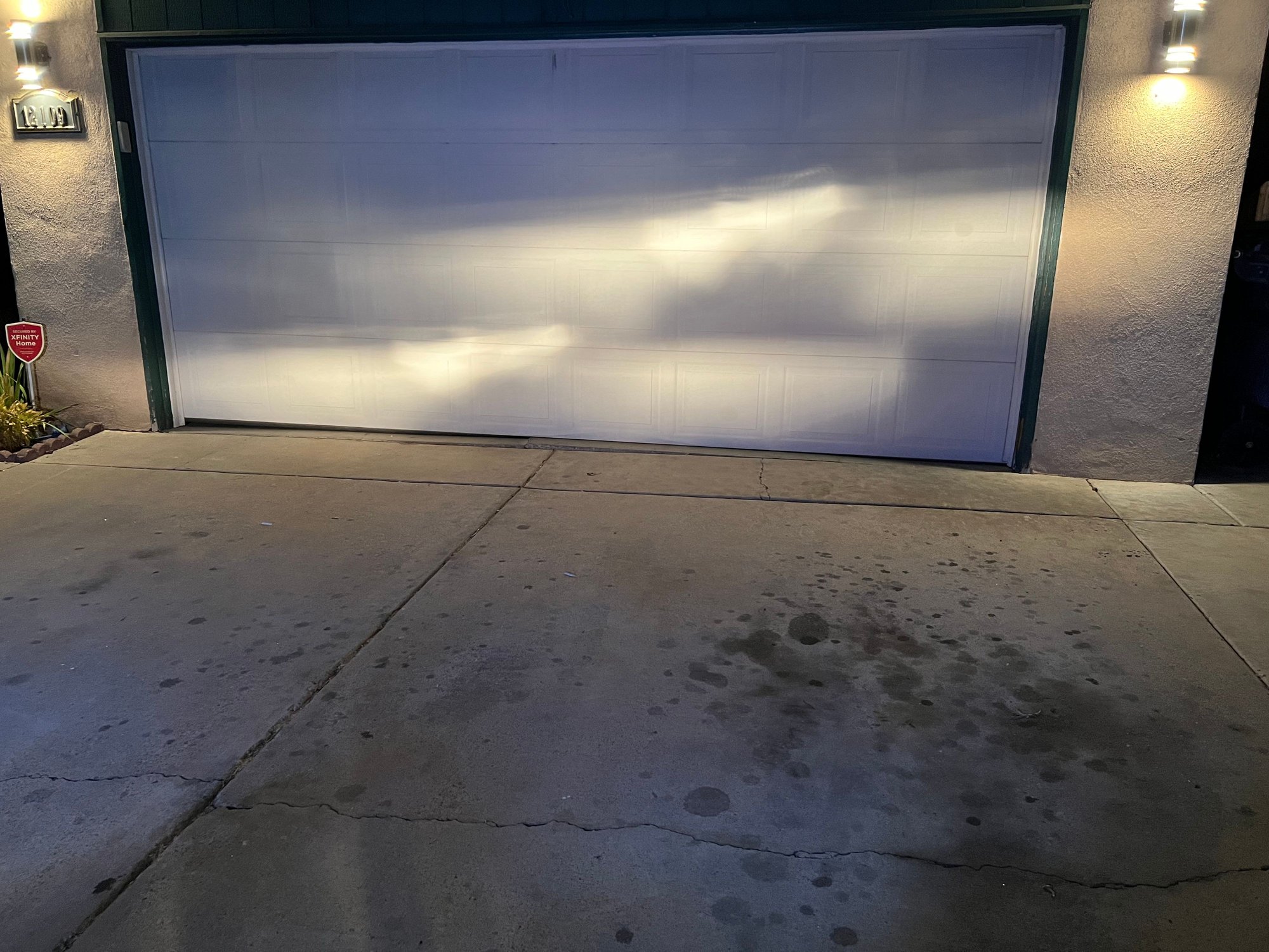

This is the issue and no adjustments working anyhow

So i have been in contact with amarillite, the think the bulb got dislodged somehow, i guess there is a dust cover that i can sccess to reseat the bulb. Will have to wait for the weekend, work gets in the way of all of my hobbies! LOL

If the bulb got dislodged the angle would still move when you tried to adjust it. I bet the adjuster got screwed all the way out off the threaded part. There is a seal on back you can pull off to change bulb. I'd try to look at the adjusters also and see if you can see them there also. Maybe it's a easy fix.
