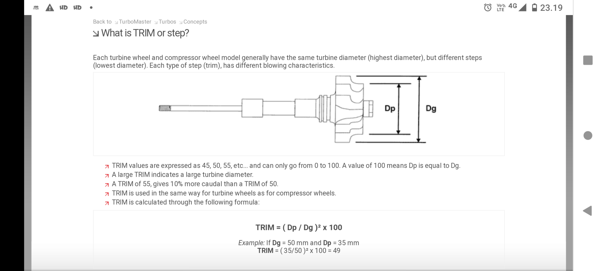

Smaller trim wheel outspools higher trim.
Larger trim outflows smaller trim.
Van 70mm turbine and BW 73mm turbine has higher trim than smaller exducer ones. So smaller turbines spool faster If nothing else changes.

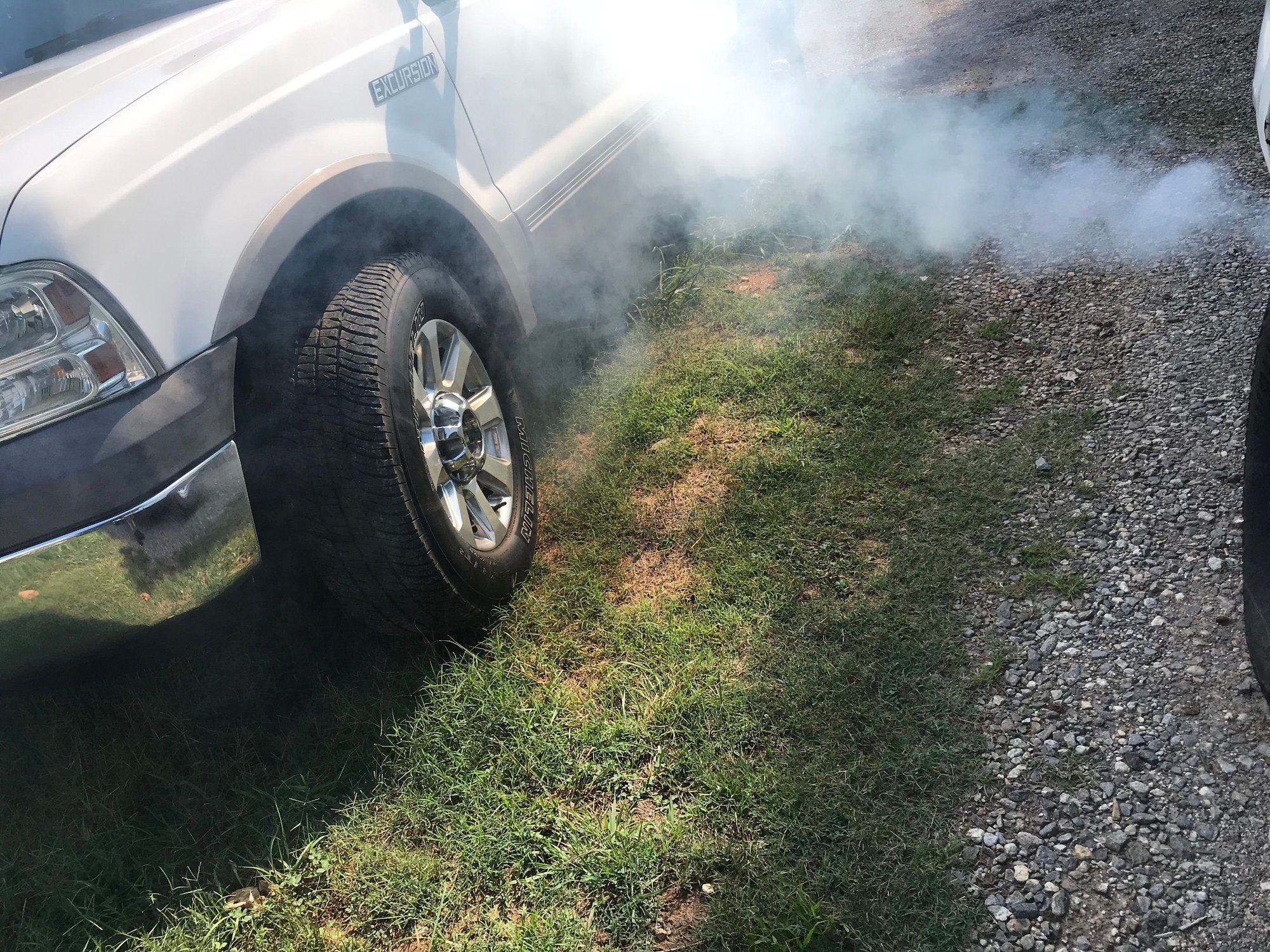

Originally Posted by alaskapilot95
Anyone have experience with unlimited diesel's injectors? The unlimited mile/year warranty is rather tempting.
Garbage. Junk. Worst customer service possible.
The last (3) sets I installed sucked out of the boxes and zero help from UDP. Replaced one set with new AC codes and fixed problems. UDP ‘tested’ the junk injectors and said they were fine. You can 100% expect them to weasel out of any warranty claim. They will blame the truck, the tuning, the installer, the fuel, etc.
This is the ****ty UDP injectors that came in my sweetheart’s ‘new’ truck after a cold start. They told the previous owner to pound sand after reluctantly sending him one replacement that did not solve the problems.
