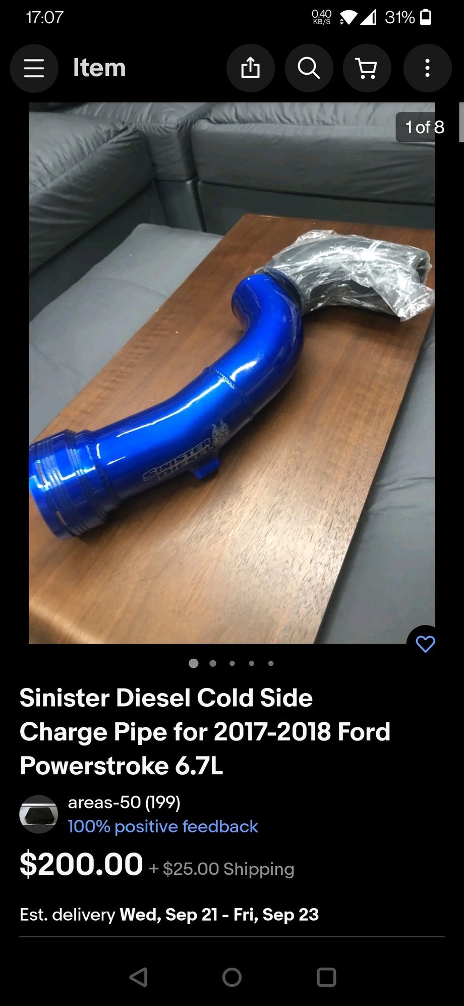

There's not much cheap metal ones on the aftermarket yet for the 2017+. But I did come across this one on ebay.
