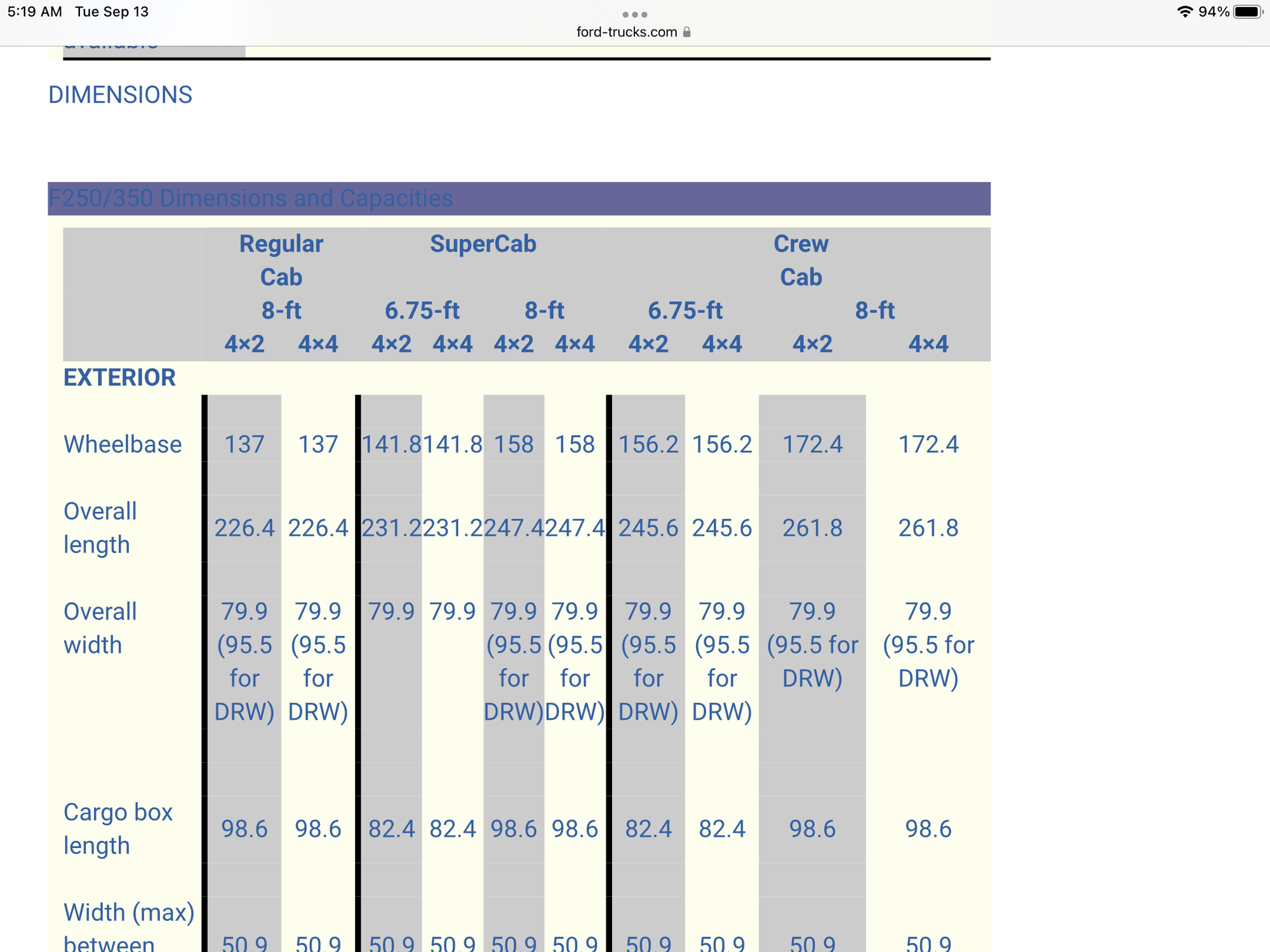

I'm trying to figure out my 06 f250 super cab (w/smaller suicide doors) long bed wheel base so I can order the correct fuel pump. I looked for a tech folder but no luck?

5 senconds on google
And this

Also, you can find it in inches on the door jam sticker towards the bottom left with a "WB" next to it.

However I did put the results of my Google search therefore him. Shows his truck as a 158 inch wheelbase.
