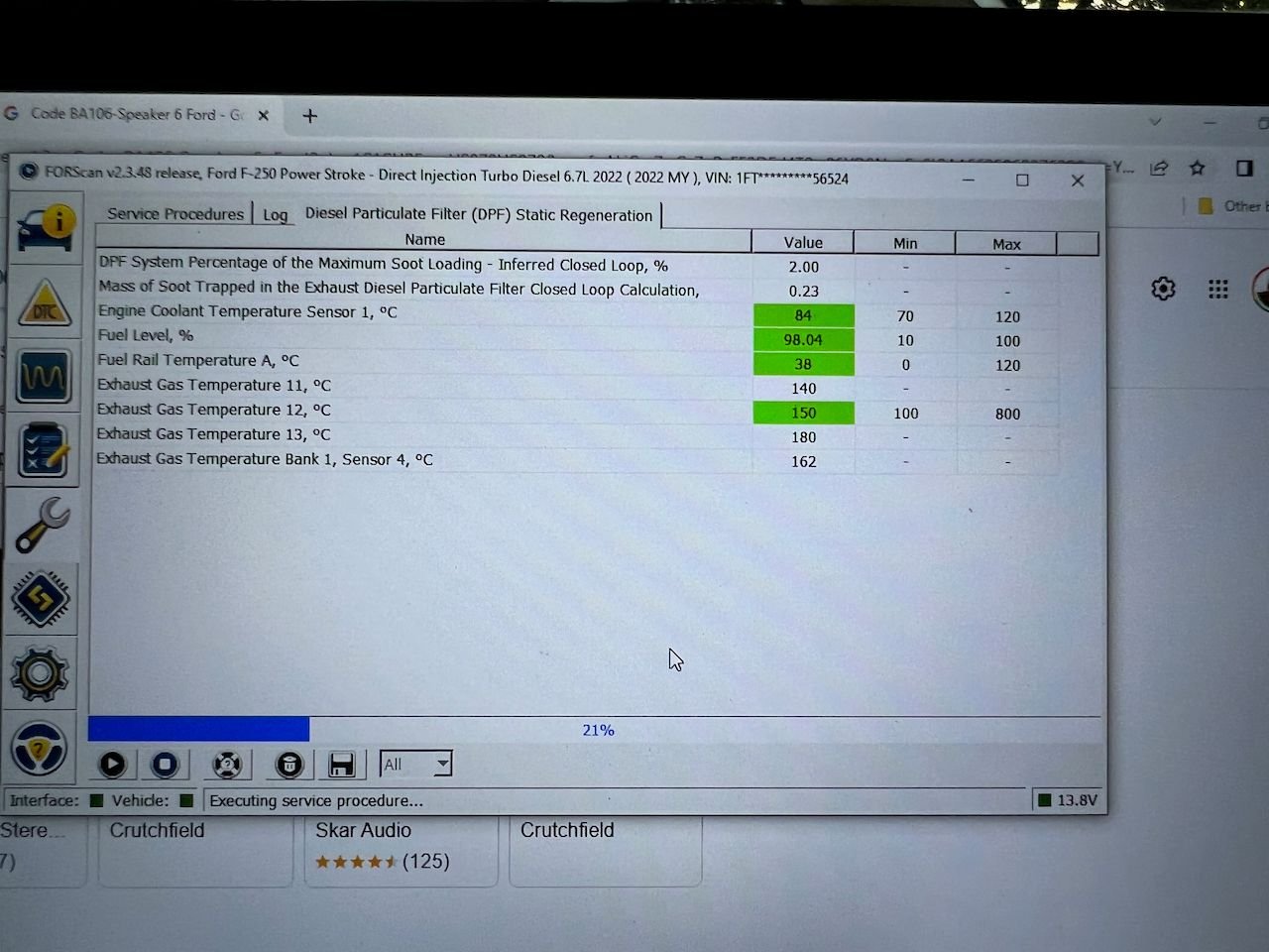

I'm still stuck at 0%. Tailpipe is clean. No codes on the truck, and none when using Forscan or my iDash to scan for them. If you can believe the DEF gauge, there has been no drastic change in its usage. EGT's are all within normal temp range when driving. Fuel usage has not decreased.
I really hope I am just being paranoid, and this isn't something that's building up to something bigger.... but this just doesn't seem right to me.
At this point, I am around 120 or 130 miles since my last regen.
I just went for a 35ish mile drive. The trucks DPF status stayed at 0% the entire time. I was driving slow with some stop and go, and then about 20 miles of 2 lane highway at 56 mph, then about 10 miles of backroads on the way back home. And despite that I have never trusted the "DPF SL" PID on the iDash, I added it back before I left. When I cranked the truck it briefly said 7%, but then fell back to 6%. As I drove those slow 35 or so miles, with EGT's in high 400's and EGT 1 occasionally up to around 525, I watched the DPF SL on the iDash fall down to 2%.
When I got back home I grabbed my computer and hooked the truck to Forscan. According to Forscan, my "DPF System Percentage of the Maximum Soot Loading - Inferred Closed Loop, %" is 2.00 The "Mass of Soot Trapped in the Exhaust Diesel Particulate Filter Closed Loop Calculation" is 0.23. It seems that Forscan agrees with the iDash DPF SL, and being that it is 2%, it may be too low for the truck to move from 0...
I agree... this seems perfect! My truck seems to be going into a passive regen every time I crank it regardless of how it's used. It isn't using any extra fuel or DEF or throwing codes... Nothing sounds funny, the truck doesn't run any different, it's great in fact, the pipes are clean, no smoke... nothing glaringly wrong.
But it still doesn't seem right to me. I'm getting paranoid and anticipating something to come. Why is it being so "perfect" all of a sudden? Is the Better Diesel FBC that I have been using along with the Hot Shots EDT all of a sudden making the fuel burn perfectly clean? Or is a sensor acting up somewhere and it's just not being read accurately?
Over the last 13000 miles, it has never taken more than a few miles after a regen to move from 0% to 5%. And yes, I do watch mine. I will actually keep my Auto Regen turned off and watch my DPF% climb. Once it's around 90% I start planning a long drive so I can turn it back on, let it actively regen back down to 0%, and then turn it back off and start over.
So how long do I wait to figure out my next step? What if the DPF% doesn't change for a month? Do I still just be happy about it? I do have a 800-ish mile trip coming up in a few weeks that we will be towing our camper, so I know that when that happens, it will definitely drop back to 0% (if it isn't still there) and stay there while towing...
I'm at a loss... I want to be excited, but I can't be...
Photo of the DPF status in Forscan.

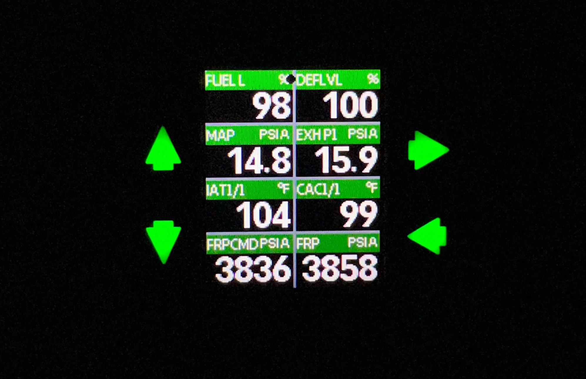

Also to add, I added the Manifold Absolute Pressure and the Exhaust Back Pressure PID to my iDash. From what I have read they should be similar?
Engine idling.

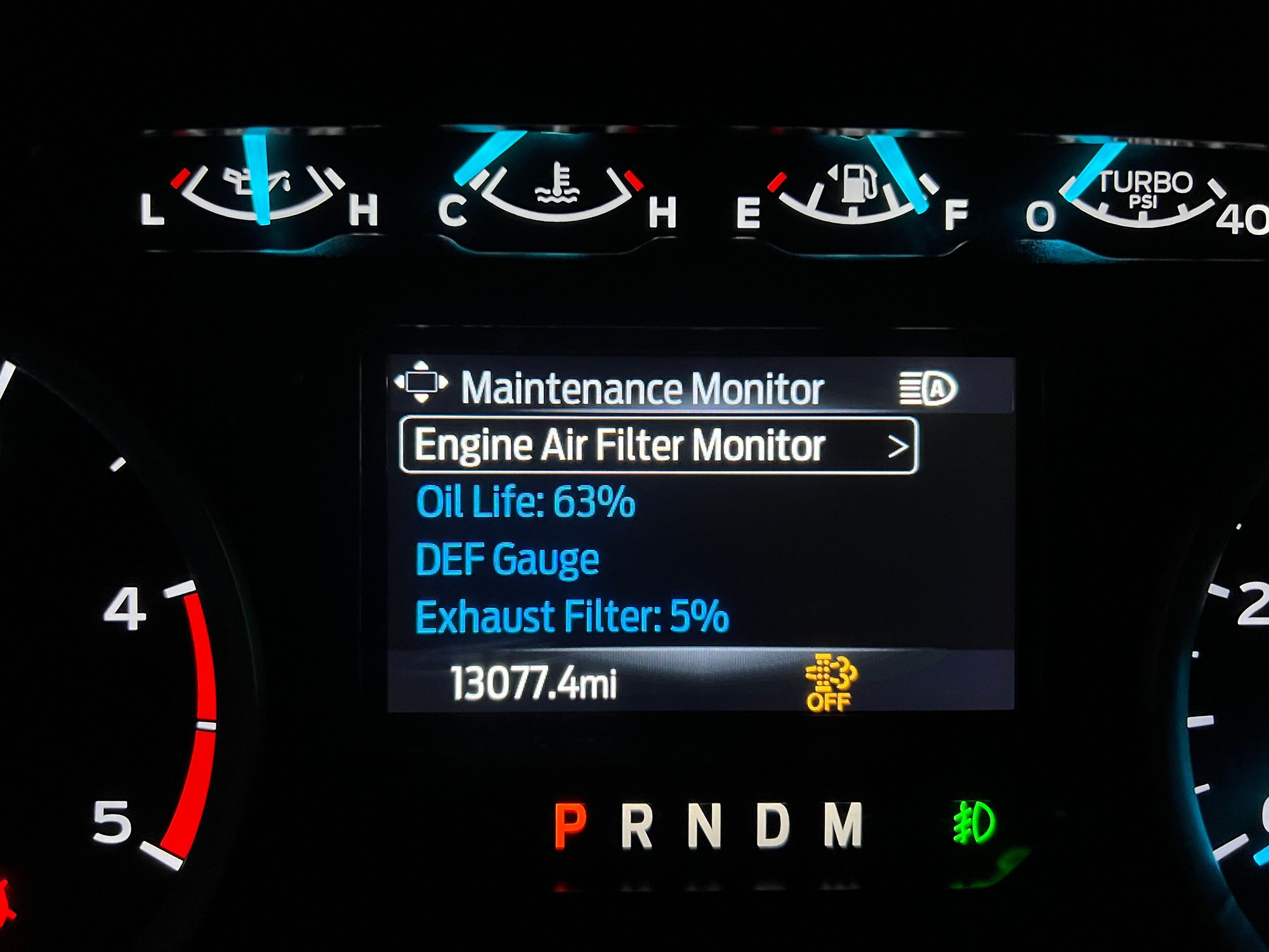

I figure there will be a few “I told you so’s”… and I’m fine with that. My DPF climbed to 5% this morning! That’s sure does make me feel better. It’s still strange to me that it took this long but at least it’s moving again!

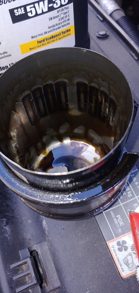

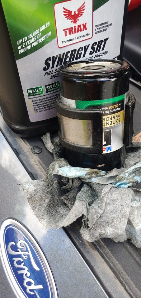

Hey for schitts and giggles, I'll just throw this out there. I use these on my oil filter. I have plans to buy an industrial one for my oil bypass filter. Overkill...
And while I realize aluminum is not magnetic, it may pick up very small metallic particles in the fuel since you using the 2.1 version with the spin on filter. I've been using them since they first came out.
