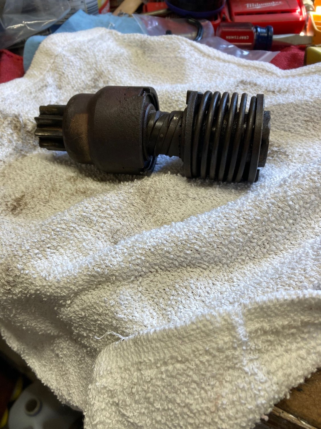

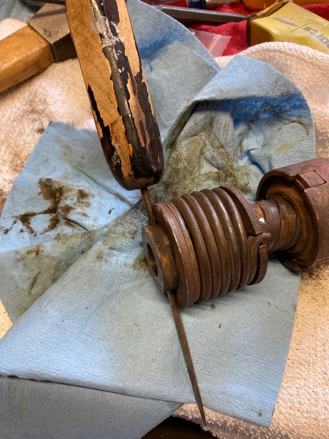

got the truck up in the air and tried to figure out whats going on with the starter. I hooked my jump box up to the starter so I could be under the truck to see whats going on. The starter spins quickly but the Bendix never goes in. Looking in the shop manual it shows a roll pin where mine has a cotter pin holding the assembly in place. I guess its been this way for 25 years since I've had the truck 15 and it sat for 10+ before I got it. I removed the cotter and got the assembly out on the bench. I noticed a hole in the rod and one of the pictures shows where I put an ice pin thru it. This not where the cotter was holding things in place, should it have been? Seems crazy since its never happened before. I've sprayed with brake clean to degrease, I looked up in side the where the bendix was and the flywheel looks ok. I did notice the screw type threads on the bendix look a little rough in places. I thought I had a old spare Starter but find out I have about 4 old Generators including a Flathead style. If anyone needs an old Generator let me know since I have a GM 12 volt Alternator.
Ideas are appreciated on how to proceed.
