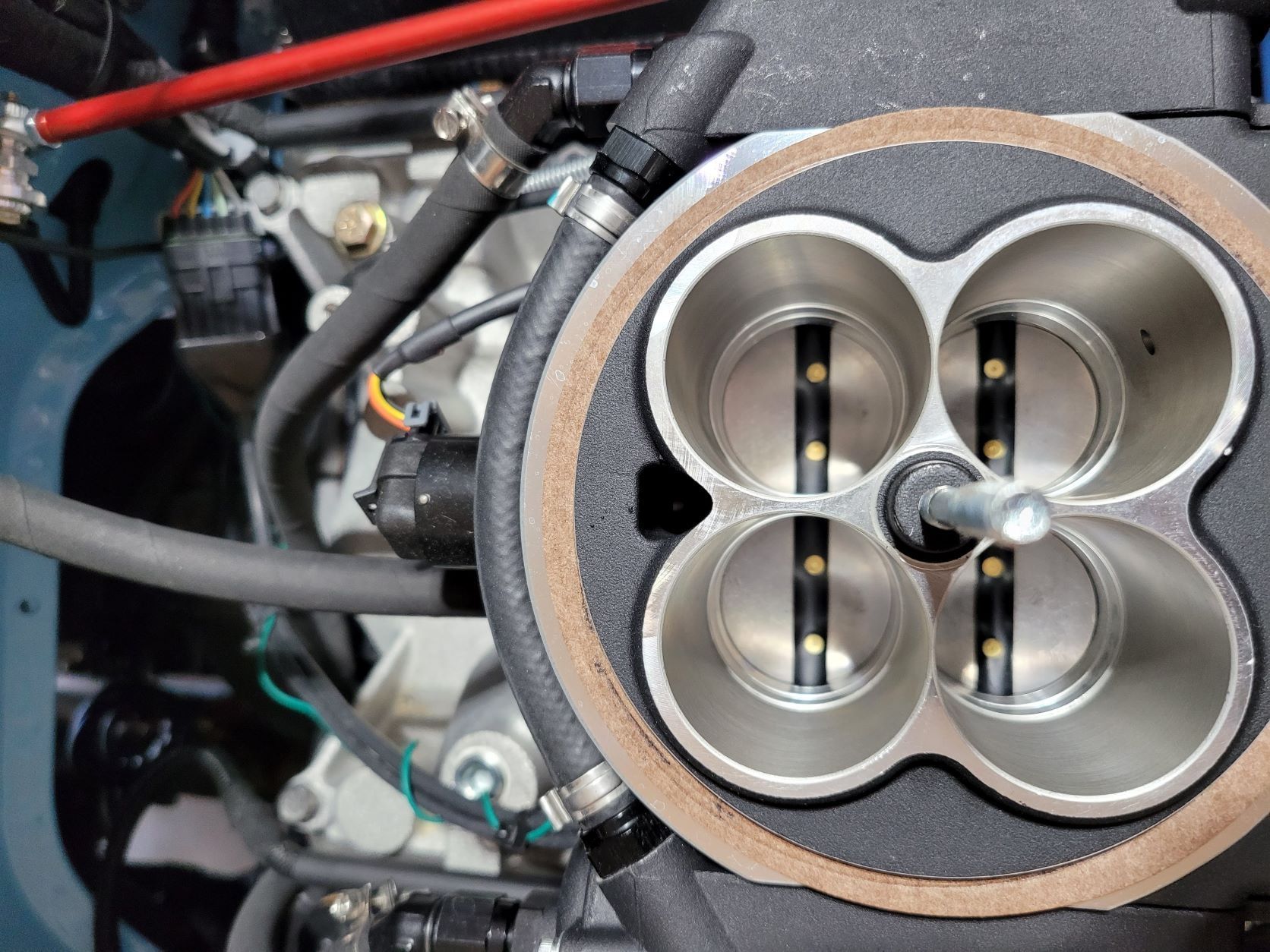

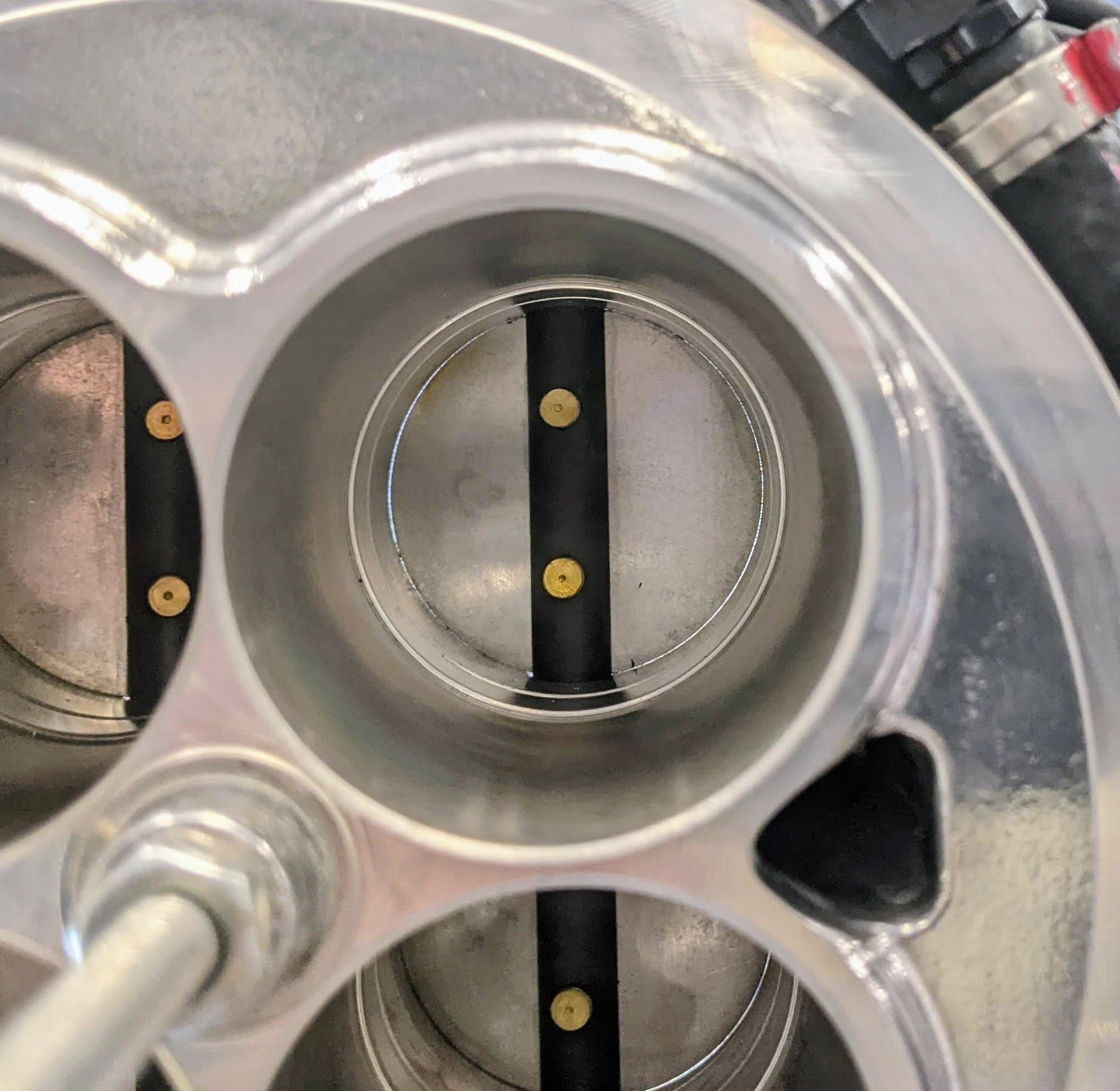

How do mine look – before and after pics of the adjusted two secondaries below?

I adjusted the plates. The pics below are before and after of the secondaries. I also adjust the primaries – they were about as bad.
After this adjustment, with the curb idle screw completely out (plates fully closed), the Sniper can almost hold idle at my set point of 750 RPM. It wavers between 740 and 810.
So my conclusion is the vacuum leak is the poor fitting throttle plates. I think I need a better seal, so that I can actually use the curb idle screw to open the primaries a bit, and get into a controllable zone.

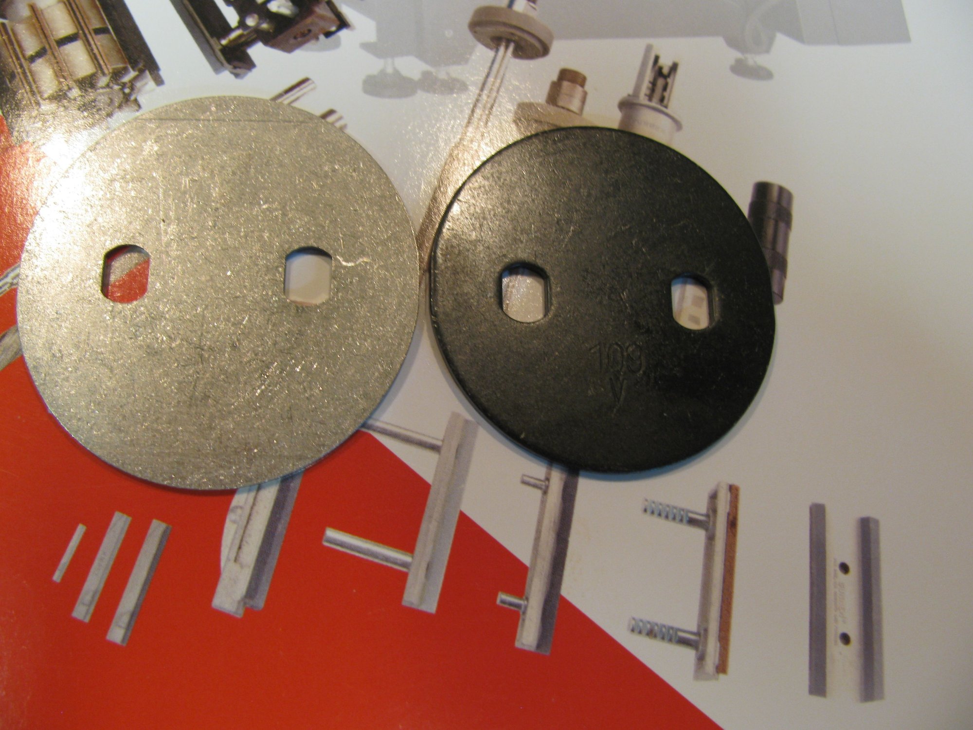

I've never used a throttle body injector. But the throttle plates are the same as a carburetor. They should close completely when adjusted to fully closed. They look like this picture with slots where the screws go so, they can be adjusted for a tight fit something Holley should have done before they shipped it. If you mess with them, you absolutely need new screws the screws are not reusable. Once the plates are where they need to be you crimp the screws with big pair of needle nose vice grips being very careful not to bend the shaft.

The one in my pic on the left is a 354V, 1 11/16 throttle plate. Quick Fuel 9-172QFT Steel 1 11/16" Throttle Plates (4 Pack) 9-172 (holley.com)
The screws are available separately. I would not recommend trying to reuse those screws. They are soft brass and if you break the head off or it cracks and falls off later, not good.
