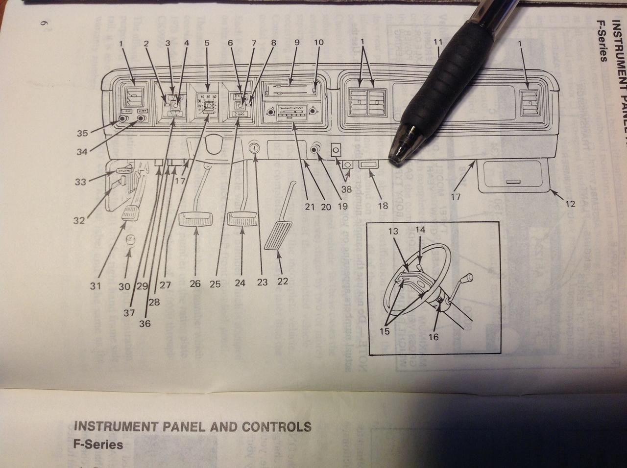

Hello,
I recently bough a 1978 and half F150. At first I though someone put auto hubs on but I did a Marti report and it has Full time 4x4? I guess until now I did not know this was even a option back then. So I am wondering if someone can shed some light on the operation and such. Also the past owner put a 8 ball **** on shifter so I am not even sure of were the lever needs to be. I have tried shifting it and it seams to do nothing even with the trans in neutral but still does nothing, and indicator light does not light up. Any info would be greatly appreciated thank you

Here you go.
So you have the blue legend lens 4wd indicator that is #18?

Lots of them were converted to part time. . does it have hubs ?
The light only comes on in the lock position, and it may not be working.
