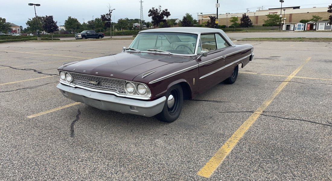

So as some of you may have gathered, I have a 63 galaxie with a 351 Cleveland in it. The motor may be on its last leg. I’ve been thinking about putting a 300ci 4.9l I6 from an f150 in it.
A: is that just stupid, or what? Any opinions?
and B: would it fit/ mate to the c6 Tranny in there now. Thanks!
