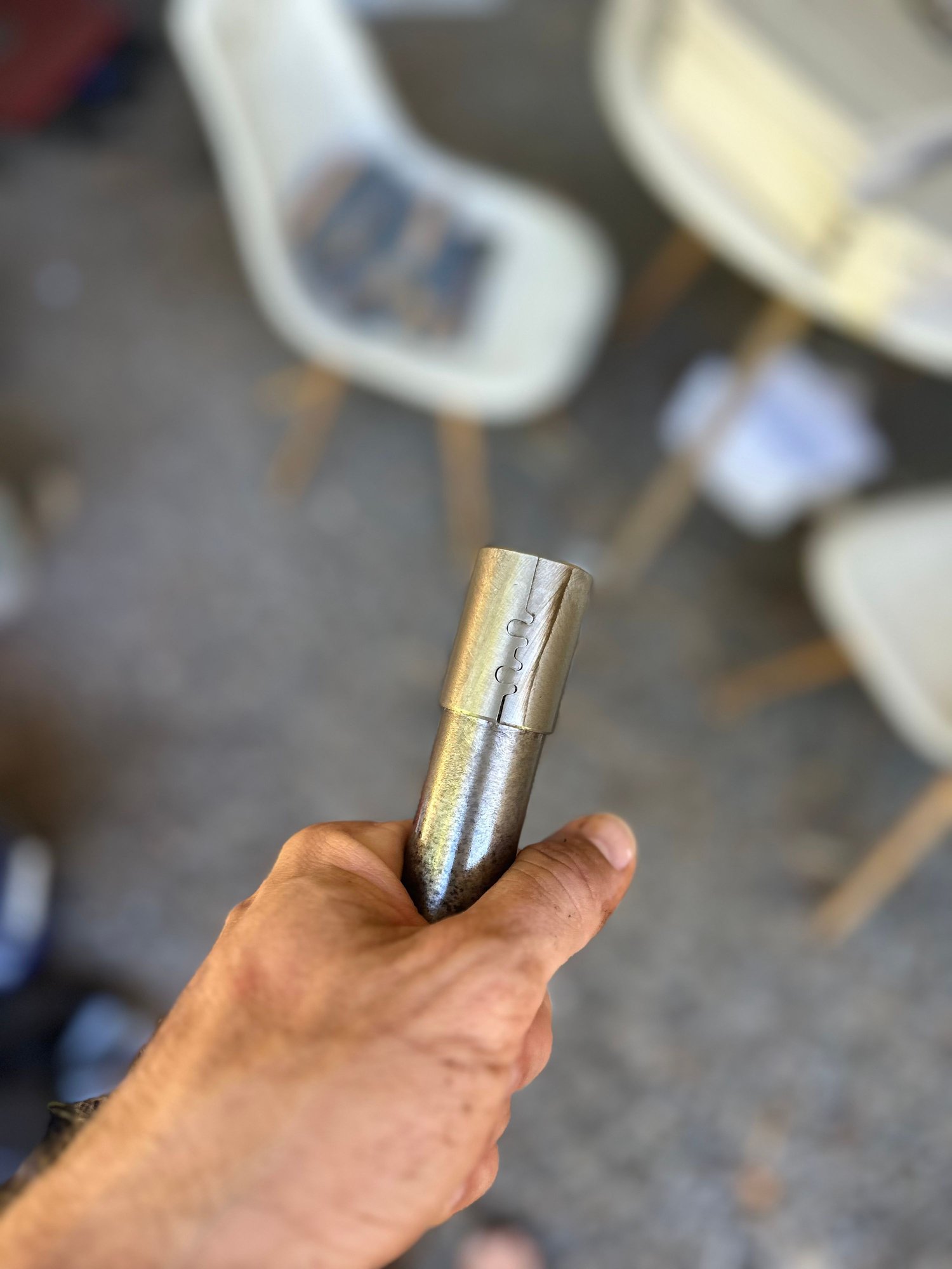

Finally found someone who can help with the king pins, the set I had sat for a while and got surface rusty (I’m on Maui so the humidity is unavoidable here). I cleaned off the surface rust with some WD-40 and a wire brush. When I attempt to lightly tap the collar (not sure it’s actual name) on to the king pin, I notice it starts to open up at the seam (see attached photo) is this normal or will I need to ream out the collar?

that does not look rite to me.
you want it tight, but that looks too tight
