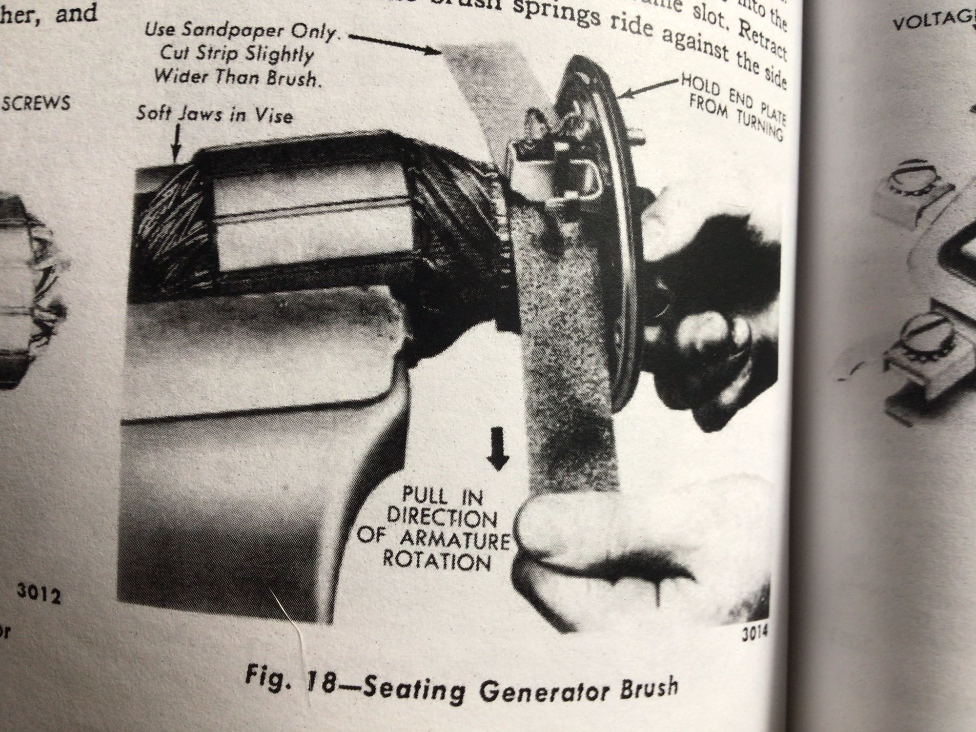

I had a similar issue, we had to push start after going out to dinner one night and barely got home on what was left in the battery.
I replaced the brushes and followed the seating procedure in the maintenance manual. I also took my generator and regulator to a shop where they adjusted the regulator and tested the generator.
This is from the maintenance manual…
