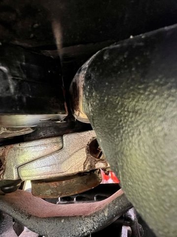

I have an issue with mine that led to me selling the truck and now looking for a long bed. The wedge made for the Curt A20 does not fit all the way tight into the plate which causes side movement at the pin which in turn moves the trailer nose right and left as the wind blows, or making turns. Has anyone else encountered this and found a fix? There were other reasons to sell the truck, not just the short bed, but if for some reason find a really good deal on a really good truck that happens to be a short bed, I would want the sidewinder to do it's job properly. Has not since the day I got it. If I take the head off the hitch and lock it to the pinbox, I can move it at least 1/4" against the wedge and it is as far as it can go.

I took a bunch of pictures of the wedge that is supposed to be the one for the Curt A20, installed both ways, sent them to Reese support and have not heard a thing back from them. Doesn't matter at this point, I sold the truck last Friday, more than just the short bed, it was deleted when I bought it from the dealer, and that left me feeling a little concerned with the EPA now starting to target private owners, so sold it back to the dealer I got it from. I was planning to replace the truck anyway back in February when I ordered one, but I wound up finding a nice F-450 instead, so going to put the original pinbox back on and toss the Sidewinder on Ebay. It is tight on the pin, no slop in it at all, but can move it side to side quite a bit.
